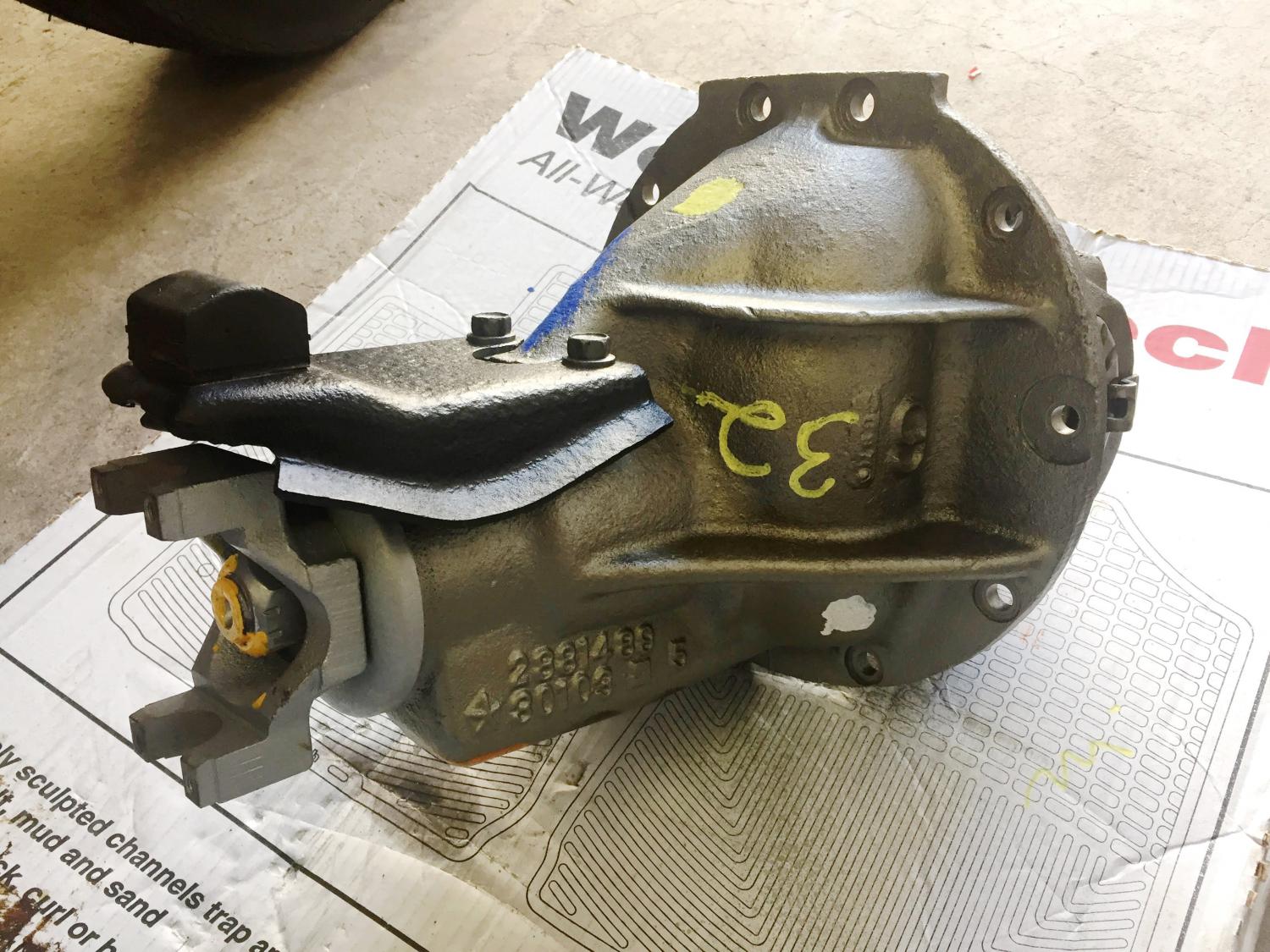

The Powr-Lok Sure Grip unit and parts arrived from Dr. Diff on Tuesday afternoon and I then dropped them off at Bontempo Brothers Competition in Linden, NJ. If you ever get a chance to stop in there, it is like a time warp trip to 1970. It is an old time speed shop with all four walls covered in NOS and used speed parts. VERY COOL! The back garage and warehouse has racks of engine blocks, heads, rear end parts, transmissions, etc. It's just amazing.
I dropped off the parts and the center section and axles. They disassembled, hot tanked, and reassembled everything in less than two days. Total labor was around $400.
Once I repaint the case and add the inspection marks, I will throw it all back in this weekend. Just waiting for the axle tube seals to arrive.
(The little white specs are styrofoam from the box I brought it home in. So I will be cleaning those off before installation, of course).

I got the paint marks done and managed to manhandle the carrier into place in the housing today. Unfortunately the transmission jack I used to remove the carrier was not too helpful for installing since there was no way to load the carrier onto it and then lift it, since the jack saddle is already about 8" off the ground and won't clear the underside with the carrier sitting on it. So, I had to use the low profile floor jack and over-head lift the carrier while on my back so the flange was on the saddle and then jack it a couple times so I could wiggle it into a balanced positionon top of the jack. Luckily the exhaust was something of a safety barrier to prevent the carrier from falling left or right (onto me).
Got it up in place and bolted up and then had to adjust the axle freeplay on an 8-3/4 rear. It calls for a range between .008 to .018, measured from the left side. To get your correct play, you then adjust the spinning flange on the right side and bolt the keeper in place under one of the flange bolts in order to permanently fix the clearance.
It then took about an hour to pump in two quarts of traditional 85W-140 and a little bottle of Ford friction modifier, (that came with the posi unit). Nothing like trying to hand pump semi-solid, 35-degree gear oil. (Yeah, I should have heated it up in the house overnight). DOH!
