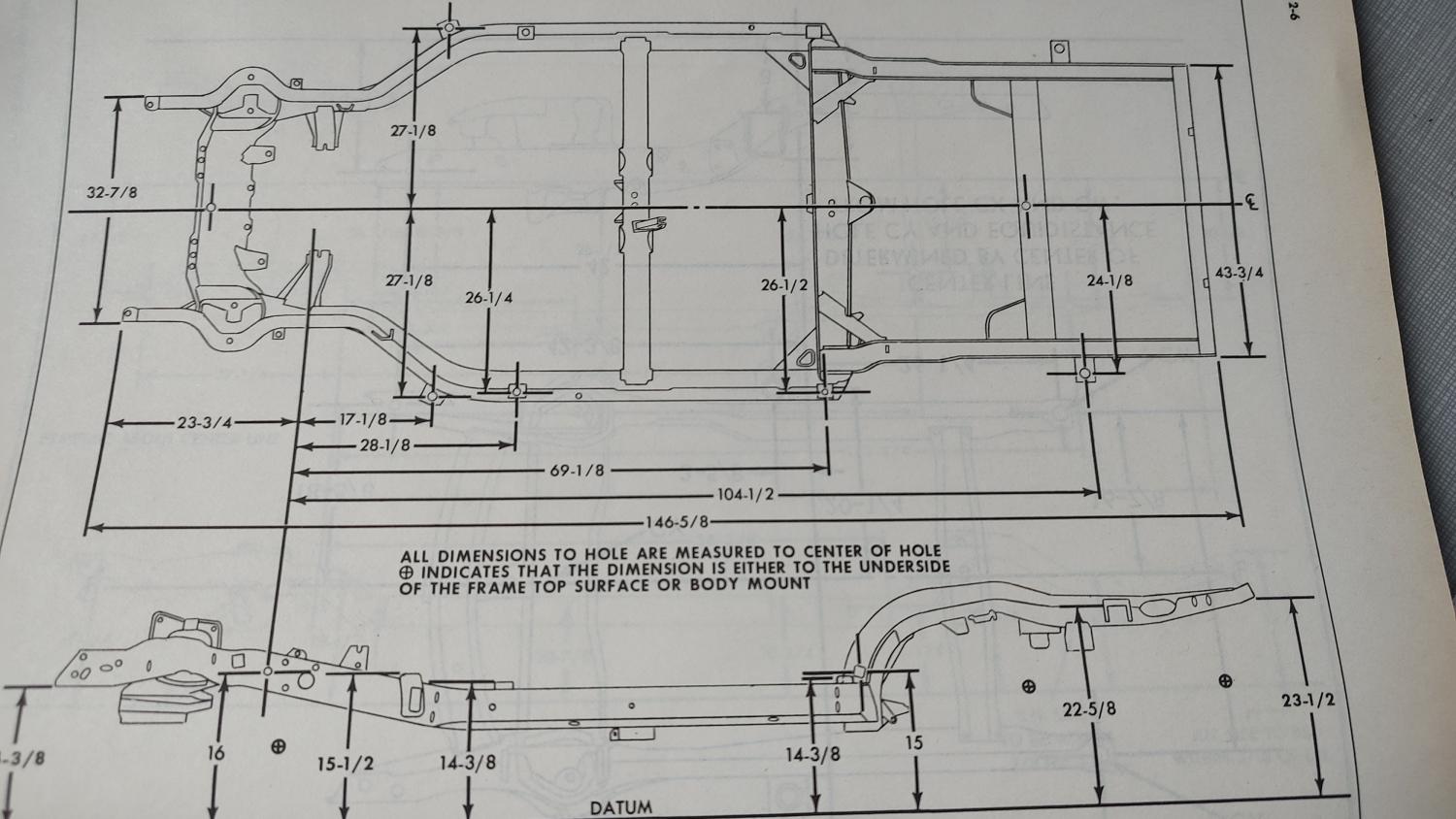

Mitch said:
"Originally Posted by Too Many Projects View Post
Wondering where a clean frame could have come from unless a totaled car ? Have you had the replacement frame checked for square and plumb on a frame rack ?"
Hey Mitch: Given that I don't have a perfectly flat surface in my shop, are you aware of a procedure I could follow to insure my "new" frame isn't twisted? Even an 1/8 of an inch could cause me problems. I have it stripped down to nothing, and put casters on it so I could move it around the shop. Before I spend time and money making it look perfect, it would give me a lot of peace of mind to know it is true in every direction.
Any suggestions?
  #39
Old 04-30-2024, 02:46 PM
napa68's Avatar
napa68 napa68 is offline
Join Date: Oct 2008
Location: Presque Isle, WI
Posts: 3,273
Thanks: 4,459
Thanked 3,203 Times in 924 Posts
Lynn,
Do you have the 70 Chassis Service Manual? It has the frame datum in there. Regardless, you will need a perfectly level surface (preferably a surface plate or a frame machine)
Tim
The Following 2 Users Say Thank You to napa68 For This Useful Post:
dykstra (05-01-2024), RPOLS3 (04-30-2024)
  #40
Old 04-30-2024, 03:27 PM
Too Many Projects's Avatar
Join Date: Oct 2020
Location: Town of Troy, WI
Posts: 4,190
Thanks: 2,182
Thanked 3,067 Times in 1,414 Posts
You previously said you had measured diagonally in different locations and distances and they were all "square", which would be a very good indicator that the frame doesn't have a diamond. This can be done as a rolling chassis even without it being on a perfectly flat surface.
Twist, is the only other concern and that would need to be done on a flat surface and measured from that surface to the reference marks in Tim's pic of the side view.
Knowing it measures square, I would feel fairly comfortable that the frame doesn't have a twist, or if it does, it's so slight, that it isn't going to make a difference.
If you want a little assurance, I would block and shim the frame under the front and rear corners of the horizontal rails until they are level, front to back and side to side. Then you can use a level on the front horns, rear boxed enclosure and a short torpedo level on the front crossmember to judge if they are twisted.
No frame is perfect, hence the need to shim the body to fit the frame on a Corvette.
The ONLY way to know 100%, is to take it to a reputable frame shop, with a printout of the specs, and have them check it. You could do this after it is assembled to roller status and it may easier to transport that way.
Mitch
1970 Chevelle SS
1966 Chevelle SS
1967 Camaro ss/rs
