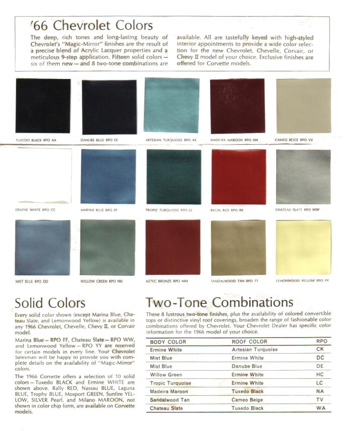

<div class="ubbcode-block"><div class="ubbcode-header">Originally Posted By: CamarosRus</div><div class="ubbcode-body">Mr70/Rick, Is not the Chevelle above painted CORTEZ SILVER ????
</div></div>
Cortez Silver was not an available color in 66 from what I know but Chateau Slate was, color code &quot;W&quot;.

Default Re: 1966 Chateau Slate L78 Chevelle
It looks like it Chuck,but it's really Chateau Slate.
2nd row,last on the right.
This has always been one of my favorite colors on a '66.Incredible find Rick B. [img]<<GRAEMLIN_URL>>/burnout.gif[/img]
