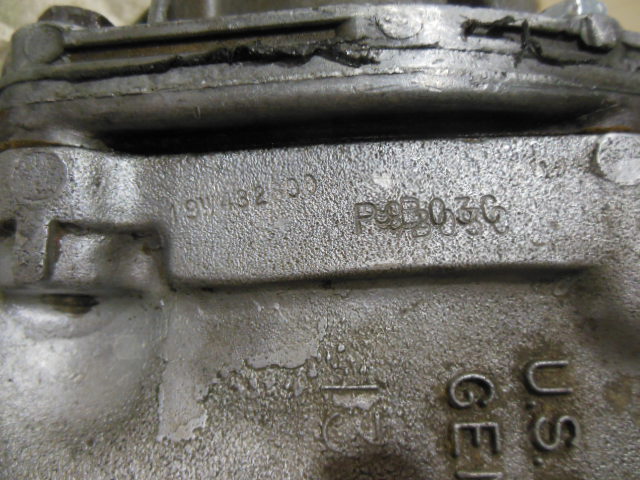

picked this up from a guy said it came out of hid big block nova years ago looks like a m 22 to me the numbers are double stamped P9B03C and the vin is 19W432890 does the stamping look correct

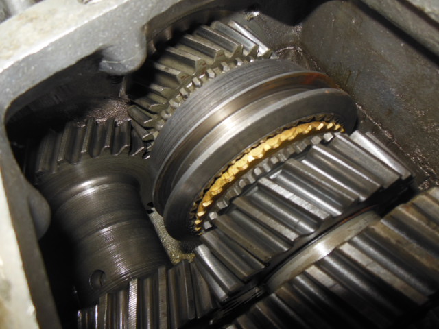

Definitely out of a Nova, has a W (Willow Run) in the VIN stamp, rare piece, looks like a legit double stamp to me, are those 22 "straighter cut" gears.? Experts can chime in

I'm no expert but would say yes to the straight cut M22 gear set.

Cant remember the last time if ever I saw a straight top 3 .
