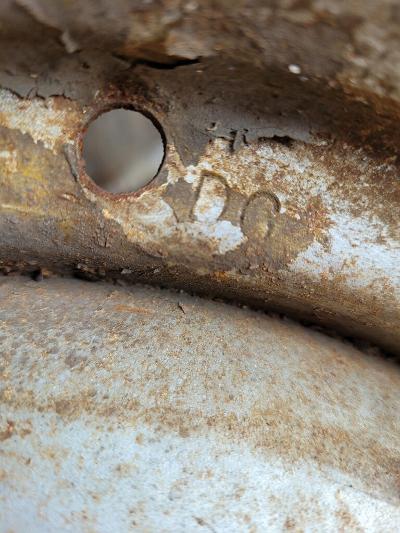

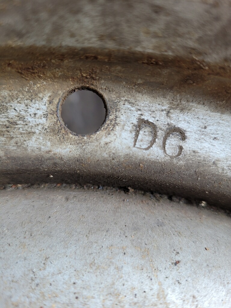

Need the experts opinions here. Ran across these Rally wheels and I know they made both a DC and DG coded wheel at some point. Does the stamp look more like a DG.? Any help appreciated

I think this is an easy answer.
DG is a 14
DC is a 15
ThanX
Brian
DG is a 14
DC is a 15
ThanX
Brian
Respectfully, I will dissent with this opinion. I understand that in 1967, 15X6 Corvette rally wheels were usually coded DC but that there exists some coded DG (I've had a few myself) - the 14" DG are of a small font and show the other typical stampings by the valve stem - date et cetera - those were full size / wagon rims as I understand it (I have some of these too). The so-called large DG stampings do not have any other stampings by the valve stem hole and are 15X6 - check inside the wheel hoop, you'll see the other markings in addition to "15X6".
That said, the ones shown in the OP are likely 15" and 1967 Corvette rims and I think they're DG based on my experience.
Hope this helps.

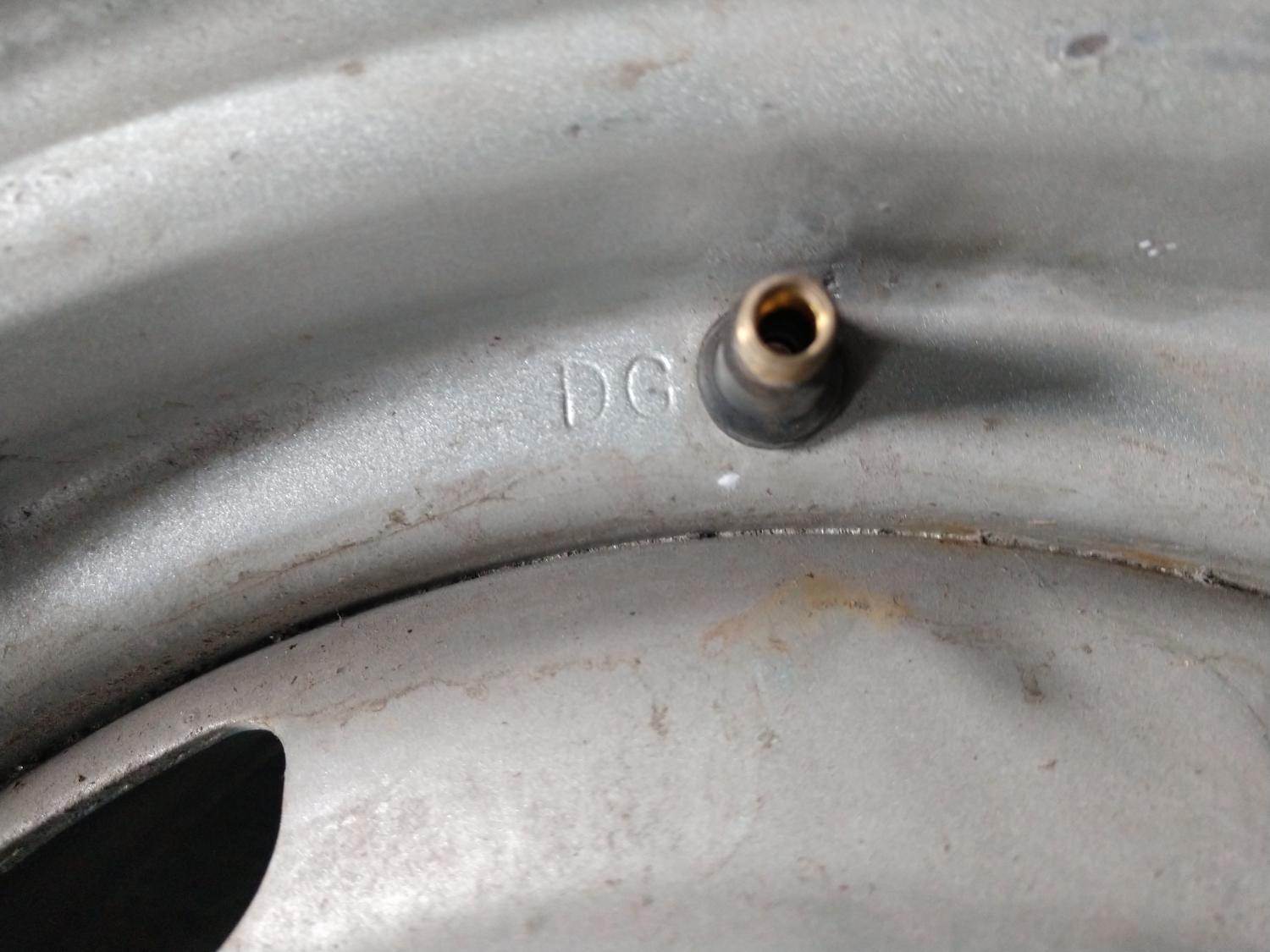

Here's a real 67 14 inch stamped wheel. No other markings.

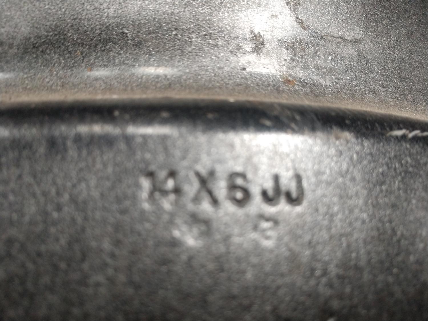

14 x 6

Hey Jim, those look like DG but the stamp was off. DC would be much more abrupt at the lowest side of the C stem
