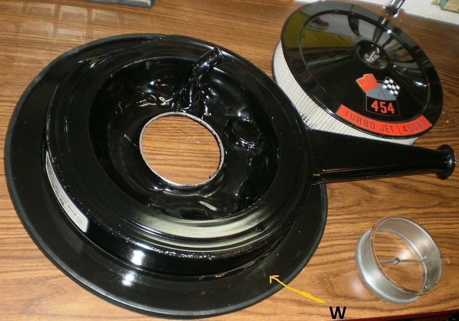

Makers mark &quot;W&quot; stamped into originals too.

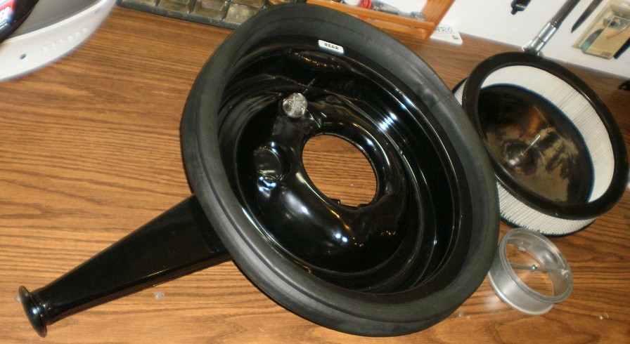

Here's a reproduction I recently sold..
https://www.yenko.net/ubbthreads/ubbthrea...true#Post475497
Notice C H Q reproduction stamping.
PCV Vent tube isn't as curved as the originals were and doesn't come out as smooth as the 1st design assembly line did.
Also originals have a notch in their center seam on the air horn.
The rippling in the back on an original is more defined &amp; detailed then a repro.today,as well as the whole design overall.

I Had this on file off my original LS6 70 Chevelle.
Hope it helps.

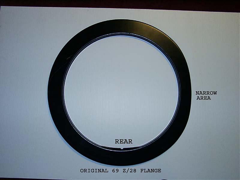

69 Camaro flange looks like this.
John Brown
Old 03-20-2012, 02:52 AM
Posts: 20,899
Default Re: Cowl induction air cleaner - original or repo
Oops,yes,you guys are right.I shouldn't have said perfect circle.
Just meant to infer it's more symmetrical then the A/C allowable one below.
I seen the egg shaped design is being repopped today too.
