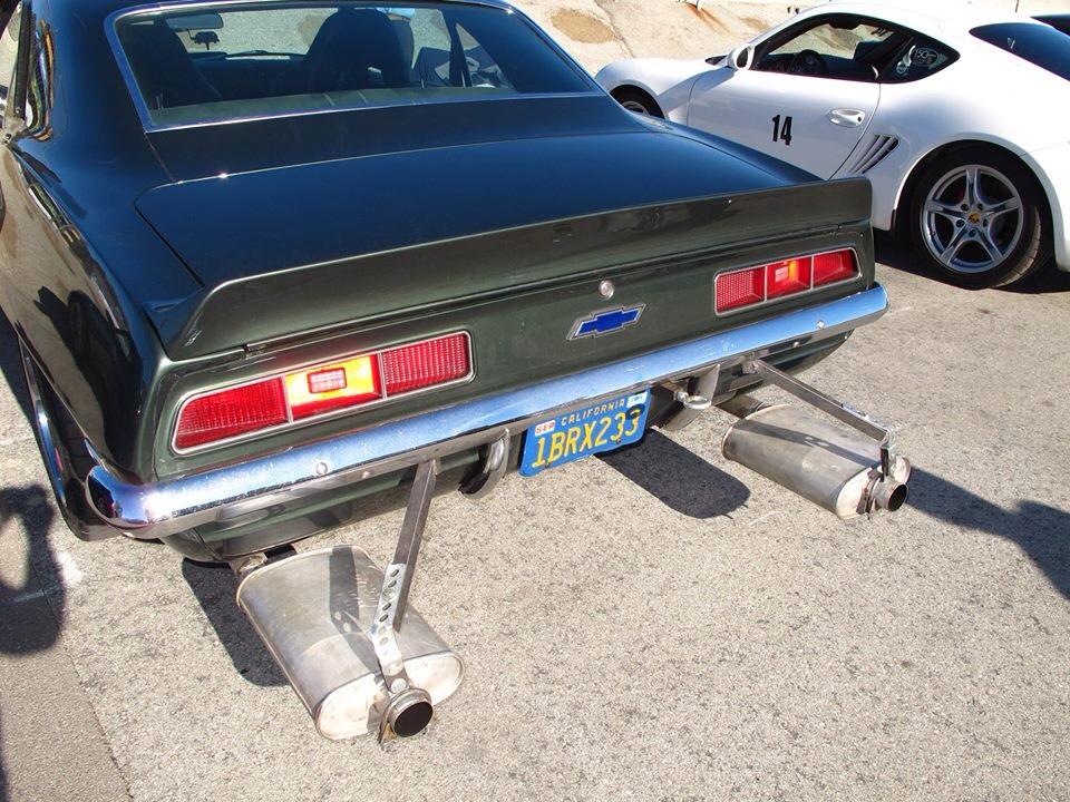

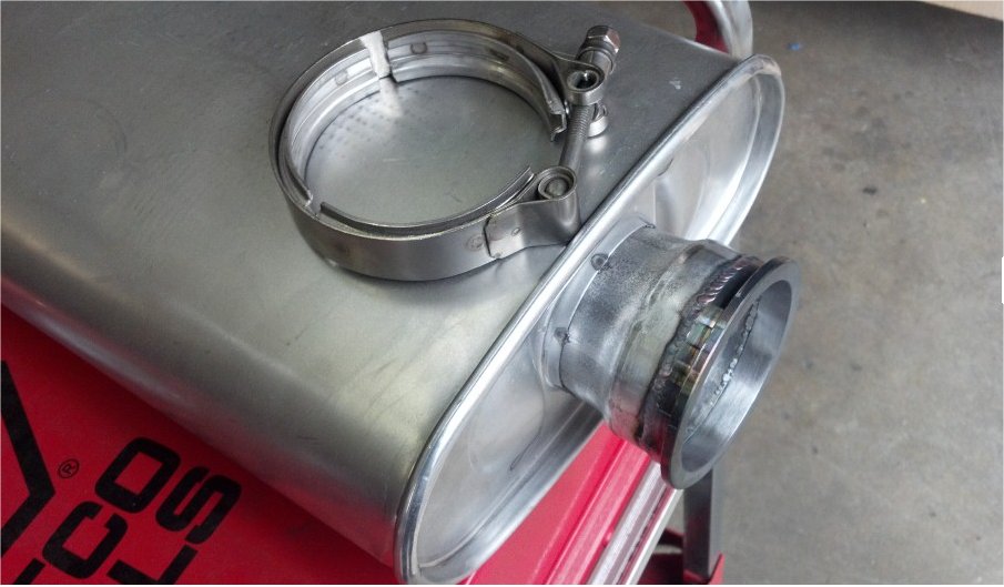

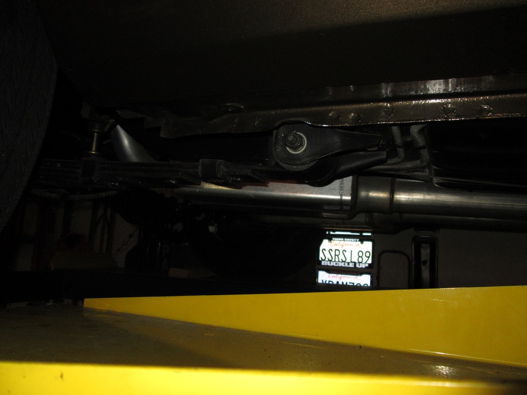

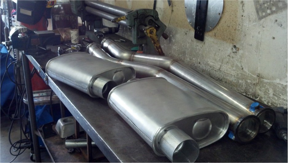

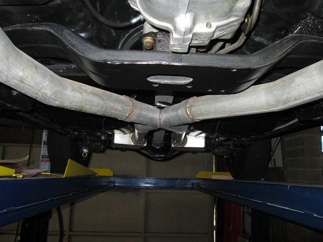

I just bought a 1969 SS350 Nova with the most perfectly done 2.5 dual exhaust system I have seen. The problem is at idle the sound from the mufflers resonates through out the interior and you can not hear anything else including the engine idle. I am not sure of the manufacture of the two mufflers but they are square with a diamond plate case. I usually run a Flowmaster crossover muffler with 2.5 exhaust and I wanted to try the Pypes crossover system in the future but I would hate to change over this complete exhaust system just because I need a different mufflers. Does anybody have any suggestions?

I would love to see pics of this nice system. What do the tailpipes look like?

An X or H pipe does wonders in eliminating exhaust drone, also quiets things down a bit.

Not sure if it has Flowmaster mufflers on it but it does have an X-pipe and the tail pipes end at the quarter panels where you do not see them.

I would bet the mufflers are Spintech. I have no experience with them. With full tail pipes and the crossover, I would say your instincts on a muffler change is right. Any true turbo muffler would be better.

Yeah, those look like Spintech mufflers. I'm surprised they have a drone, but I've never tried them. I actually ran the Summit turbo mufflers on my old 1970 L78 Camaro and you could talk to people in the car and it had the classic musclecar rumble and that was with a full 3&quot; dual exhaust.
