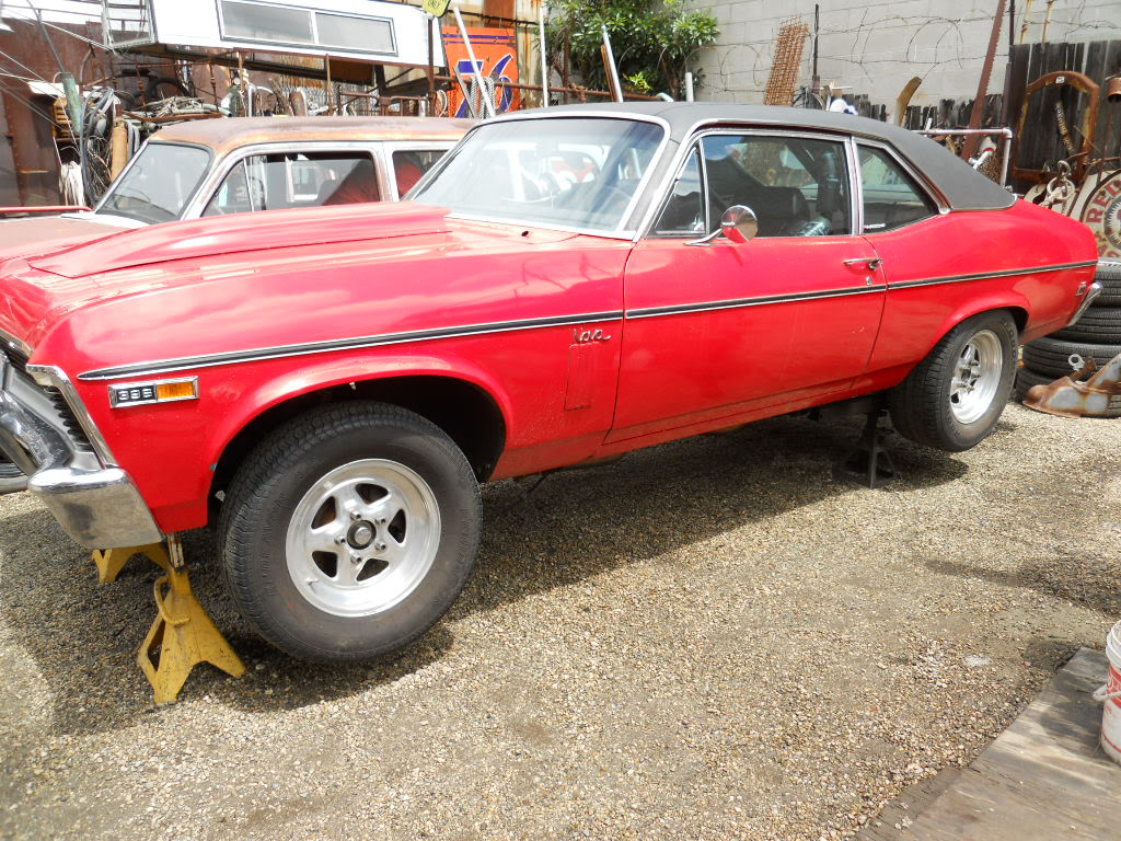

Default 1969 Camaro RS LM1?
I picked up a few cars and one of them is a 1969 Camaro RS, I suspect it being an LM1 but am not positive, it has the born with 350-4bbl suffix code HR 255hp/PG, it also has a 12 bolt with 5-multi-leafs, PD front brakes, and is pretty loaded with AC and PW.
Build date is 10C
Reason that I am asking is that I don't believe I have ever run across a PG car with a 12-bolt, and I want to get it right before I advertise it for sale.
Thank you
