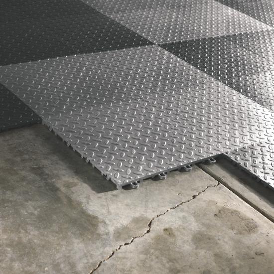

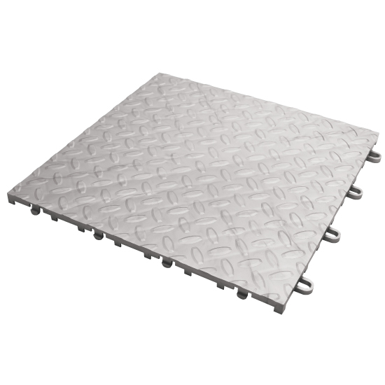

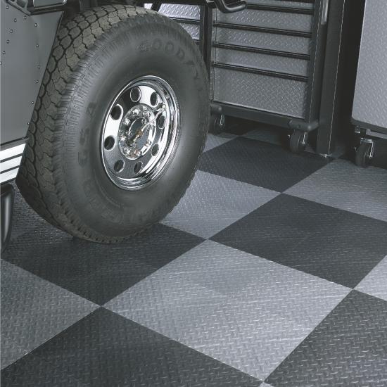

I have epoxy painted flooring in AZ and love it. It has held up well after 10 yrs. In AZ there are no worries for excess moisture in the concrete and the dry air is conducive to good epoxy adhesion. Not so much out here in OH, though. So I got to thinking about alternatives and wanted to get opinions of what has worked for you or if you have tried something similar to the Gladiator tile below what your opinion is. Price is about the same for epoxy and these tiles so that is not a factor. I will be (attempting) to place a 4 post lift in my garage so flooring able to support that is a must.

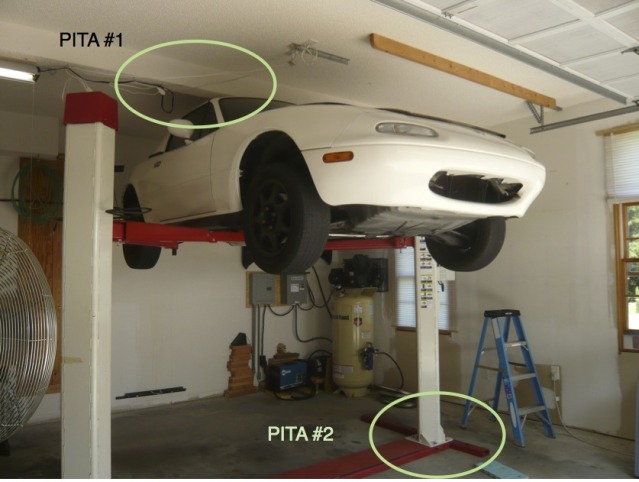

I've seen some clever floor plate 2 post lifts installs. Sone are only 9' tall. Might be more like whay you are used to. Plus you gain room since the area under the car doesn't have that lifting platform.

http://www.garagejournal.com/forum/s...d.php?t=164327
base plate or floor plate. There is one in this thread. Sorry no pic here right now.

Typically 4&quot; of 3000psi concrete is a minimum. Some lifts like Mohawk do everything in an overkill kind of way. You probably should see what the lifts you may consider have for recommendations.
That extended angle iron in pita2 could be added to most lift and i probably would. As long as you rest on the locks, i would store a car this way. Check min lock heights.
Cool part is you cheat space a bit cause wheels above can hang below the roof line of the car below.

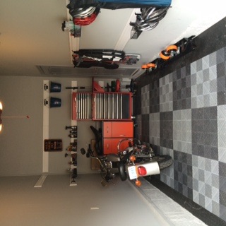

Hey Sam...I have Race Deck flooring and a 4 post lift and there is no problem with that set-up at all. I am adding a second 4 post lift this summer.
If you are a garage journal member, call Race Deck and tell them and they wlll give you a 10% discount and free shipping [img]<<GRAEMLIN_URL>>/smile.gif[/img]
