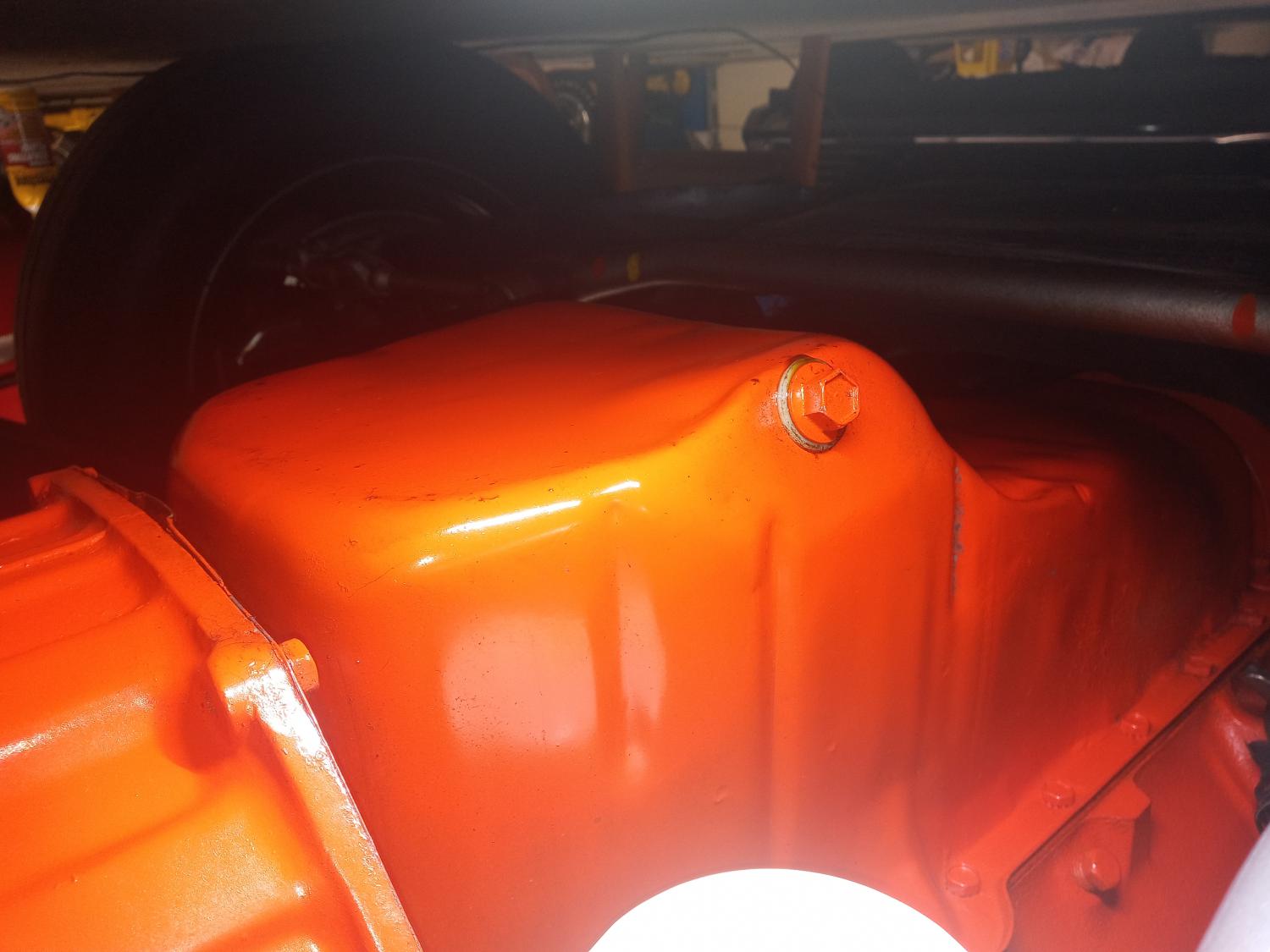

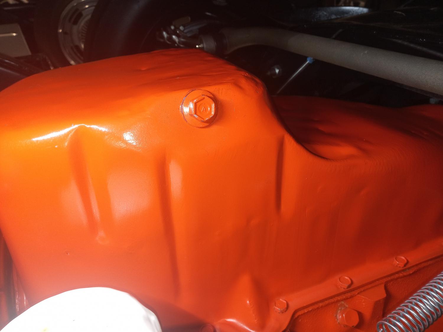

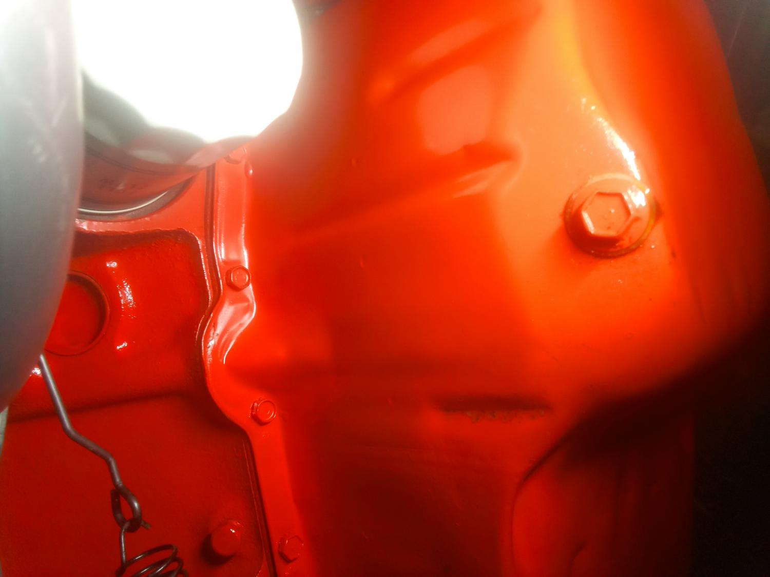

Friend of mine called and asked if I knew what the difference would be in a 69Z oil pan - vs. a 1970? Seems his sept of 69Z has a 70 oil pan?
Any insight as to the differences - or would a late 69 have a 70 pan, similar to other late 69-70 transition parts?
Appreciate your insight on this....

Guessing my first question is:
Are we certain that 69 and 70 Z/28 used different oil pans?
Would like to see pics of each to compare.
I do have a 1970 LT-1, but it is a Corvette, so the pan is MUCH different from the Camaro.

that would be great - his car is a 9C - late 69 car.....
pics would help - to understand the assembly line correct version etc......
