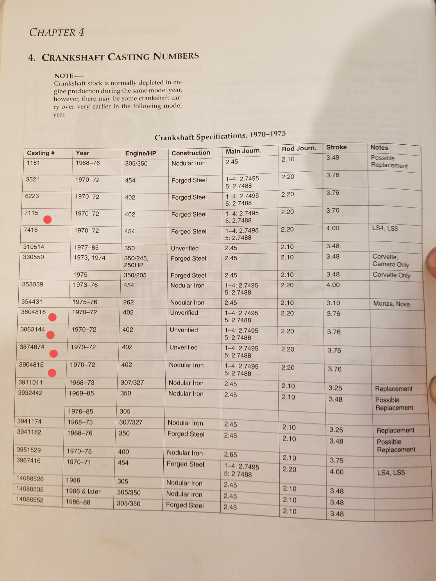

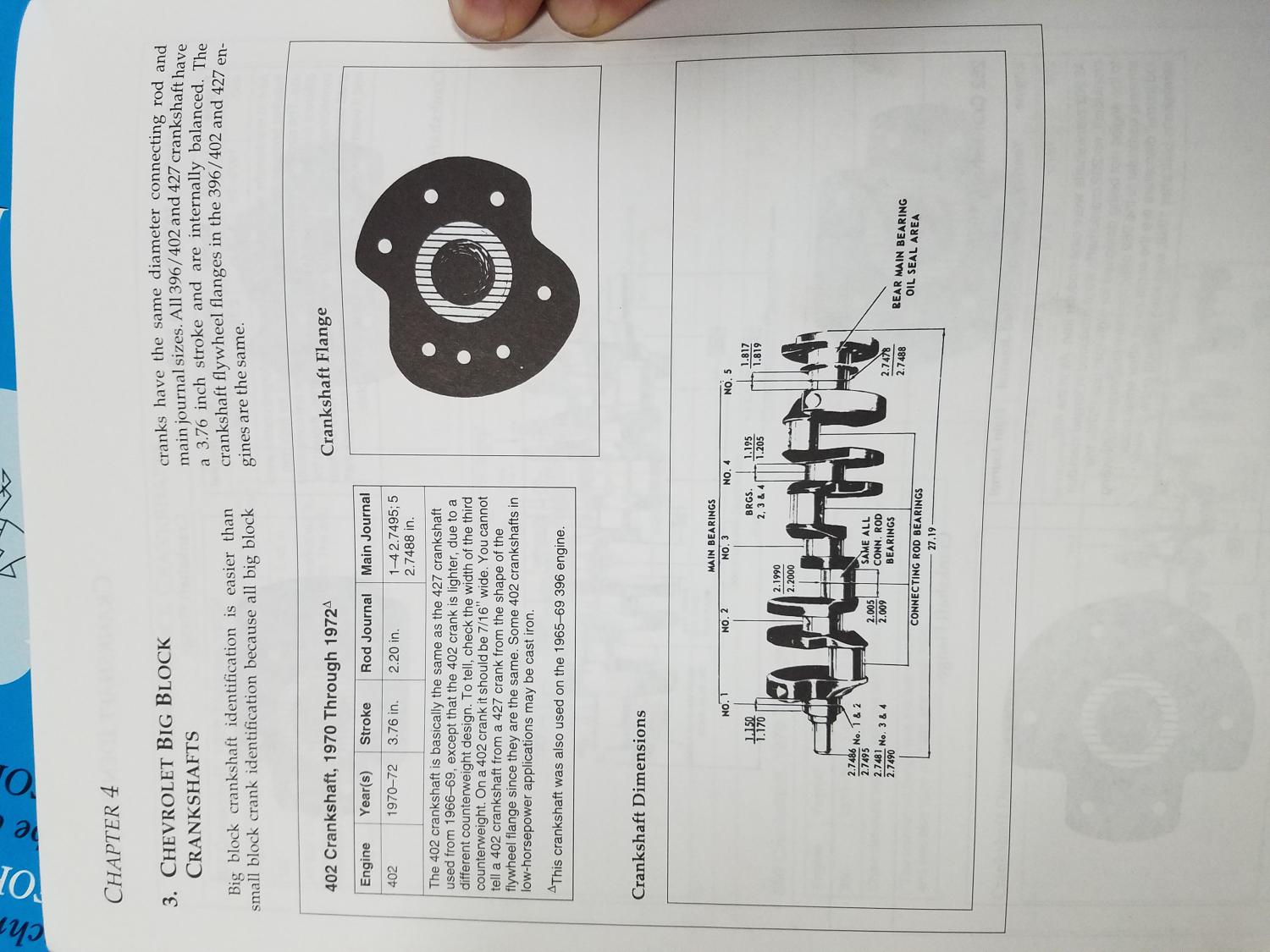

What more can you tell me about the L-34?? I have Alan Colvins book and I saw a section on the 402/427 where it says the 402 3rd lobe is 7/16". Is this true?? I have a 70 SS Camaro L-34 and trying to verify what crank should be in the block, CTX stamping. Would it be the 6223? The only 6223 I have seen is 3/4" wide 3rd lobe.
Any info on these other 402 cast numbers mark with red dot?
Thanks!
