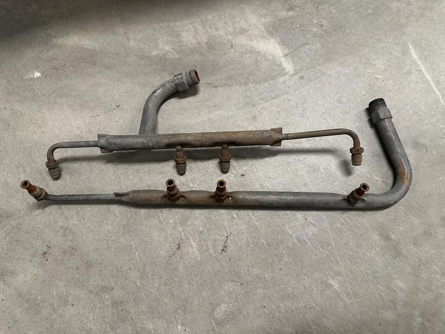

I would like to figure out what application the photo’d small block smog tubes fit. Any and all help is much appreciated.

Bottom tube looks like Camaro 69-72 small block applications. Top tube not sure.

Those are for 78-81 Z28's without A/C.

But they came attached to a 69 dated pump with original hoses and clamps. Hockey stick tube definitely applies to 69 Camaro. Just need to figure out exact application for top tube. Thanks for the response.

Was a Z28 the only small block to have a smog pump in 1969 or did California cars have them too?

SS with manual trans also got smog pumps.
I removed a smog set up from a 69 El Camino with 307 three on the tree. I do not know if ALL the manual trans small blocks got it. L48 small block definitely did.
Lots of good information here...Joe
http://www.camaros.org/emissions.shtml
