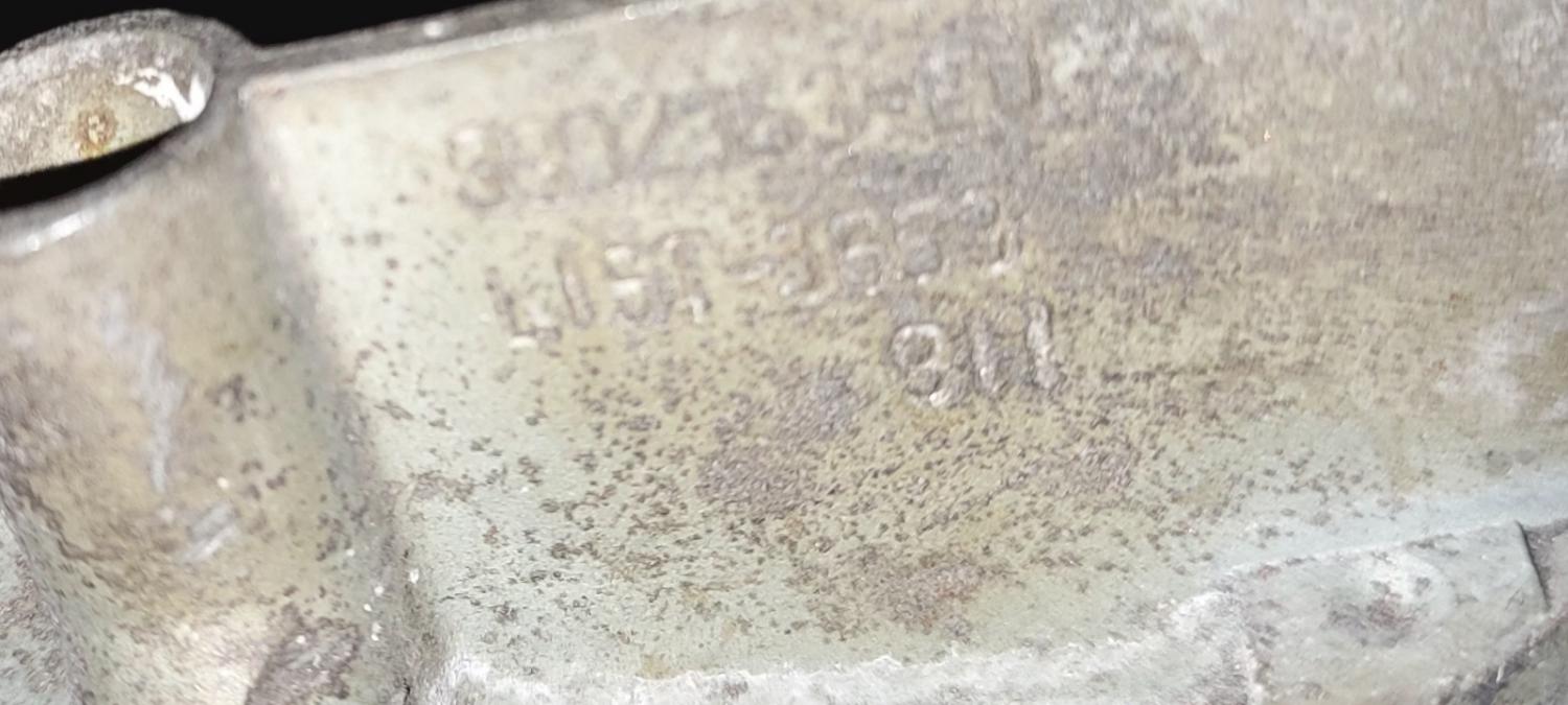

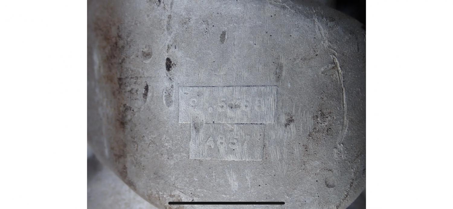

Where is the casting date located on a 69 vette 435 intake manifold? Is it under the bottom shield? Appreciate and help. The carburetors have a 69 date.
Attachments - The Supercar Registry Screenshot_20240522_222820_Gallery.jpg Screenshot_20240522_222713_Gallery.jpg IMG_5255.jpg IMG_5254.jpg

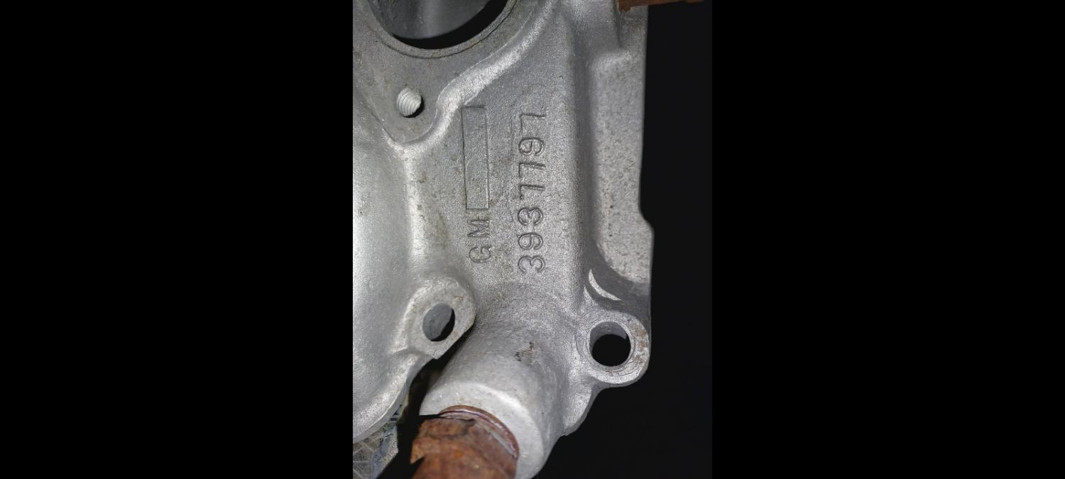

As stated above, it is under the splash/heat shield on the underside. Attached are a couple pictures as an example.
