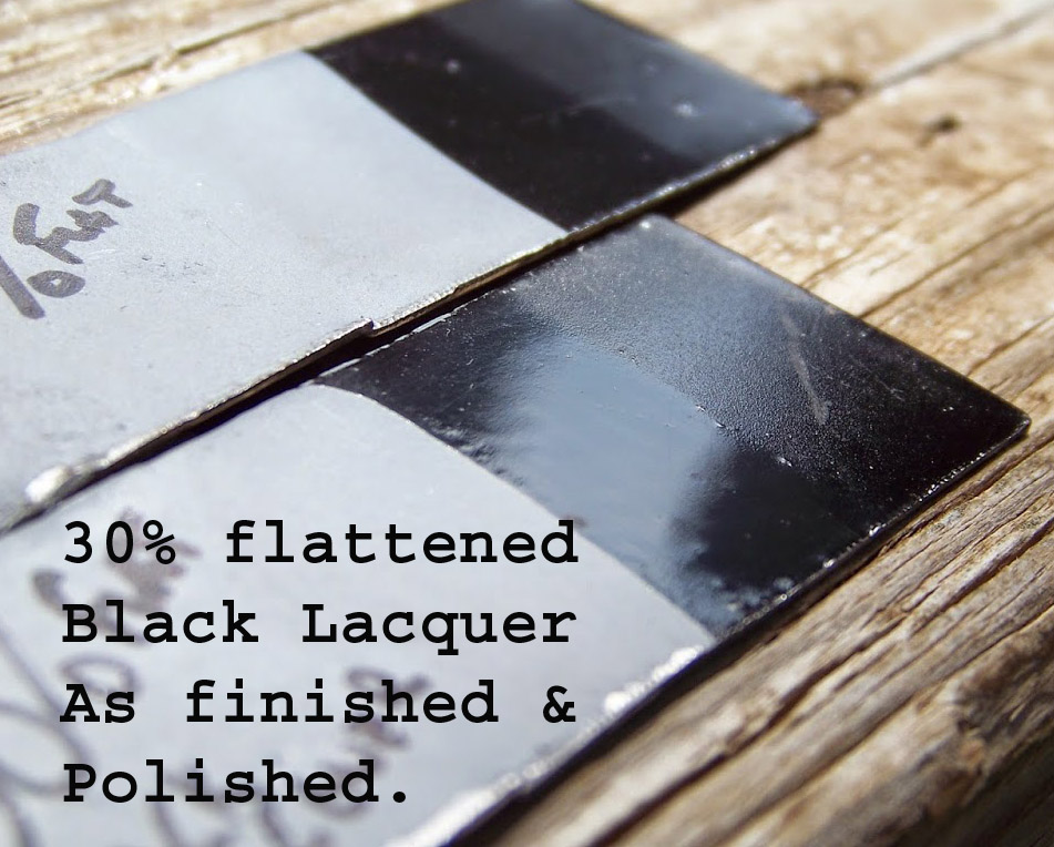

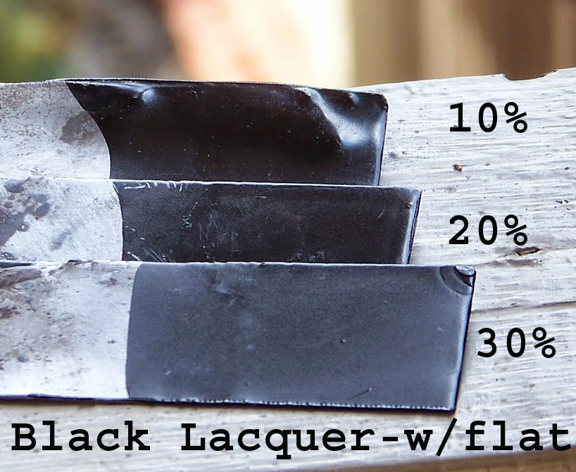

FWIW here are some samples of Black Lacquer I did in order to determine what happens upon polishing...
Catalyzed urethanes typically require quite a bit flattener to overcome the hardeners.
For Rockers and tail pans I use 4 oz black - 2 oz clear - 2 oz catalyst- 2 oz flattener.

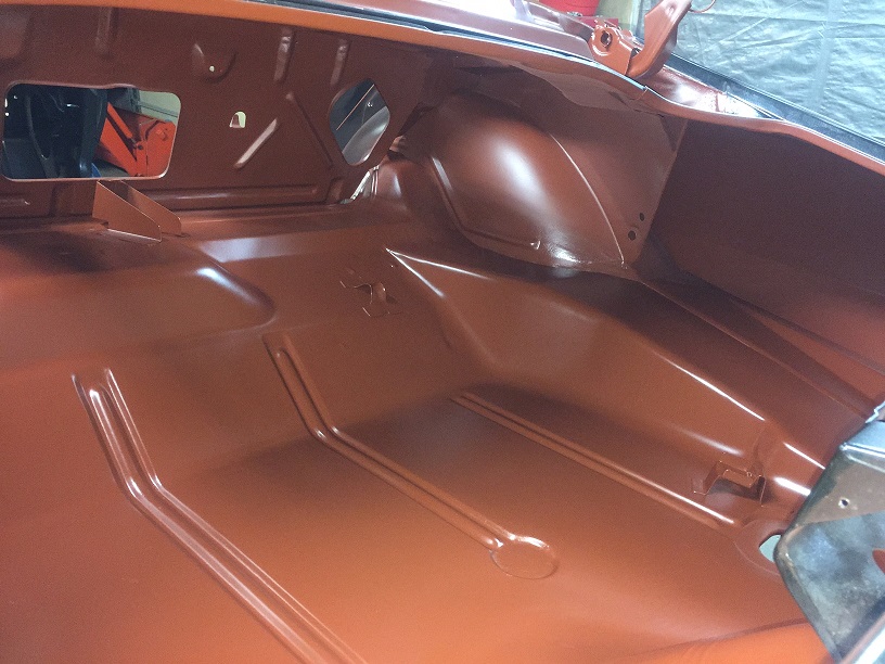

On the subject of the SPI epoxy, I spoke to Barry and have been working with his Epoxy for a couple of years on my 70Z project. Per Barry's advice and based on my own working experience, I get more consistent results in the gloss / flat appearance using the epoxy versus urethanes, whether they be clears or solids. For the black, I used anywhere between 3% and 8% by weight flattener before adding the hardener.
On a side note, to duplicate the 70 Norwood red oxide, I like 8% black and 5% flattener by weight added to SPI's red oxide epoxy (pre-hardener). I understand the red oxide appearance could change based on several factors, but based on original no-UV exposure panels I have, the above matches very well.

Steve, I dont comprehend your 8%, 5% etc.......
What brand/part number Flattner are you using ...I'm familiar with PPG DX-10.....
Are you using flattner because the SPI Red Oxide is too glossy as might be the
situation with the black.........

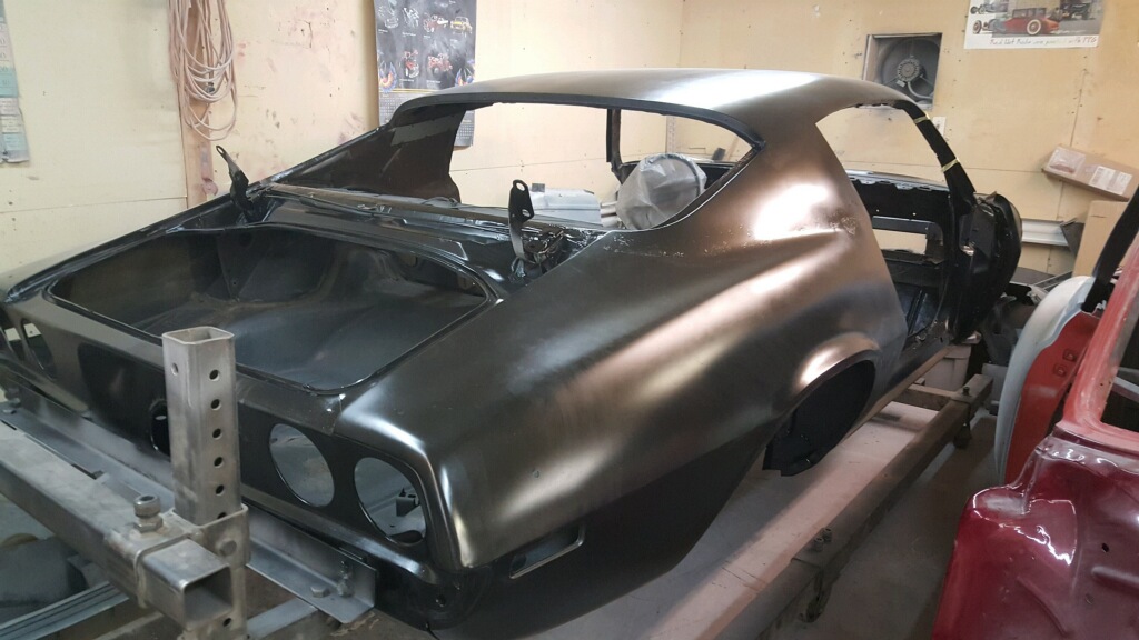

Below pic is SPI Epoxy on my 73 project which is NOT a restoration
Chuck Sharin

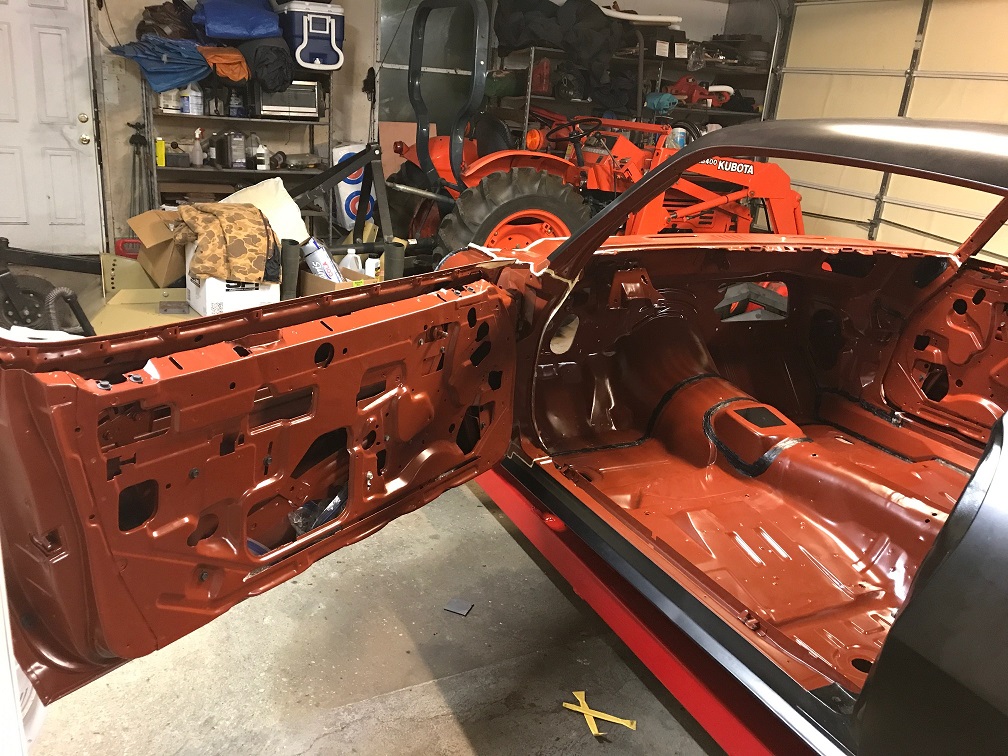

Chuck,
To the SPI red oxide, I adds 8% black, (weight of the red oxide x .08), then add 5% flattener (Red+Black weight x .05). All materials are SPI including their flattening agent #940-4....and yes, Barry approved using the flattening agent in the epoxy. Here's some pics of the red oxide results on my 70Z project:
https://www.yenko.net/foruhttp://www....1&d=1504883799
