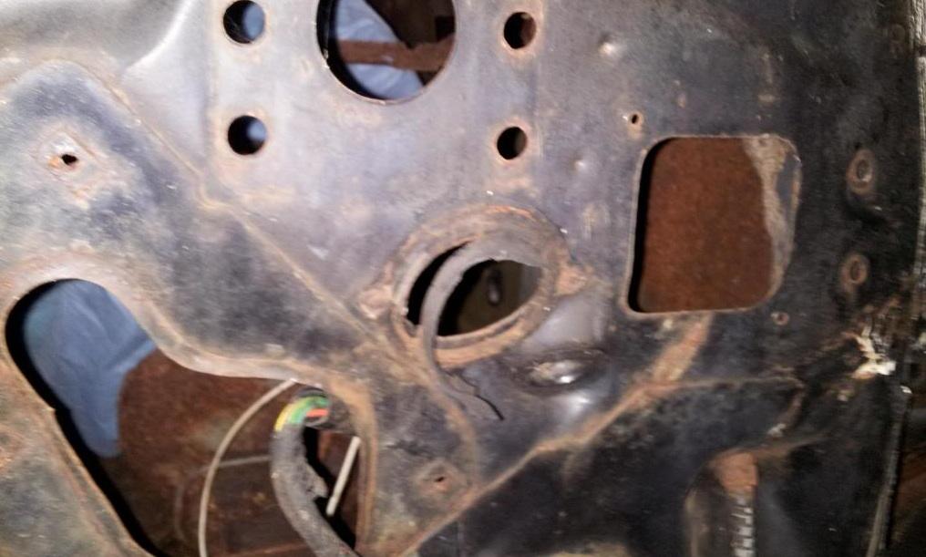

Is there anything in this arrangement of holes (speedo cable?) and protrusion of emergency brake cable that identifies this car as a '69 Z28?

not that i can see - -

No hole for ZL2.

did the flat hood cars have the ZL2 hole on the fire? If he pulled the back seat wouldn't the "X" designation be on the rear seat frame?

Los Angeles car, no X-codes.

I thought there was something in the positioning of the gas pedal exit in relation to the steering column holes. But I figured out thanks to CRG - you can I.D. a Muncie car, but not specifically a Z.

engine mount #s Z/s and SS350?? use same engine stand but not other SBCS also check length if pitman arm the Z's got fast ratio should be 5.8&quot; long for fast ratio
from David Pozzis site:
POWER LONG 5.8&quot;, 3953237

No hole for flat hood Z's.

The single 3/8&quot; fuel line, Muncie speedo hole are good signs but not 100% proof.

the firewall on my 69 Z28. It has a late build of November of 69. See the hole above the fuse box hole for the ZL2 ducted hood and the hole below the fuse box hole for the factory tach. Both are stamped holes and not drilled holes. My car has no console or console gauges. I hope this helps!
