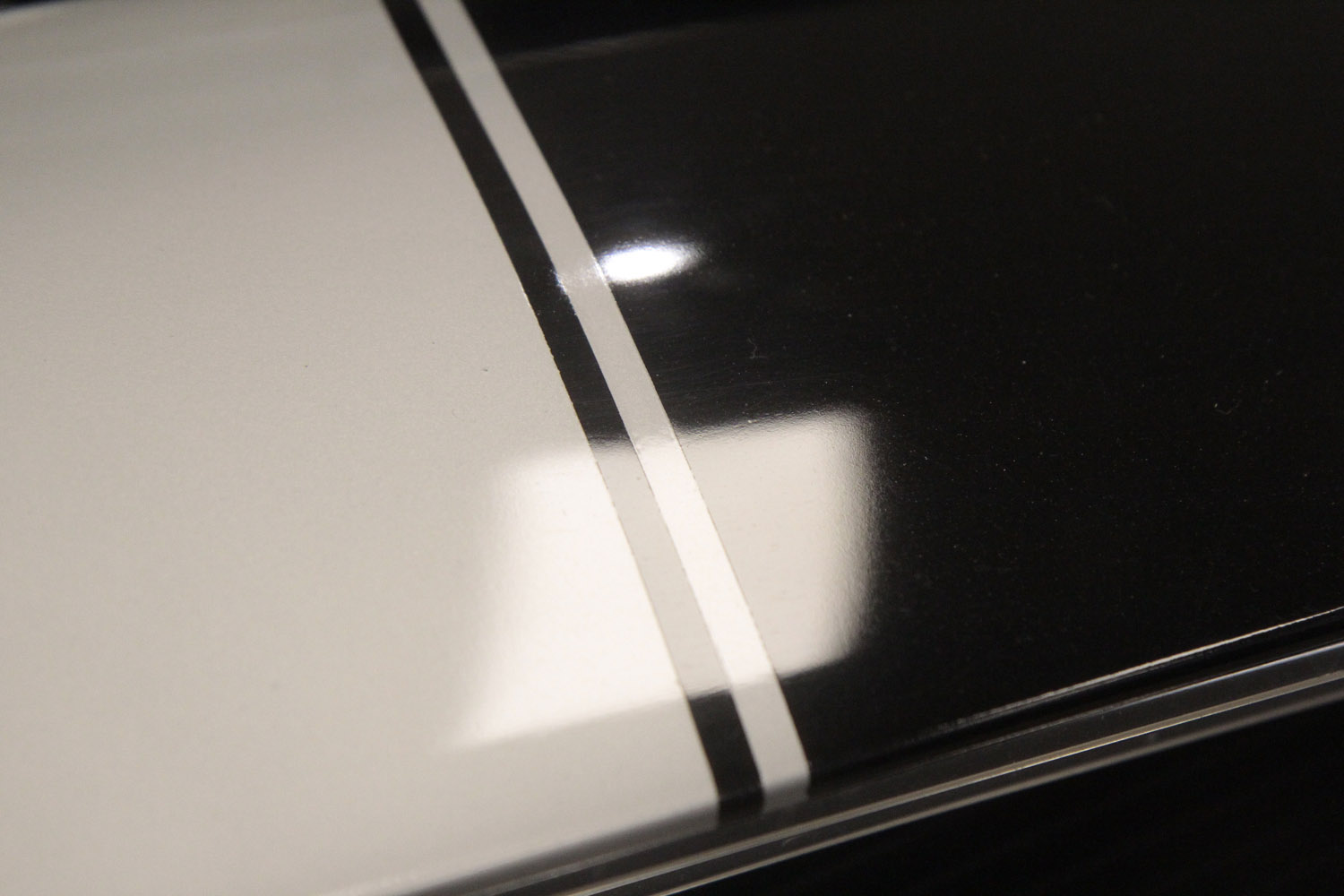

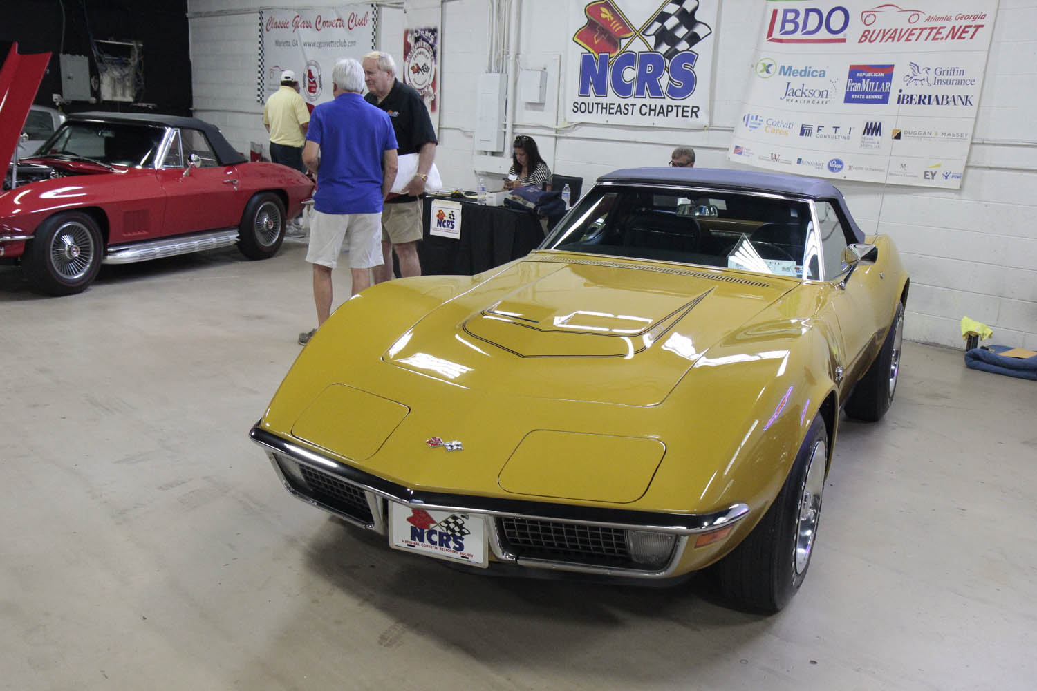

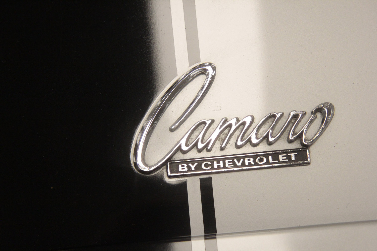

I know there are folks here who have actually worked(or still work) for GM. Out of curiosity, back in the day(and even now) do new cars get wet sanded and buffed at the factory?
I have seen many pictures over the years of cars being painted at the factory but I've never seen a picture of a car being sanded and buffed at the factory.
Thanks!
Attachments - The Supercar Registry _MG_1891.JPG _MG_1798.JPG _MG_1750crop.jpg _MG_0189_crop.jpg
