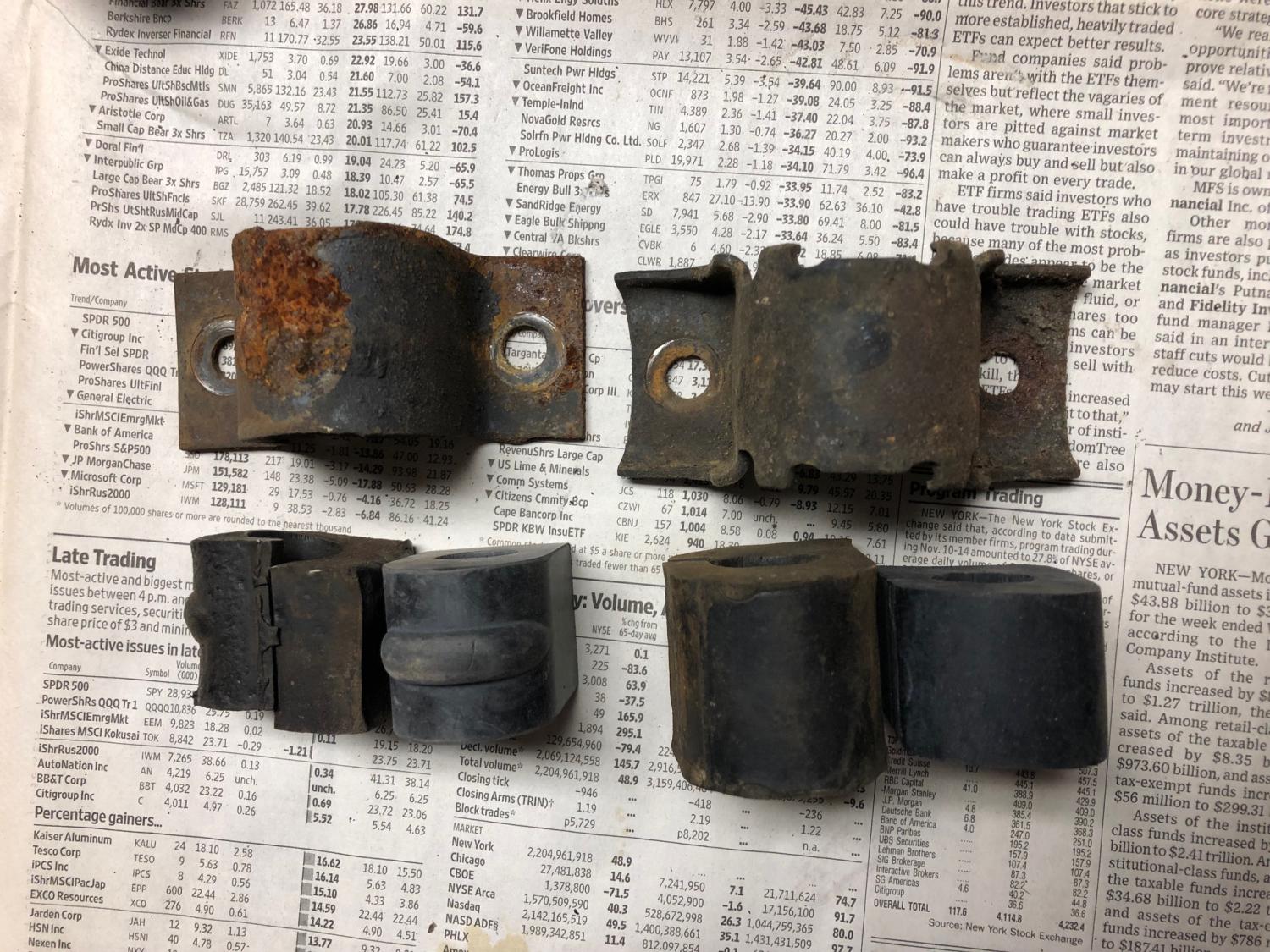

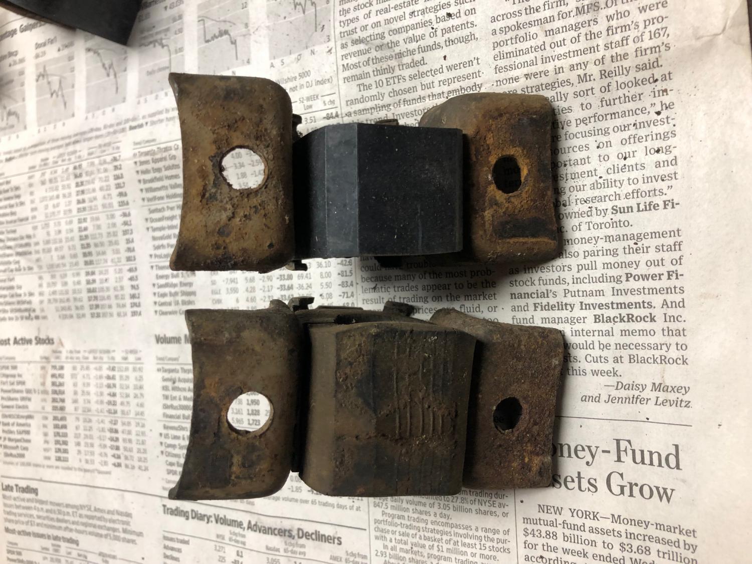

I am having the ruffest time finding the correct swaybar bushings for my 69 z/28 car . does anyone have a good part # and brand my parts stores keep getting the wrong ones to small to big to wide to narrow !! Checked with my chevrolet dealer no help thanks

I am surprised you are having such problems. All 1969 Camaros (except COPO 9737) use an 11/16" front sway bar:
http://www.camaros.org/diffs69.shtml
Yes but there were two styles of bracket, one with 'fingers' used from around mid-production, and an earlier style without. The bushings are different and the one most parts vendors stock fits the early style.
Tim in NSW, Australia
Old 04-18-2017, 12:15 PM
ALLZS ALLZS is offline
Join Date: Dec 2007
Location: ST LOUIS MO
Posts: 1,961
Thanked 121 Times in 66 Posts
Thats correct my car is a late car and it has the brackets with the fingers on the sides. There has to be a correct bushing out there !!
