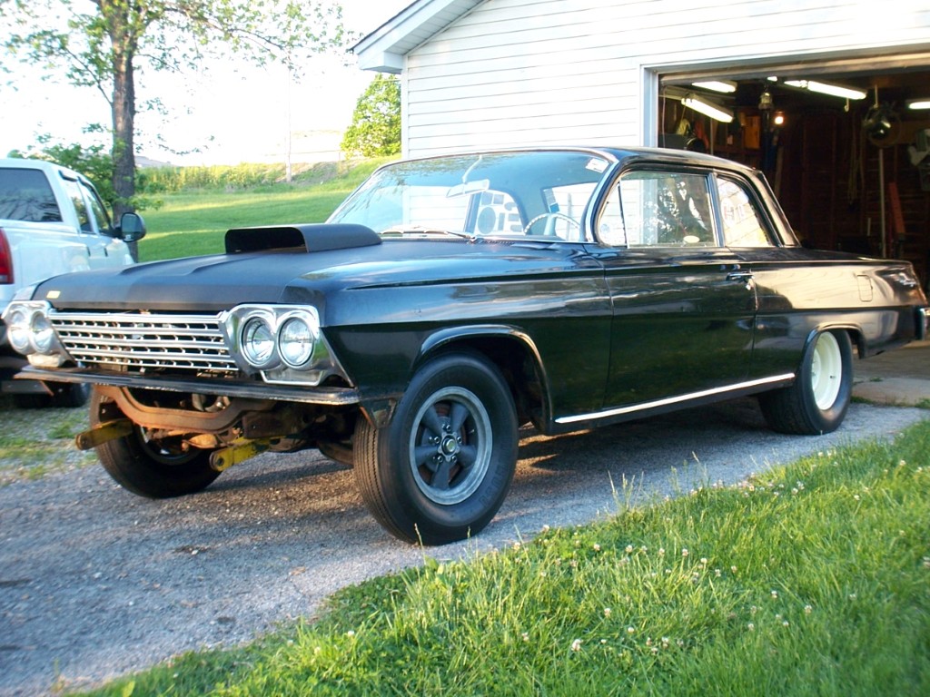

Here's my Day Two Killer Biscuit with mis-matched wheels. Rat motor with Dual Quads, M-22 Rockcrusher 4-gear and ancient RC Scattershield, Strange-equipped 12 bolt with 4.56's. Inside it's got the stock bench seat, Long shifter, Stahl cable-drive tach and Greenline SW's. Should be good for high 11's if I can shift this thing fast enough!
