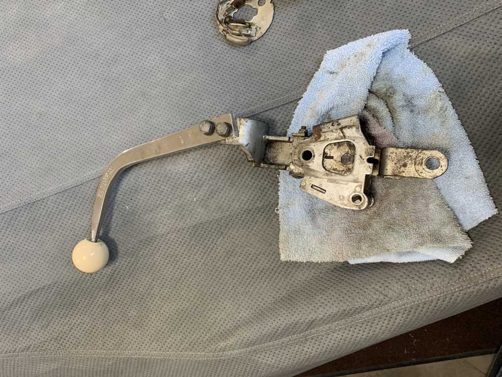

Thanks to Jose for hooking me up with an early shifter assembly along with a handle. Here’s one before before photos
Photo 307 - 308 - As received before cleaning.
Photo 309 - 310 - After Cleaning and greasing/rebuilding.

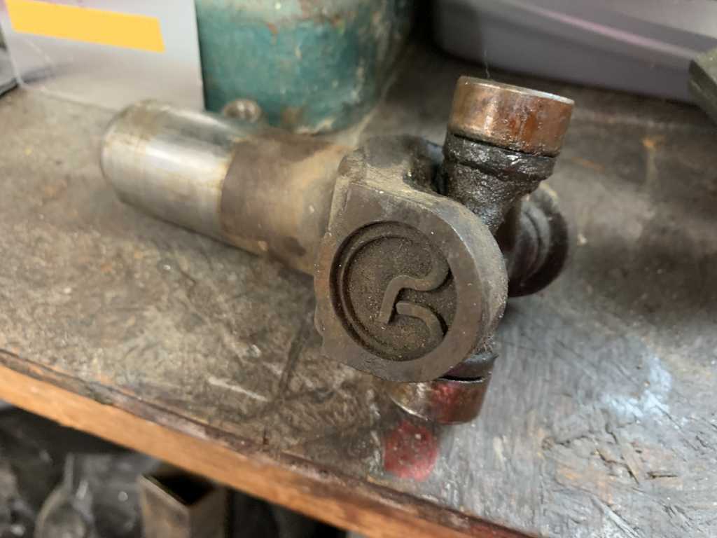

Photo 313 - Driveshaft after cleaning but before soaking in evaporust.
Photo 314 - 315 - Yoke after removing from shaft.
Photo 316 - Broke out the pvc pipe to soak the shaft while the yoke was soaked in a smaller container as well as the original u joint.
Photo 317 - 319 - Yoke after soaking and during rebuild of u-joint. Absolutely zero play in the cups and no wear in the needles or cups. Unfortunately I wasn’t so lucky on the diff side joint so I will source a new grease-able one from a local parts house.

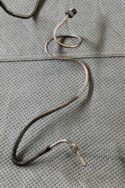

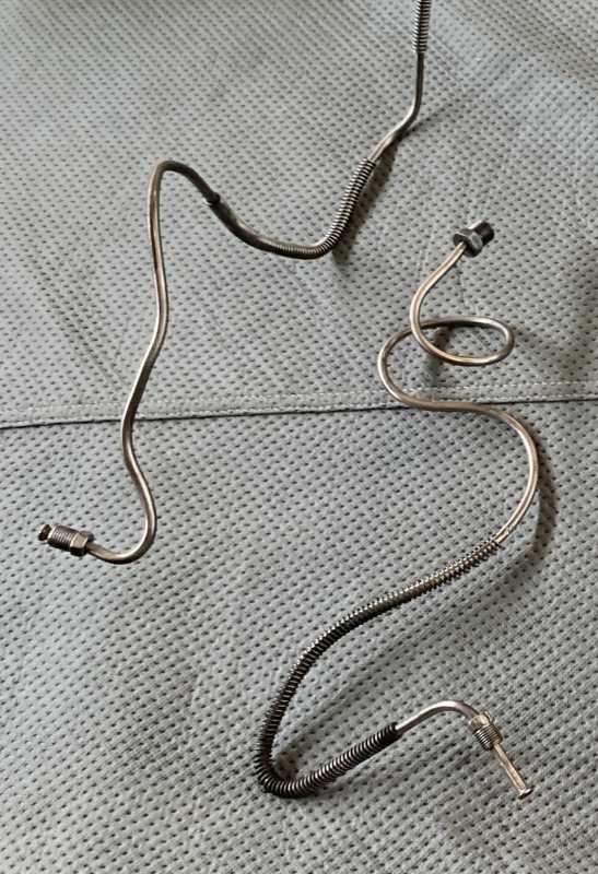

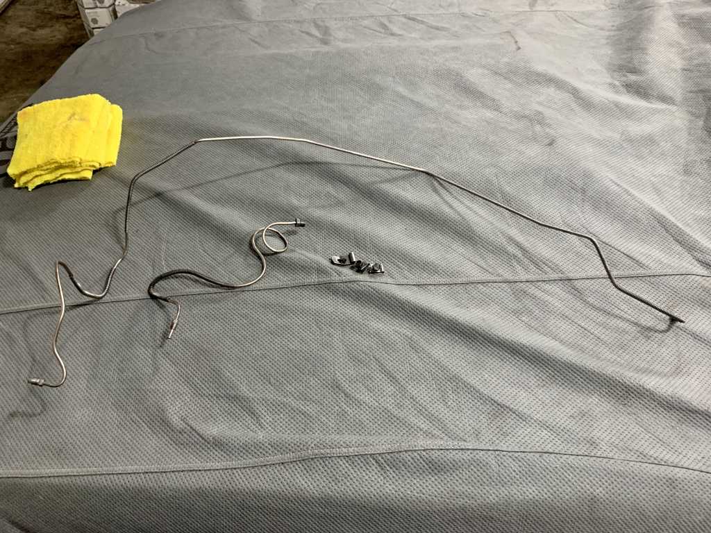

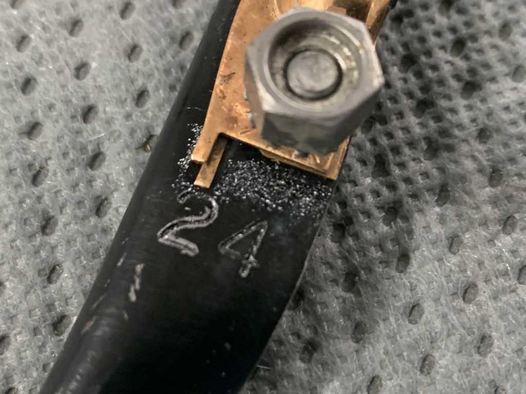

The front brake lines and clips that had black overspray on them and surprisingly it saved them from pitting and corrosion.
Photo 328 - Crossover brake line to the passenger side front and the drivers side front line. Sorry no photos of before paint removal.

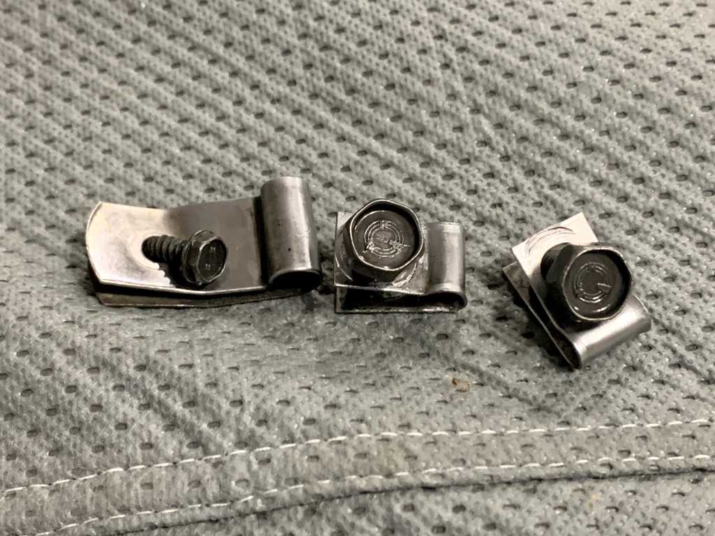

Photo 329 - 331 - Clips and bolts before removal of paint showing detail of stamped “3” and then after cleaning.
Photo 332 - 334 - close ups of the brake lines.
