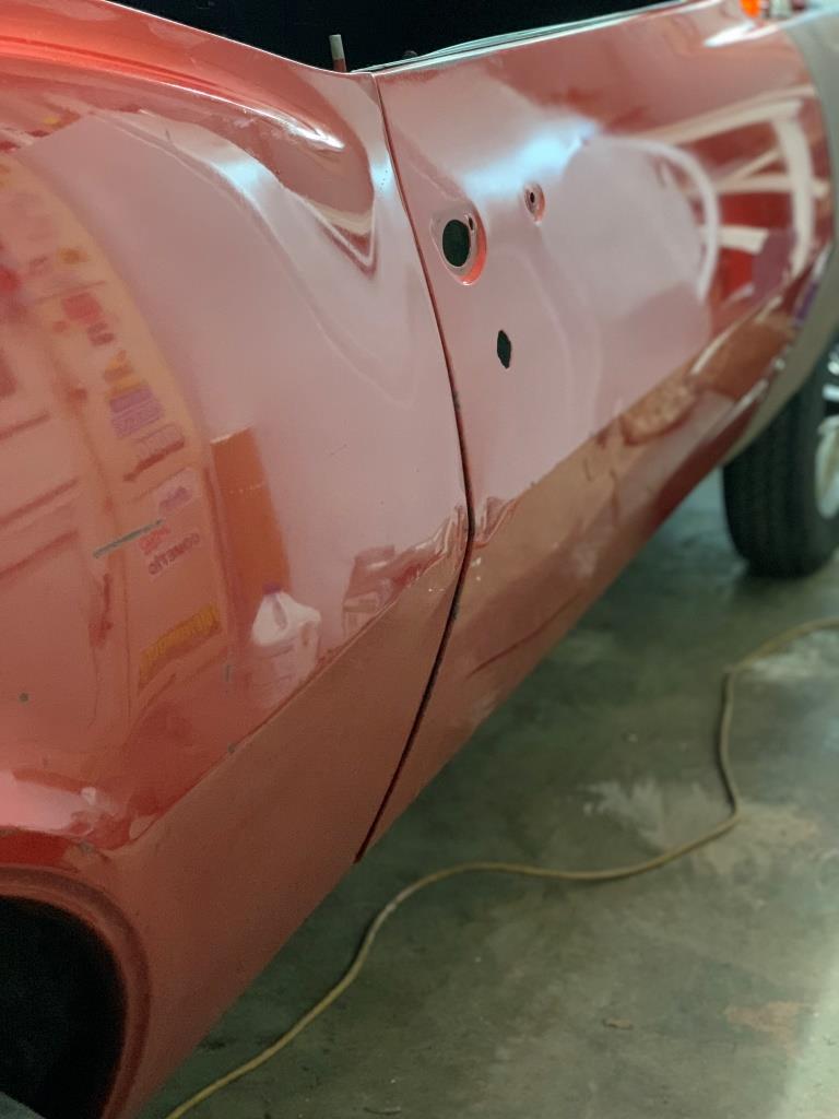

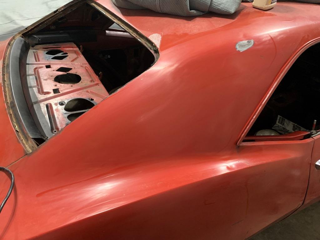

To start the preservation I decided to work on the pass side roof and see how much the ole Matador Red will come back to life.
Steps used to accomplish this was the following:
1. Wash with your favorite dish soap. Mine is Dawn and dry with a microfiber towel
2. Pick a clay bar of your choice and go over the area you are preparing. Mine for this project is Pinnacle clay bar and Meguiars Quick Detailer as the lubricant.
3. Apply a generous coating of Meguiars #7 polish and hand polish it like you are mad at it and let it sit overnight and out of direct sunlight.
4. 800, 1500 and finally 2k wet grit paper - work backwards to make sure you don't go too far on prepping the painted surface and then go back in the order listed. Every car is different so I can't stress this enough but take your time and practice before you get aggressive with the paper.
5. Meguiars #105 with a wool pad on a DA polisher. Reason I do not use a buffer as you can burn the paint quickly if you are not used to operating one. DA polisher is much more forgiving in this regard.
6. Meguiars #105 with a firm microfiber pad on a DA polisher.
7. Meguiars #105 with a medium (maroon Meguiars) pad on a DA polisher.
8. Meguiars #205 with a soft (black Meguiars) pad on a DA polisher.
9. Finish the area again with #7
Now these are the steps I use and seem to have decent success with this. Realize that every car is different and other products will most likely do the same but for me I have had positive results using Meguiars so that is what I used.
Photo 10 - After washing and clay barring the application of the #7
Photo 11 - Roof after after wet sanding and #105 & #205 (steps 5-9)
Photo 12 - Sail panel after wet sanding and before polishing
Photo 13 - Sail panel after polishing
Photo 14 - Pass quarter before steps listed in previous post
Photo 15 - Pass quarter after
Photo 16 - Pass door before
Photo 17 - Pass door after
Photo 18 - Quarter and door after

While I work my way around the backside of the car I continue to use the same procedures mentioned above. Some things to note. The car, at some point (I can confirm prior to April '72 when Dixon bought the car), had been tapped in the rear and I believe that is when the spoiler was added and the trunk lid reshot and a touchup area on the pass side quarter. I will leave it as found as I do not want to disturb the condition of its history. You can also note the original paint along with stripes which were under the spoiler and once an emblem is in place you can see what's left of the cut out of the stripe for said emblem. I will not this later on as I had to find an original replacement emblem as they did not move the emblem when the spoiler was installed. Underside is still original and the remnants of the jacking instructions along with glue residue from the posi traction decal. I will document those later in the process when I begin the trunk area clean up. Now to the photos.
Photo 19 - Another shot of the roof after final process. It's still show imperfections like stains etc. Unfortunately I do not know of anything that will rid them from the paint surface as it embeds deep into the paint.
Photo 20 - Trunk Lid before.
Photo 21 - A little sanding brought out the original stripe under the repaint on the lip of the lid.
Photo 22 & 23 - Trunk lid after. You can see how the reshot did not hold up well over the years. But again will not refinish. You can also see that the pass side bumper guard does not sit flush on the bumper. This is due to what I believe was also part of the rear end bump it obtained. I will have to replace it with an original replacement due to the lower bracket that is welded to the guard broke its welds. I have several used guards so this will not be an issue. The primer sprayed on the drivers quarter and upper quarter and sail panel will be addressed. I will remove this primer and keep whatever is underneath up to the surface.

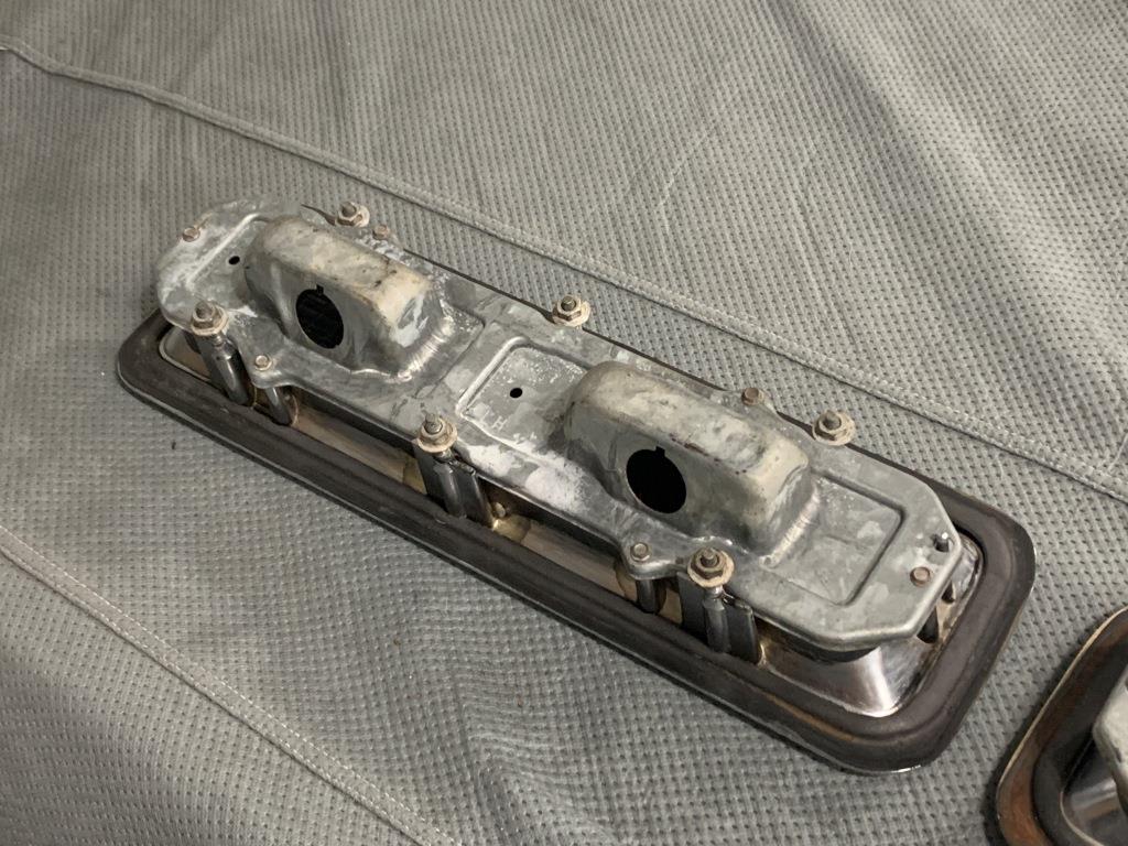

Photo 30 & 31 - While the trunk lock is out I went ahead and did a cleaning and polishing of it. Granted there is some residue in the key hole after polishing but will be removed and clean when reinstalled.

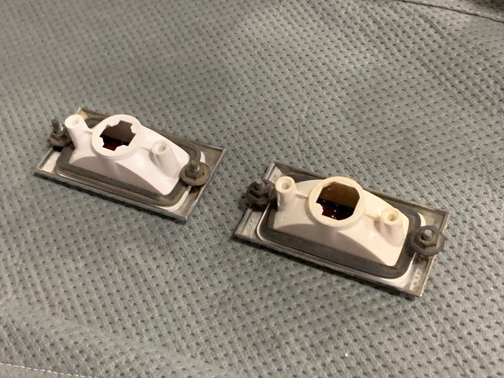

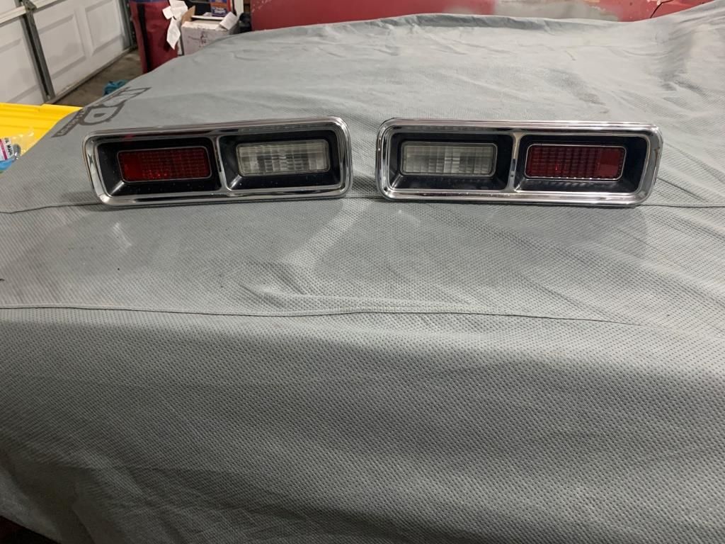

Photo 32 - 33 - Also while out I cleaned the tail light bezels and housings. Bezels were done with Zep Citrus Degreaser (can be purchased anywhere I'd assume but I get it at Home Depot) and a hand polish. Then the housings I did the same Zep cleaning and after wiping them down I used #0000 steel wool and a soap water solution and cleaned the galvanized. I think they turned out ok being originals.
Photo 34 - 37 - Rear side marker lights were soaked in dawn soap and hot water to get them cleaned and then I used the da polisher and #205 to clean up the lenses. Sorry no before photos on these.
