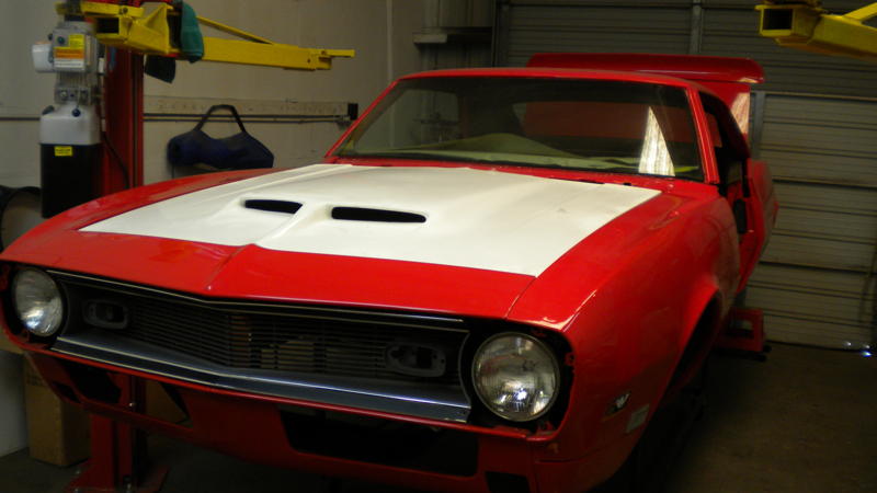

Default Re: 68 Yenco clone
pxtx,
Here are the pics of the project I promised (finally worked out how to reduce them)
Cheers: auschris
