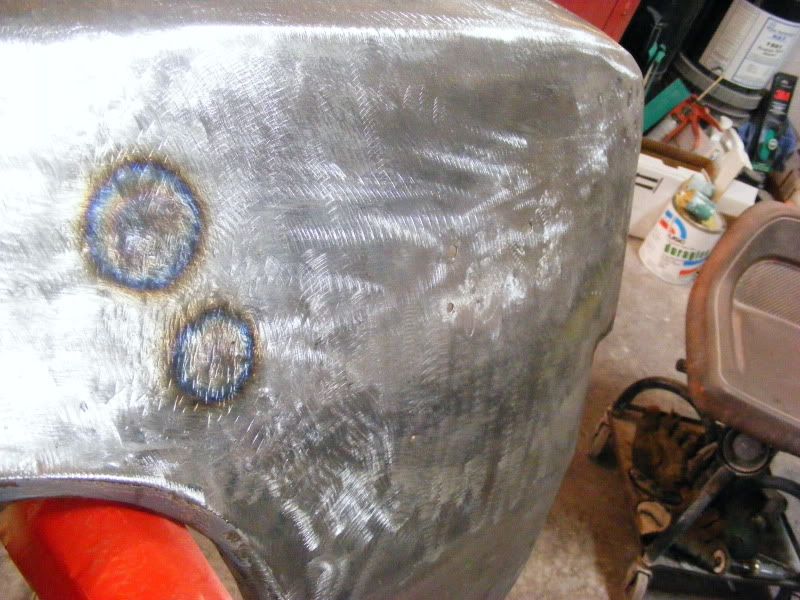

Just a brief update for this weekend; Body guys were both hard at work pretty much all week trying to get the fenders back into a usable condition. DS fender...not so bad...PS fender...not so good...but they've managed to save it.
The previous patch job at the bottom of the fender is fixed, and the dents have now been smoothed out.
There was a nice crease about 1/4 way back on the fender that had been stuffed full of Bondo, and the forward edge of the fender had been jammed back and stuffed full of Bondo as well. At least there wasn't any more rust to contend with. [img]<<GRAEMLIN_URL>>/rolleyes.gif[/img]

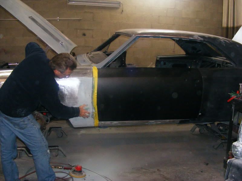

Body guy #2 hard at work
Another skim coat of filler goes on the DS fender.
QUICK!...somebody call Ghost Hunters!...we've got orbs! [img]<<GRAEMLIN_URL>>/grin.gif[/img]

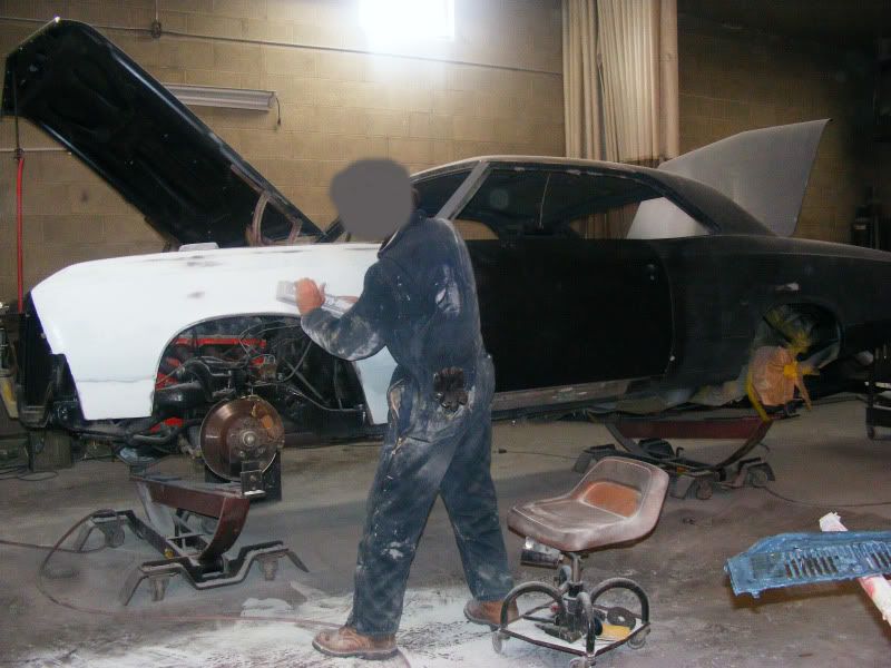

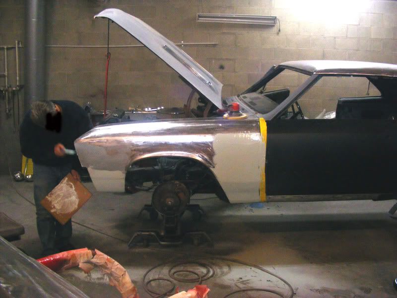

Bodyguy #1 wound up flying solo this week as body guy #2 has been out of town for his work. Still, he (#1) managed to get the pass. side fender done and ready to block out and was hard at work on the drivers side fender when we arrived today.
Here he is blocking out the &quot;Icing&quot; finish filler coat.
Pass. side fender back in place.
Still amazes me how he got these lines back so well.
