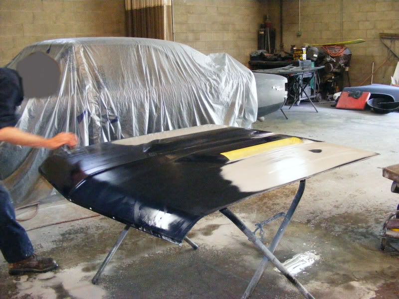

After three attempts at finishing the hood, hopefully...<span style="font-style: italic">hopefully...<span style="font-weight: bold">HOPEFULLY</span></span> that nightmare is now behind us.
Here's Bodyguy a couple weeks ago having just blocked the hood <span style="font-style: italic">again</span> in preparation for buffing;
...and here he is after having just stripped it down to start over again after applying the adhesive and foam:
In Bodyguy's own words...<span style="font-style: italic">&quot;in all my 30-plus years of doing body and paint, I have <span style="text-decoration: underline">never</span> had to deal with anything like this!&quot;</span>
Gott'a love them repop parts [img]<<GRAEMLIN_URL>>/rolleyes.gif[/img]
Anyhow, it now appears the hood has been stabilized, and it will be shot for (hopefully!) the last time in the next day or two.

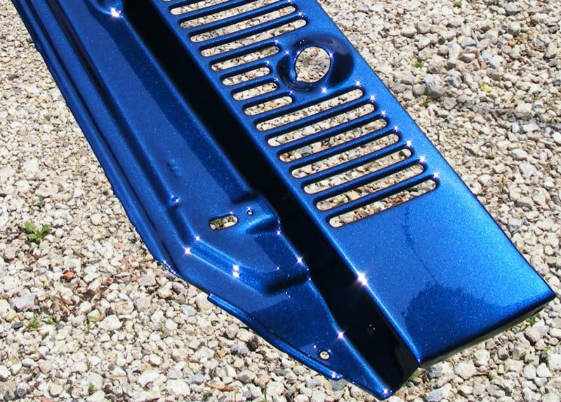

On the plus side, Bodyguy got the cowl panel and bumper filler panels done this week...and I finally got to see what the paint will look like in direct sunlight:

Wow Eric, I really like that blue in the sunlight. Great choice!!

Very nice Eric. That color really POPS!

Here's a little better zoomed in look at the color:
Trust me, it looks even better in person.
The color is exactly what I was looking for, which provided an immense relief after the recent string of so many set-backs and disappointments.

Stopped by the shop to drop off the fuel tank &amp; straps and to help Bodyguy turn the hood over so he can get it painted--hopefully for the last time. Bodyguy reports the hood is now stable and he does not anticipate any further problems with it.

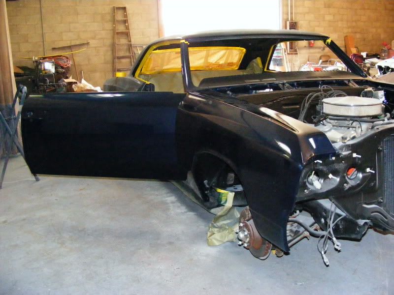

Well, as the old saying goes, <span style="font-style: italic">&quot;the third time's a charm&quot;</span>.....I hope.
Bodyguy seemed pretty confident that we've got that stupid hood licked now, but I'm not going to breathe that sigh of relief until it's been cut &amp; buffed.
The decklid is mid-way through process...
...as are the drivers door and fender...
...while the pass. side door &amp; fender patiently await their turn:
Bodyguy was in the process of taping up the trunk &amp; interior when we arrived today.
He's going to do the final blocking &amp; wetsanding on the roof in the next few days, and once we resolve the issue of where the hole is supposed to be located for the rear antenna, the back of the car will shortly thereafter be ready for paint.
God willing and the creek don't rise.
