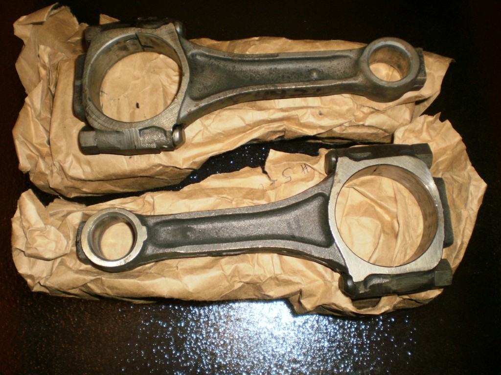

Here are the gm Dimple Rods and Harmonic Balancer.
The Harmonic Balancer is now sand plasted with a shot of primer since photo.
