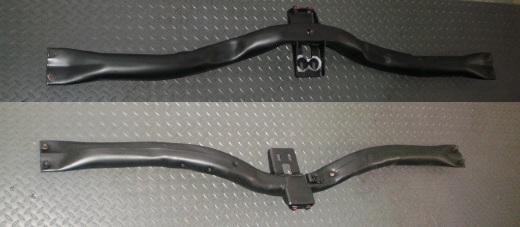

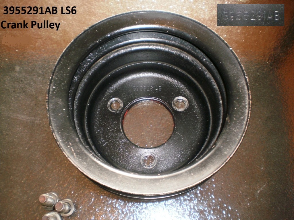

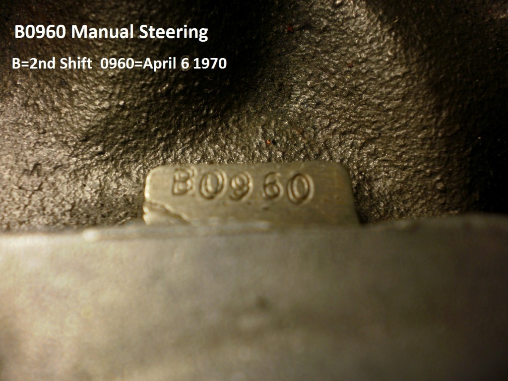

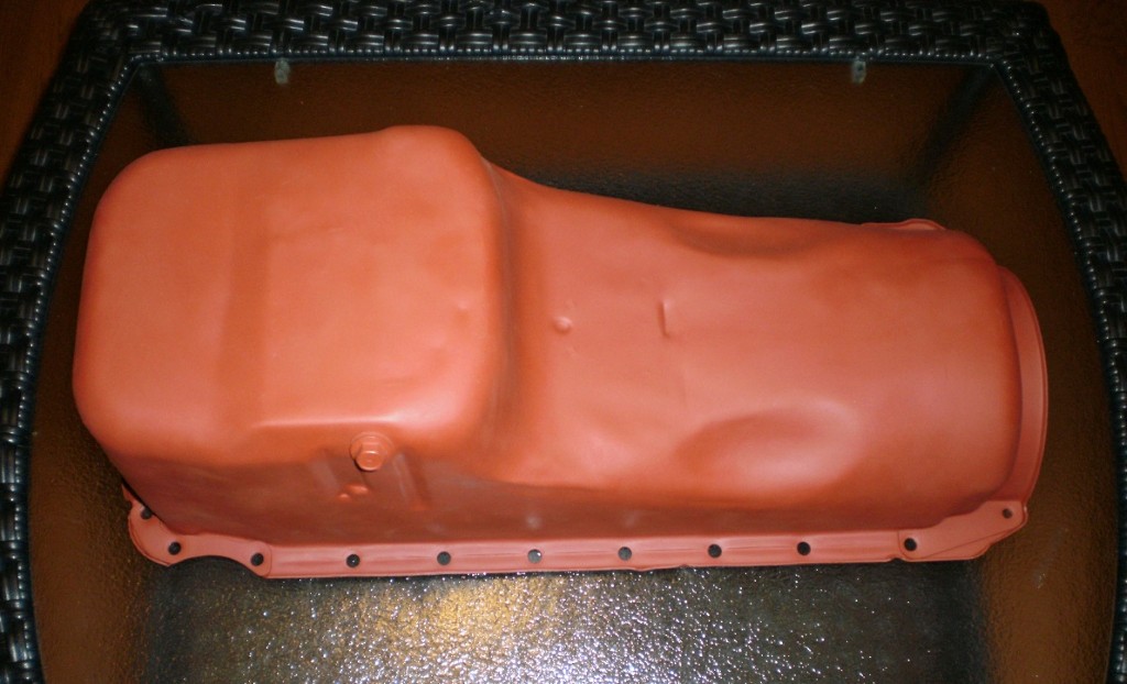

More Details.
Clutch Z bar.
Manual Steering.
Pulleys.
Oil pan and Timing cover ready for paint.

I sand blasted the crossmember and re painted it myself.

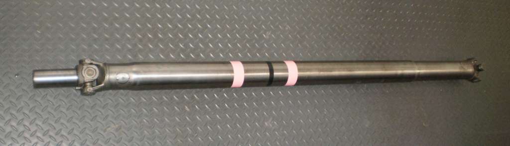

The Drive shaft was restored by the last owner and it looks great.

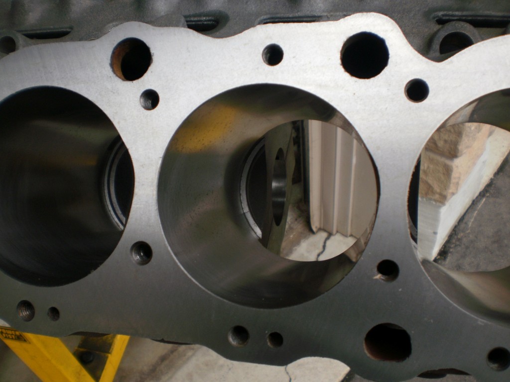

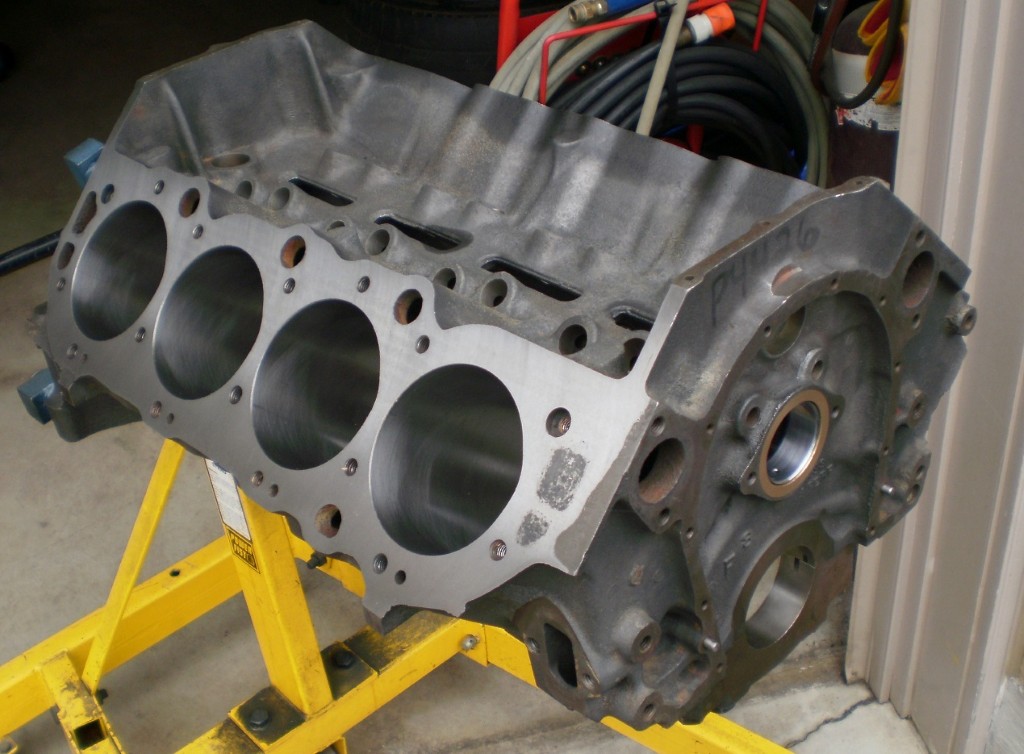

Its been awhile since i updated this thread but the motor is now moving along towards its completion.
I dicussed many things with my rebuilder and he did mention to me that the motor was once rebuilt in its history of being a race car so this is the second rebuild for my original LS6.
Motor was at .030 over so we decided to go .060 over to clean it up.
Motor was also decked,cleaned and neaded a cam thrust repair.
As far as the heads went we hardened the exhaust seats,did a valve job and resurfaced the base of the heads.
