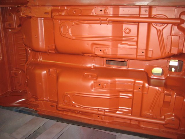

  #82
Old 01-09-2012, 06:41 PM
Hemicolt Hemicolt is offline
Join Date: Nov 2011
Location: East Tennessee
Posts: 966
Thanked 2 Times in 2 Posts
Default Re: Day 2 Vega
I grafted 1 3/4&quot; chromoly tubing from the rear subframe to the front. (I use the term subframe loosely..lol)
You can see some pictures of them on page one. The rear floor is sliced and the rear portion of the bar passes up into it.
I don't believe Motion did anything at all to their cars. I have never saw a picture of even a subframe connector being added.
Keep in mind, I'm building this car to pretty much appear as it would have back in the day. If I was going to lean on it with slicks while side stepping the clutch, I would have done a ton of chassis bracing to the car. Cage, welding all structure panel seams solid, etc.
The front end is going to be kept stock with the exception of heavier springs and the S-10 spindle / brake conversion.

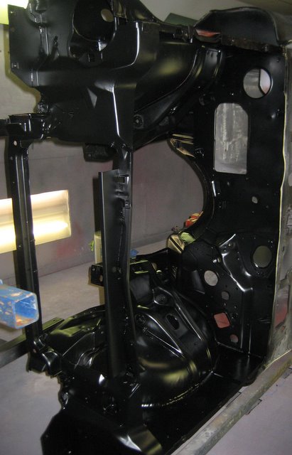

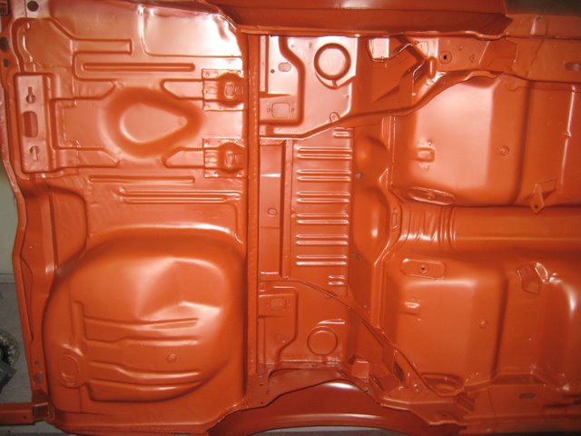

  #84
Old 01-21-2012, 11:23 PM
Join Date: Nov 2011
Posts: 966
Got the bottom of the car and engine compartment done today. I used the factory colored, PPG primer on the bottom and a PPG black on the engine compartment. Followed up with a satin clear on top and bottom. Black is spot on shade and the clear on the bottom will offer protection from oil staining, etc.
Hope to have the car finished up and painted by the end of Feb.
I'm so happy with the way this project is turning out. It is going to be light years ahead of my Chevelle.
It's not the critic that counts, not the man who points out how the strong man stumbled or whether the doer of deeds could have done them better...

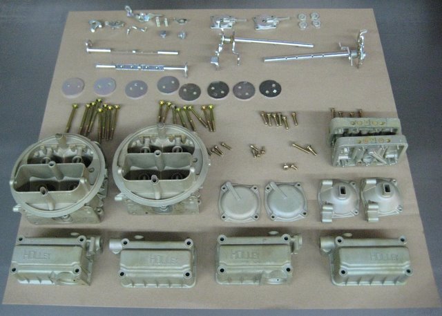

  #88
Old 01-29-2012, 02:46 AM
Join Date: Nov 2011
Posts: 966
Thanks guys.
Picked up the carb. pieces and oil pan from the plater today.
Everything looks really good.
