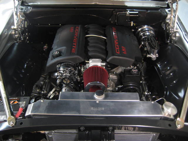

The Windshield will be installed later this week and another one of those PITA deals to deal with are the windshield clips......the screws sent in the Repro kit with the clips didn't have a chance in hell of working......Again.....these guys sell this crap and we get stuck trying to make it work.....Lucky for me, I have a complete machine shop to play with, but the average guy in his garage would be screwed trying to fix this little problem......Anyhow, here's a before and after of the screws......
Screwed in.............
Clip installed..........
I also got all the A/C lines finished and installed along with the heater hoses........I ordered some of those heat shrink clamps this time.........we will see how good they work.....
I also got the ECM and the TCM mounted on the inner fender panel.....
The list of things to do is still long......but, it's getting shorter...

Look what showed up today........the missing long lost cousins........LOL
Starting to come together........I'm getting a lot of little stuff done. Sensors ,Trim , wiring........etc....Getting closer..
