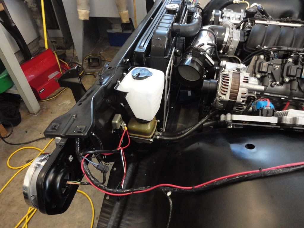

Default Re: Next Years Power Tour Car
I got the Power Steering reservoir mounted today....since the voltage regulator is no longer needed, I ended up mounting it right in that spot under the windshield washer bottle....worked out great...just in case I ever have to add fluid, it's just a couple of screws to remove the bottle assy.....I also got the radiator hoses all finished and added the coolant to the system.....not a drop leaked......I also changed the serpentine belt for a slightly shorter one......I'm waiting for a new turn signal switch to show up so I can finish all the under dash wiring and get that back together.....Exhaust hopefully later this week, then a front end alignment, then install the sheetmetal........getting close

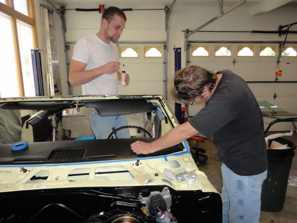

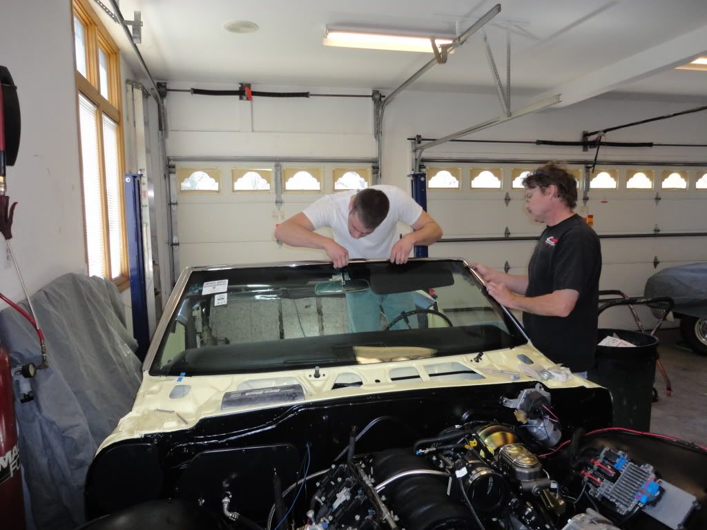

Pic's from this morning.........Getting closer....
