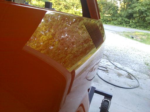

Old 05-31-2012, 01:29 AM
Hemicolt Hemicolt is offline
Join Date: Nov 2011
Location: East Tennessee
Posts: 966
Thanked 2 Times in 2 Posts
Default Re: Day 2 Vega
Mopar color puts me outside the box...lol
Hit the car with 3000 wet paper on the d.a. sander. Check out the reflection of the trees across the road.

Old 06-01-2012, 05:33 PM
Jefferson's Avatar
Jefferson Jefferson is offline
Join Date: Oct 2011
Location: White Rock, BC
Posts: 52
Thanked 47 Times in 8 Posts
Looks good, don't go overboard with the DA. It will give small flutters/waves. Best to wet block up to the highest possible grit and quickly DA without the soft interface pad (except in real curvey areas)

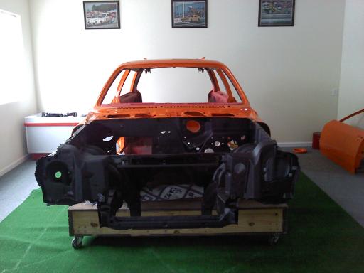

  #214
Old 06-12-2012, 10:45 PM
Join Date: Nov 2011
Posts: 966
Got the car down to my other shop. Going to let it sit for a while and then start putting it together.

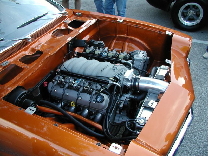

Old 06-15-2012, 03:59 AM
Join Date: Nov 2011
Posts: 966
That's a very clean install of the LS engine. I would like the car better if it wasn't tubbed.
