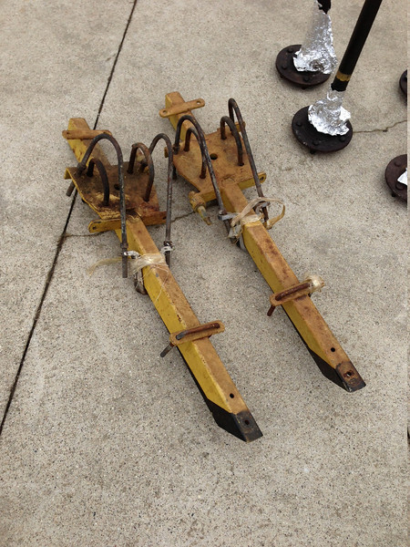

Default Re: Traction bars
Can you guys ID these traction bars for me? Guy I bought them from told me they are Lakewoods from the mid-1970s. Thanks!
  #143
Old 03-10-2013, 11:19 PM
whitetop whitetop is offline
Location: Ohio
Posts: 2,201
Thanks: 17
Yep Lakewoods-"Traction Action" series with the competition j-bolt set up. Early 70's-you can tell by long tail on the rear and they still have the rear spring clamps on the rear. The length of the bar on the ones in the mid 70's ended right after the axle pad.
Fit 67-69 Camaro, 68-74 ish Nova etc.
  #144
Old 03-10-2013, 11:27 PM
Join Date: Nov 2002
Location: Pennsylvania
Posts: 9,908
Good bars Tony. Tough to find especially with the hardware.
  #145
scuncio scuncio is online now
Posts: 14,050
Thanks: 2,852
Thanked 7,139 Times in 3,271 Posts
Thanks! This guy evidently had them on a 68 Camaro. What do you mean by the 'competition' j-bolt?
  #146
Old 03-10-2013, 11:31 PM
Join Date: Nov 2002
Posts: 9,908
The "J" bolts are the big bolts that go from the axle pad to the heavy "U" bolts underneath. Many leave them off on the street but shouldn't IMO. That is the Lakewood trade mark for me.
  #147
Old 03-10-2013, 11:42 PM
Posts: 14,050
Thanks: 2,852
Thanks Sam...I recognized the J-bolts but wasn't sure if the 'competition' J-bolt had any significance.
  #148
Old 03-11-2013, 12:06 AM
Join Date: Nov 2002
Posts: 9,908
Look at the bars out today Tone. I do not believe any have the old style "J" bolt setup. Tough at times to buy the heavy "U" bolts and "J" bolts anymore. For the wider, earlier bars the heavy "U" bolts are almost impossible to find. Have to have them made.
  #149
Old 03-11-2013, 01:44 AM
Posts: 14,050
Thanks: 2,852
Gotcha. Glad this one has most of the hardware there.
  #150
Old 03-11-2013, 02:41 AM
Join Date: Nov 2002
Posts: 9,908
has all the hardware except the snubbers. You can buy them easy and then cut them square to eliminate the cone shape they have. There are rattle can paint colors out there to replicate all the colors of the hardware and also the bars.
