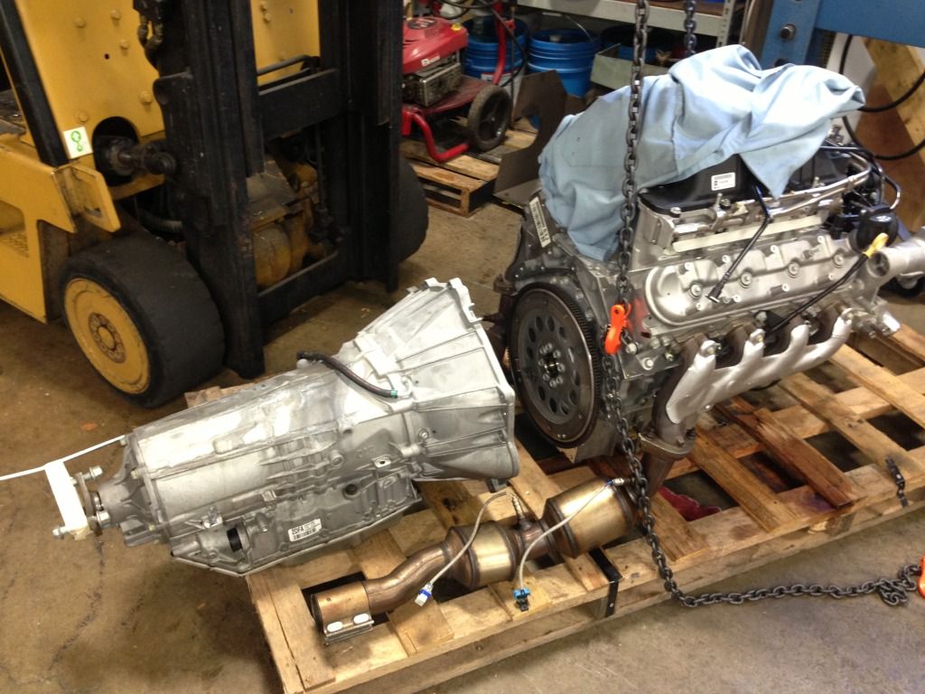

Made some progress today......First.........I ordered a built 4L70E trans to replace the 6L90E........John from Speartech is going to make the harness mod's to suit the different trans and said it's actually much easier now......... So.......I took the trans off the back of the engine and brought the engine home to meet the car for the first time......LOL.....The new trans will be delivered in a couple of weeks so while waiting I'll get the new suspension on the car......then continue with the engine install.......If anyone needs a 6L90E with 2000 miles , let me know...........Here are some pic's from today.....

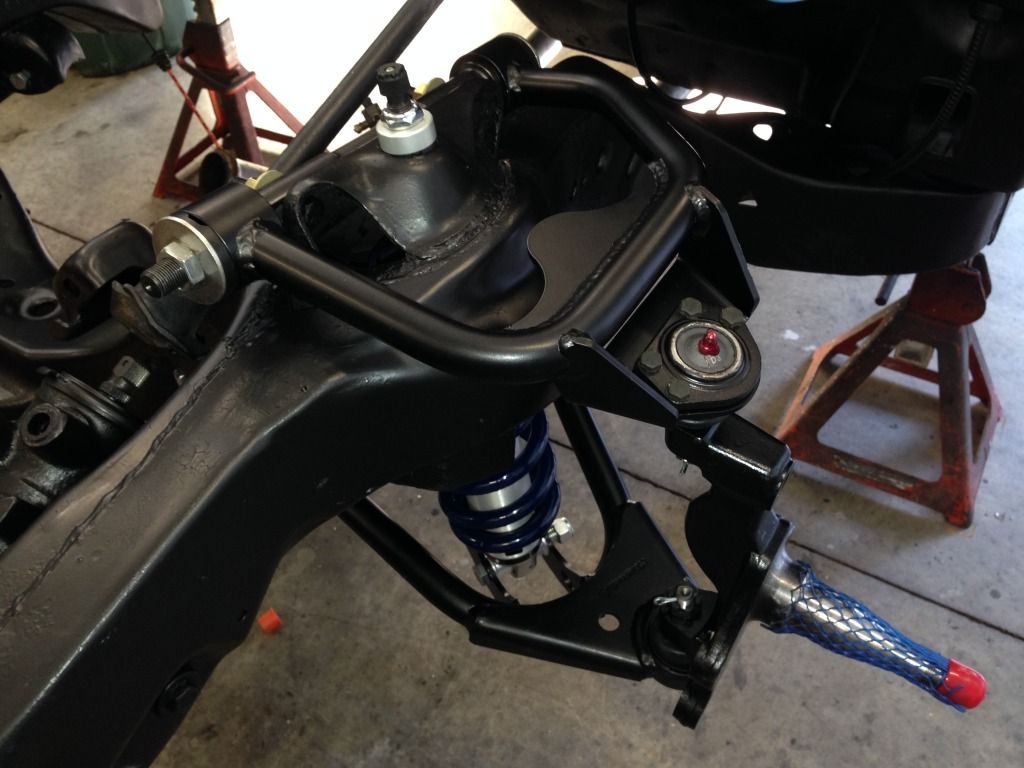

LOL......I took the stock steering arms to the shop today for glass beading and painting......got that done and when I got home I installed the upper control arms and started to install the disc brakes and the steering arms.............As soon as I started to install the parts I knew I had a problem as the kit bolts wouldn't go thru the arms..........Hummmm......I read the instructions and ......LOL.......I don't have a drill big enough at home to drill the holes out to 1/2"..........So.....I had to stop for the day and finish then up at the shop tomorrow..........Dam Instructions......

Got a little more assembled.......Got the steering linkage installed and the brake caliper mounts.......I'll get the rotors and calipers installed then on to the rear......

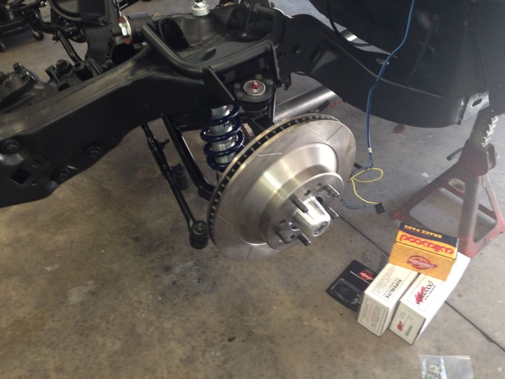

Got the front spindle hubs installed......when I opened the box with the rotors I noticed they weren't cad plated.......So I sent them out for plating to keep that rust from showing up later.......I should have them back for installation tomorrow......I also ordered a Posi unit so I decided to wait for that to show up before getting involved in the rear end......so....I jumped into the inside and finished getting all the original A/C removed along with the dash and wiring......I also sent the stock AM radio out for conversion to AM/FM Satelite..............Started mounting the Vintage Air system.......Having Fun!!!

Lot's of balls up in the air.........waiting for the firewall insulation to show up........and the Rotors were picked up from the plater today.....so we got the front brakes installed......I also got a call from the transmission shop and the 4L70E trans will be delivered tomorrow............so after getting the brakes installed I decided to get the rear end out of the car and take it over to Jimmy Quinn at Chassis Service to get the posi unit installed and get the ring and pinion replaced if needed....seems to have a lot of backlash.......I should get all the Ridetech rear suspension parts in tomorrow and have the engine install going in a day or two........
