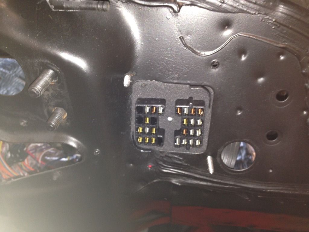

Got the Dyna-mat installed today.......Got the front sway bar re-installed......and the new fuse panel from American Autowire installed along with all new wiring started........Engine/Trans go's in tomorrow....
Ken
