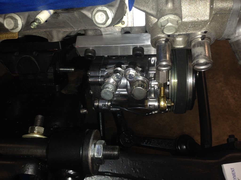

The Shiftworks conversion kit showed up to change the console shifter over to a cable mechanism with the proper detent plate to match the 4L70 along with the correct neutral start and back-up light switch......Got it in and installed.........I also stopped at Chassis Service and the rear axle assy will be picked up on Thursday..........I'm still waiting for some material to come in to finish the motor mounts.......So.....I had a little time to mess with the A/C compressor mounting......I used a small front drive style compressor to keep from notching the crossmember....It ended up being so simple and the Belt even lines up........having a digital caliper around to use makes everything easy...........I just need to make a simple upper adjuster for the compressor to tension the belt.....Pretty Simple.....

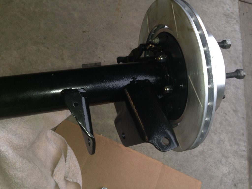

I picked up the rear axle assy today from Chassis Service......Powder Coated.....and everything new including axles....Jimmy installed the rear brakes at the same time..........
Saved me some time..........Brought it home and mounted the Ridetech rear Coil-over brackets and just kept going.....got it installed.......Also got the new motor mount engine adaptor plates and frame mounts finished......the adaptor plates worked perfect.....but ....I have to modify the frame mounts to fit the rubber mounts.....I should of had one at the shop to check what I was making........LOL.......

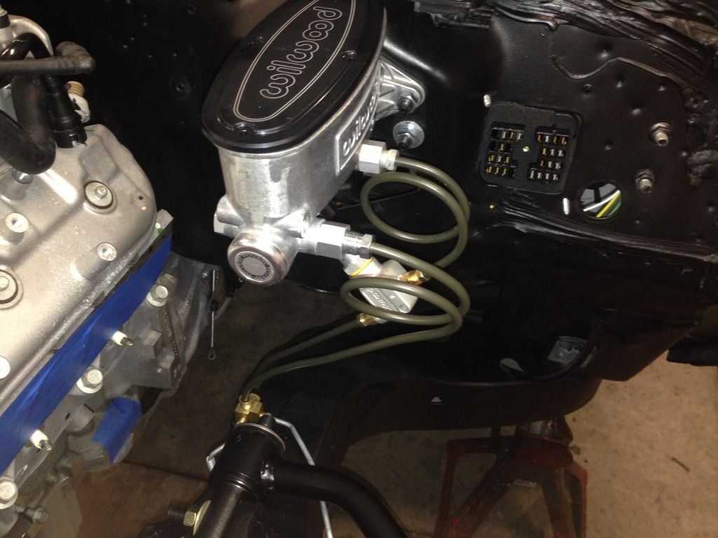

Default Re: Next Years Power Tour Car Part 2
Got the new motor mounts finished and installed today.........As you can see in the first picture the Dirty Dingo slider mounts on the stock frame stands were up to the front of the engine.........I needed that room on the passenger side for the A/C compressor......so....the slider adaptors and the frame mounts had to go............in the following pictures you can see the new adaptor plates and frame mounts I made to shift the mount position to the center of the crossmember to give me the room for the compressor.........I made a couple of simple mounts and a RH/LH heim end tensioner to get the stock belt tight.......I also made some new brake lines at the master cylinder with the coil in them for body/Chassis flex (thanks Rick).......Getting ready to pull the engine out for the last time for a couple of loose ends then it go's in to stay.....
