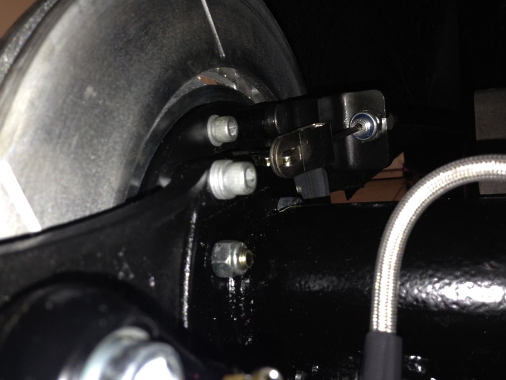

Now that the stupid Brake issues are gone......I took the day today and got all the Disc Brake emergency brake cables integrated into the system and it's all finished up and working perfectly........The wildwood expanding internal brakes built into the rotors are ......Lets just say a lot "Better" than the Seville rears used on the last couple swaps......Great job Wilwood!!!!...........I also started getting the console wiring made and installed .......doubled checked the Neutral safety switch and the back up light switch and everything works where and when it's supposed to......I also got the info on the turning radius of the Ridetech suspension.........It is a slightly larger turn radius than stock but they said not to worry about it.........So.......I'm not gonna worry......LOL........Time for a Nap!!!
