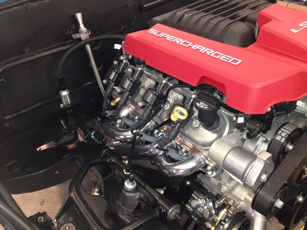

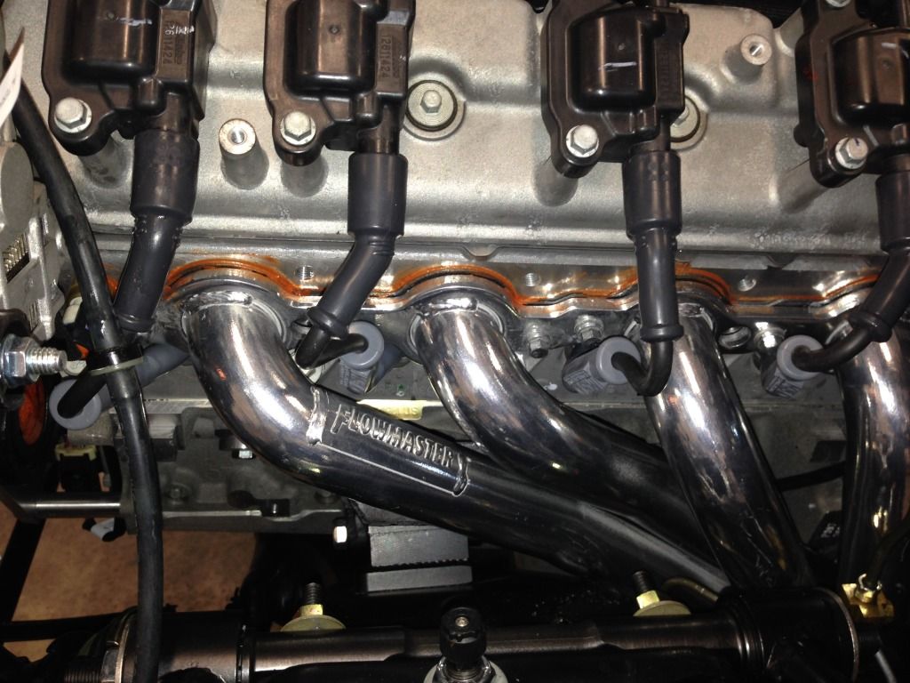

Expect the unexpected..........LOL..........By not being able to use the stock Camaro exhaust manifolds......I had to buy Headers.......The Headers didn't fit as advertised.......so we had to make things fit to the Headers.....then the Headers ran into the trans cross member........fix that........then I go to install the spark plug wires......the Boots hit the tubes.....new spark plug wires.........(two sets.....the first set I ordered didn't fit either)......The MSD wires had a bendable Boot and worked perfectly............

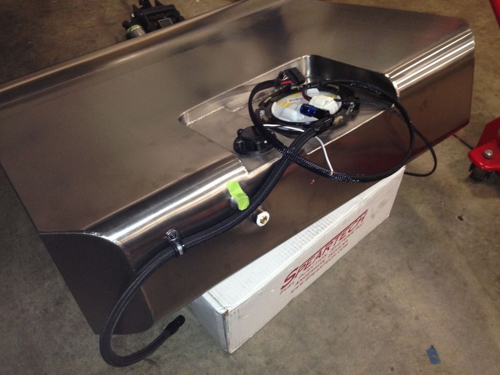

I finally got the Gas tank installed.........would have been a lot simpler if they would have supplied bolts for the straps that were 1/2&quot; longer........Just couldn't get the nuts started........went and got some longer ones today and 5 minutes later it was in.....I also have the fuel line installed and completed........I also got the drive by wire gas pedal installed.......As long as I have the room while waiting for the new radiator to show up I'm going to get the intercooler pump and lines all run..........need to find a reservoir for the system........

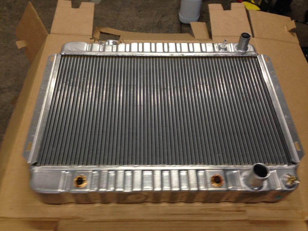

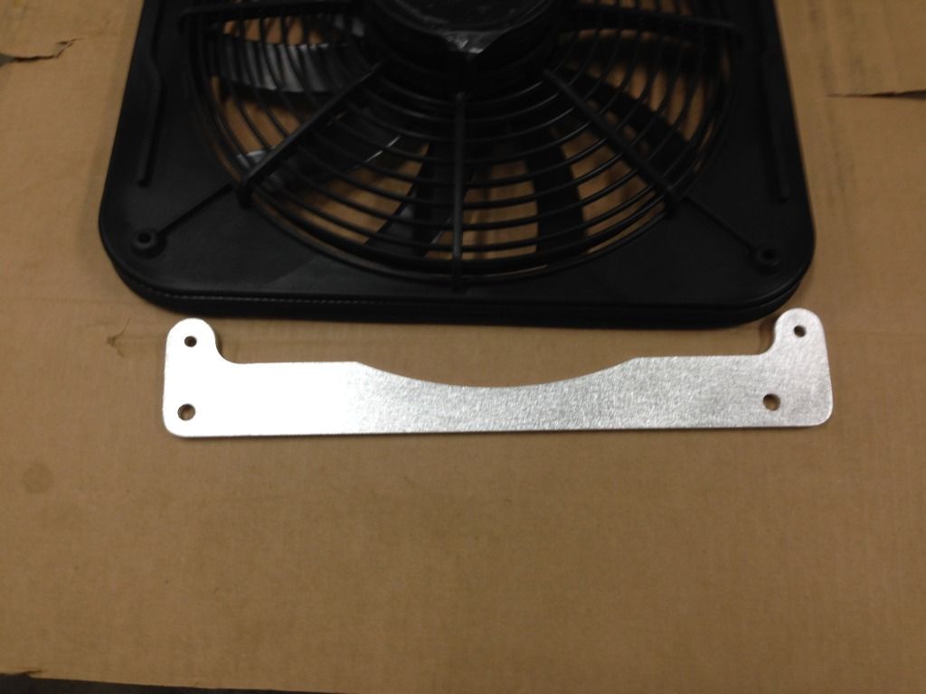

The new radiator showed up today.......Designed for LS engines.....Both hoses on the passenger side, cross flow and a fitting for the steam lines welded to the top tank.......Too easy....Got it installed and dug out the fan mounting brackets I made a while back and test fit everything........I love it when a plan finally comes together and works out........Ding!!!.....Ding!!!!!
