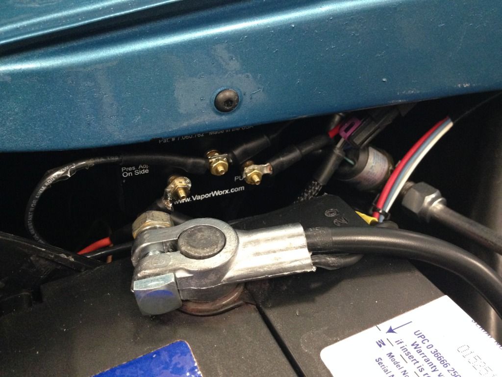

I got the inlet tube welded up and I just need to make and weld in the Mass Air Flow mount fitting..........I also got my Vaporworx fuel pump controller......gonna make a bracket today to get it mounted and get it finish wired up today.......All the wires seem to terminate around the Battery and the one I'm using is both a top post and side post.....makes it a lot easier to tap into for battery power.....the mass of wires look like a mess but when the Battery is in everything falls into place.......Getting Closer....

I got the Fuel Pump controller (Vaporworx) all installed and finish wired............It needed to be near the Battery so I made a bracket to mount the module inside the fender right there........worked out pretty good........I was also going to make the mount for the Mass Airflow sensor and after stopping at Frame-up Wheelworks.....Donnie told me that GM has them already made and ready for welding......and he just happened to have one......Lucky!!!!......
