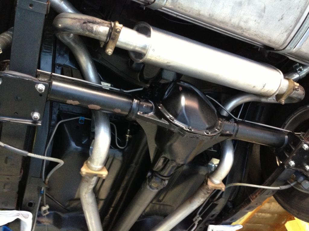

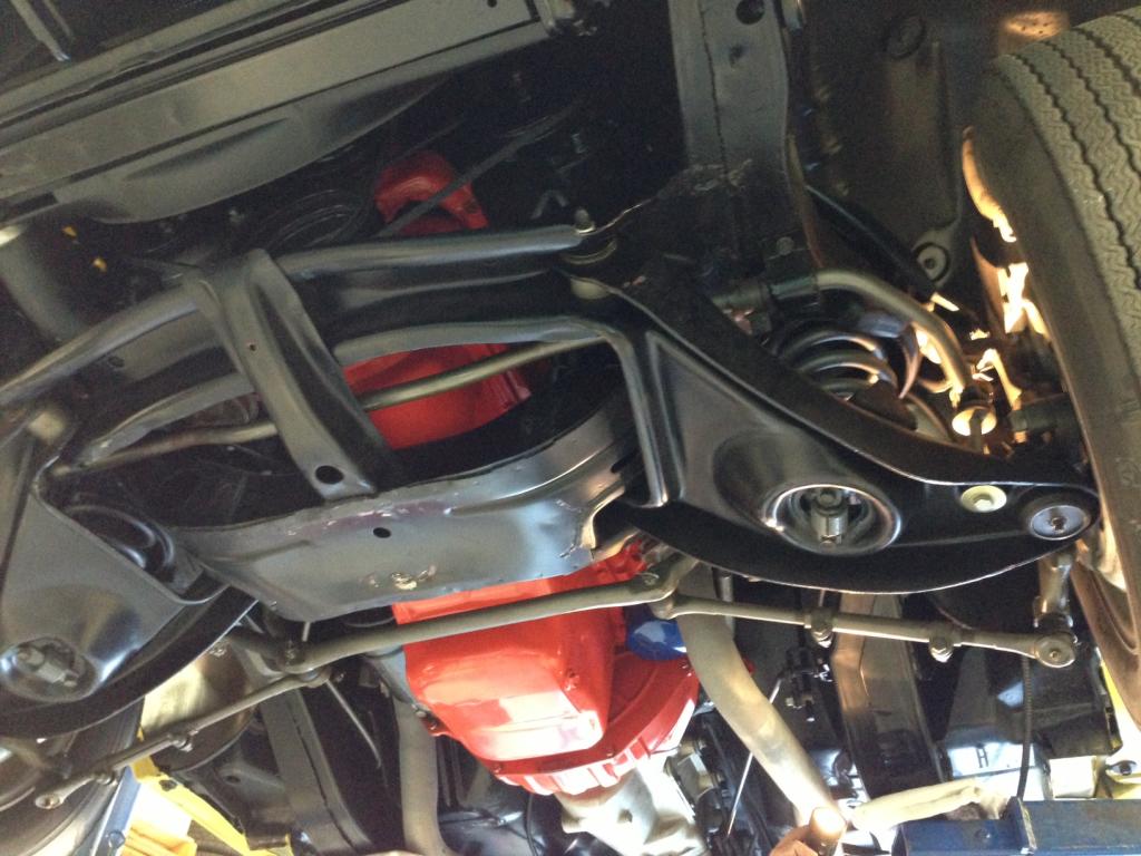

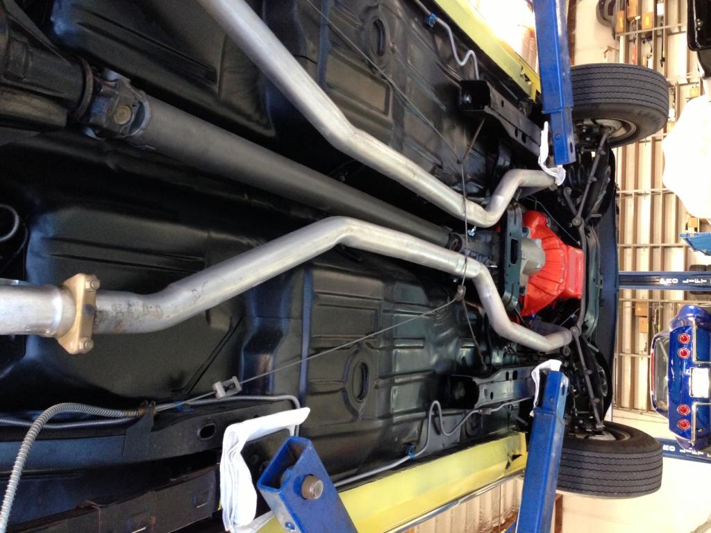

  #15
Old 12-09-2013, 08:59 PM
cudino cudino is offline
Join Date: Feb 2011
Location: CA
Posts: 95
Thanks: 37
Thanked 94 Times in 33 Posts
Default Re: '69 Yenko Camaro, restored DY 4spd with Orig Motor
Hi All,
This morning I went ahead and drove my Yenko down to Campbell Auto, and they put it on their lift and checked through all the major parts. Overall I'm happy to say it was very positive. They checked the Casting numbers and most dates on the major components, and except for the date of the Alternator being too late everything else was both PN and datecode correct. While on their lift I was also able to get a pic of the block VIN and some suspension shots. The trans is a proper M21 for the car, but as I said before is not original to this car. They also have some Wide Tread tires that I'm thinking about swapping onto the car as well. Overall my morning went very well. Here's a few pics.
Thanks,
- Wade
