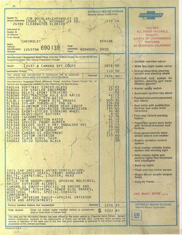

the mecum discription says it also has the window sticker????

Default Re: 1969 Camaro L89 with JL8 option at Kissimmee
Amazing, all the trouble they went through to fake this car, &quot;original (deceased) owner&quot; window sticker, trim tag and they FORGOT to put the D80 on the tag. I am guessing the spoiler option is shown on the build sheet. I haven't seen a copy of the build sheet. Spoilers are shown on the aged window sticker as well as the order:
HEY: dblclutchkid, are you as impressed with the trim tag as you are that &quot;original&quot; dealer paperwork.
