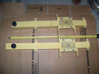

<div class="ubbcode-block"><div class="ubbcode-header">Originally Posted By: BillD</div><div class="ubbcode-body"><div class="ubbcode-block"><div class="ubbcode-header">Originally Posted By: pxtx</div><div class="ubbcode-body">Do you think you are mistaken about the unequal length? Seems like you have 2 matching bars, just different colors.</div></div> I bought the bars at different times. The yellow ones I had for a long time. The black ones I bought at a different time a few years ago. I brought up the question as the photo from &quot;chevyandpontiac&quot; seems to show unequal length square tube bars</div></div>
Paul, here is a photo of the bars showing the length. [img:center][/img]

Bill, think someone cut the front off one of those bars? The snubber position seems to show one hole or two holes available for the one bar.

<div class="ubbcode-block"><div class="ubbcode-header">Originally Posted By: [email protected]</div><div class="ubbcode-body">Bill, think someone cut the front off one of those bars? The snubber position seems to show one hole or two holes available for the one bar.</div></div>
Sam the second hole on the longer yellow bar was added. I can tell that because the second hole is not on the reinforcement plate inside the bar where the snubber screws in. The second hole was added to the longer bar so that the snubber would contact the springs in the same spot for both bars. What got me going on this subject again was the picture above from &quot;ChevyandPontiac&quot; also shows unequal length bars.

&quot;chevyandPonitiac&quot; and &quot;BillD&quot; show or have the odd bars.

Paul, here is a photo of the bars showing the length. [img:center][/img] </div></div>***24&amp;1/2&quot;from center of snubber to rear&quot;U&quot;bolt hole,I get. Odd about the Bars.
