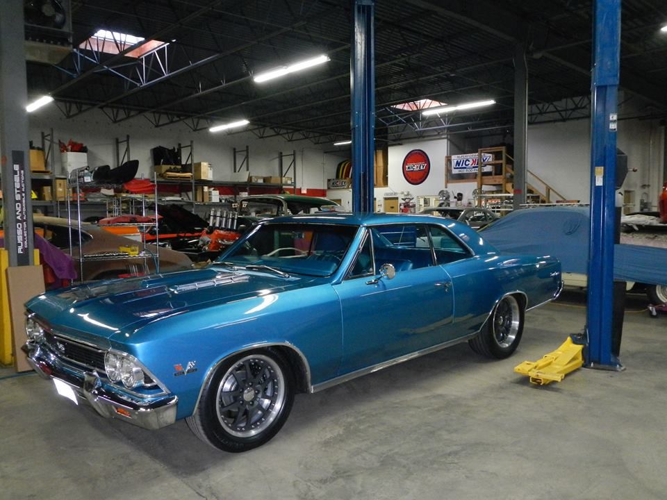

<div class="ubbcode-block"><div class="ubbcode-header">Originally Posted By: kwhizz</div><div class="ubbcode-body">Waiting it's turn on the Chassis Dyno at Nickey Chicago......
</div></div>
Gonna have to start calling you &quot;Mr. Stance.&quot;

Stefano and Cory at Nickey have been very busy and since I'm not really in any hurry to get the car back,.....they didn't get to it until late in the week.........Cory had to install another Bung in the exhaust system for one of the sensors that is needed for the Dyno Computer.......it would have normally gone in one of the rear O-2 sensors Bungs........Then it finally got on the Chassis Dyno but since it was late on Friday.......Cory didn't get a chance to really dial it in yet.........should be a video early next week...........

Cory had a nagging issue to deal with in this pieced together system.....When he would start to get into some boost, the Computer would pull Timing out of the engine and kill the Power......Took a while to figure out that it was the Torque Management system that was killing the power........It took a while to figure out how to get in the proper area of the ECM and turn that particular table off..........Got a call from him just before he was leaving for the day and he finally got to make a pull without losing Timing.........Tomorrow seems to be the day everything gets blended together to work as a balanced system.............
