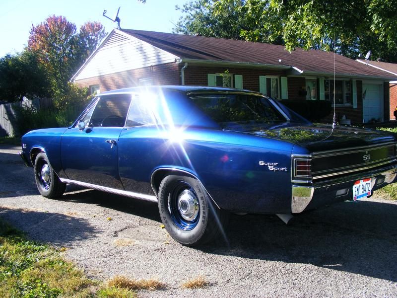

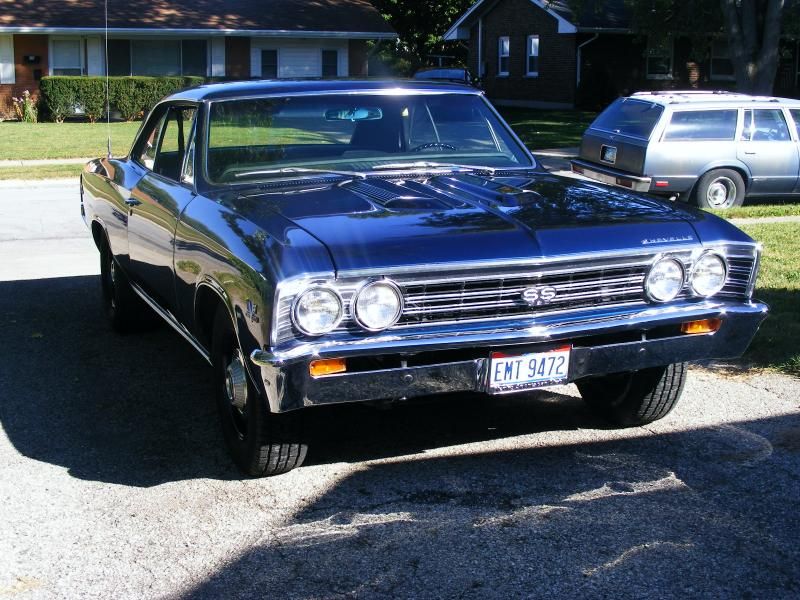

Just a few quickie shots from yesterday, sorry the quality isn't better.
