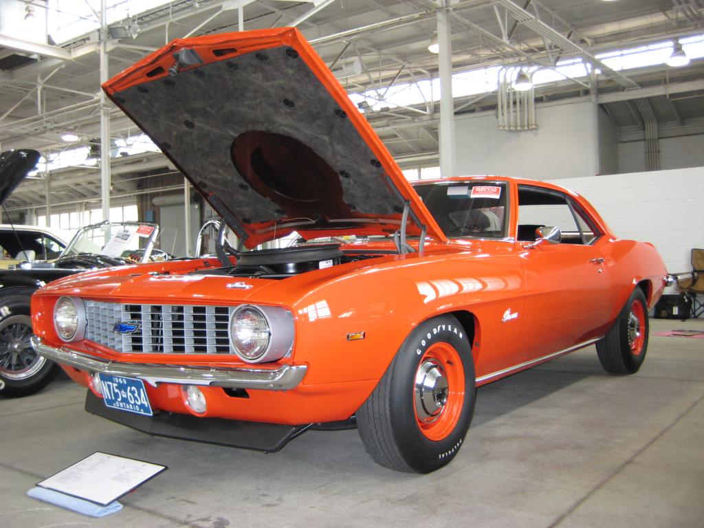

#104. This COPO Camaro was sold new at Central Chevrolet - Oldsmobile in London Ontario. It is VIN #N648156 and order #NOR297484. It has a TH400 with the shift lever on the column. It was advertised as a numbers matching car.

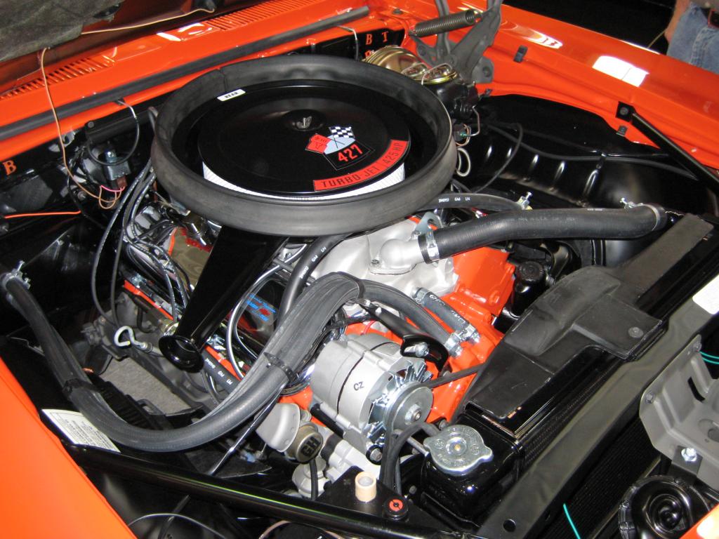

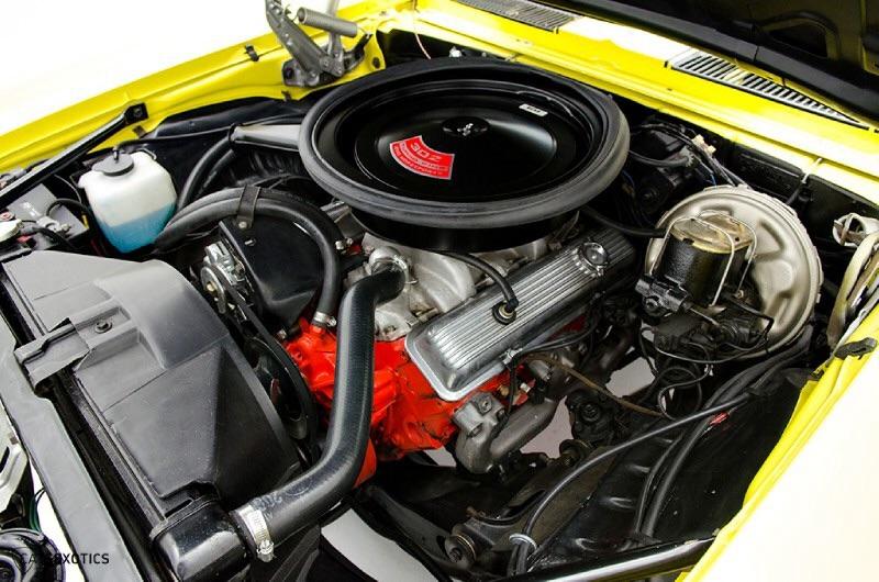

OOPS....ANOTHER UPSIDE DOWN HOOD SEAL....SMEXPERTS, ..DUH..
Im gonna keep making it aware until I see 3 in a row the right way. ritflmao
and , Yes, dynamite car ! [img]<<GRAEMLIN_URL>>/Can-I-Have-It.gif[/img]

The last two shown are not upside down hood seals. They just don't lay out like normal. When you see the upside down ones they are really obvious.

<div class="ubbcode-block"><div class="ubbcode-header">Originally Posted By: Day2_69Z</div><div class="ubbcode-body">OOPS....ANOTHER UPSIDE DOWN HOOD SEAL....SMEXPERTS, ..DUH..
Im gonna keep making it aware until I see 3 in a row the right way. ritflmao </div></div>
They have to be turned inside out,before they can be installed upside down too,like on the fathom green car.
I call them inside/upsides.

Here is a example of upside down inside out with the lip

If I recall correctly GM was selling an NOS version that the original vendor had assembled wrong - the ends were glued together backwards so that the inner lip was actually on the outside and vice versa. I had one of them on my Z11 years ago and could not get it to install properly in the right-side-up position. I tried cutting it at the glue seam and reglueing it the other way but it was all kinked up due to the age of the rubber. I ended up using the original seal.

The seals pictured need to be spayed outward (blue tape work well to hold it) until the seal holds the shape properly, but they are not upside down (Charley's pics are upside down). The upside down seals really bug me, enough that I wrote instructions how to fix them 5 years ago [img]<<GRAEMLIN_URL>>/smile.gif[/img] I have even help people fix them at car shows [img]<<GRAEMLIN_URL>>/laugh.gif[/img]

Taping the seal is a good idea as I have done it with good results on NOS &amp; reproduction seals.
The sharp wrinkles then can be further removed by placing it in the sun all day or two till they reform to a full circle.
Some of the above cars (reviewing the many pages) do have the seals inside out ,upside down and most just upside down as noted by Kevin in the Team Camaro thread, with unopened lips.....as recently, I reinstalled 2 seals on friends cars the same way,by opening the lip from the seal.
Still...... need to see -3- in a row correct ones to cheer on. before &quot;I go away&quot;. lol
