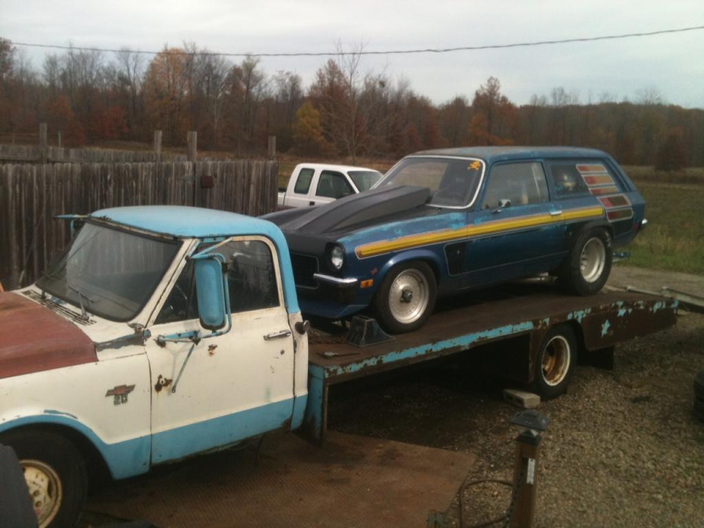

Kind of reminds me of one a friend of a friend owns. Here it is reunited on it's real deal ramp truck.....this was taken last fall. Car was painted by the Nolan Bros...
BIG

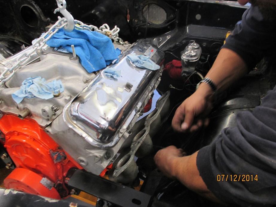

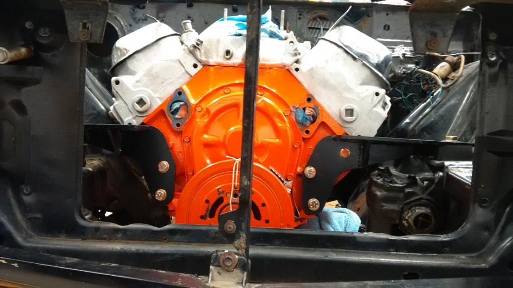

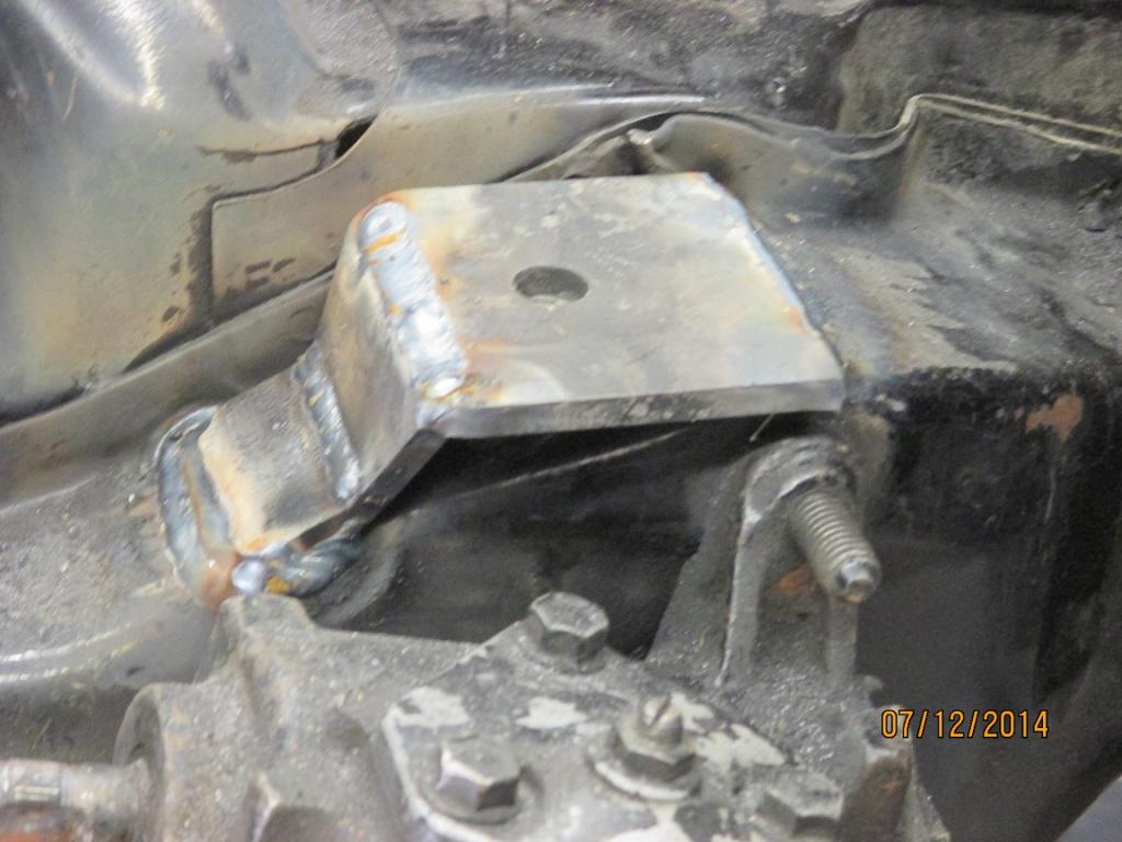

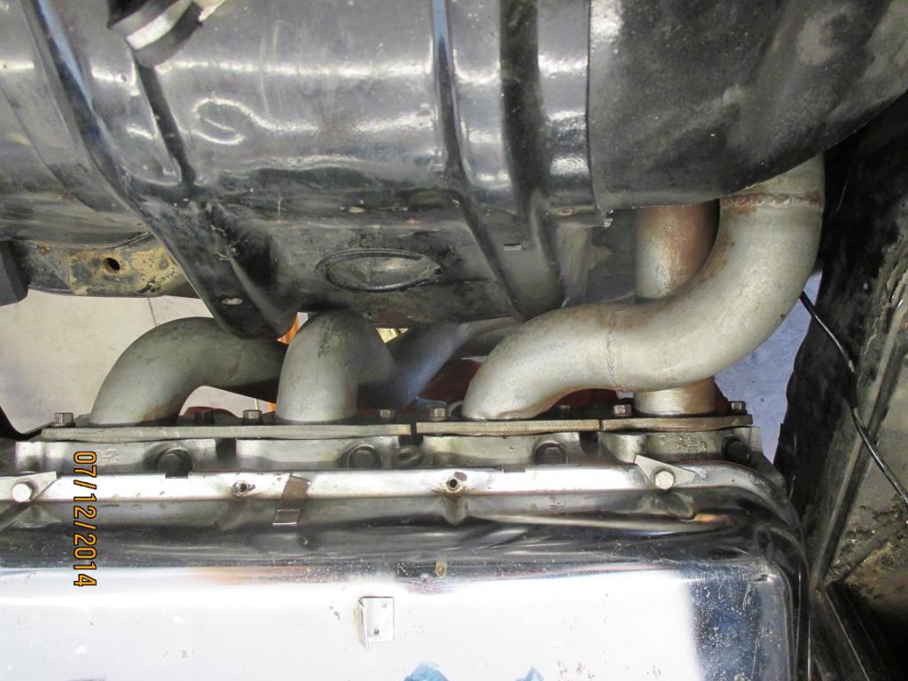

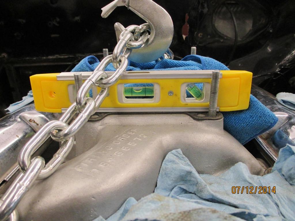

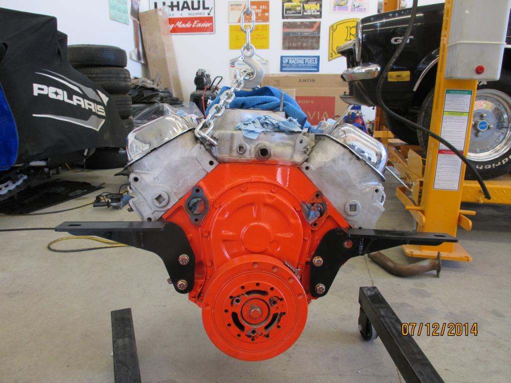

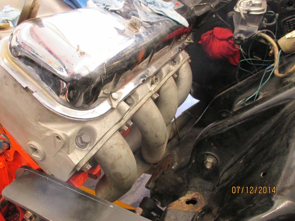

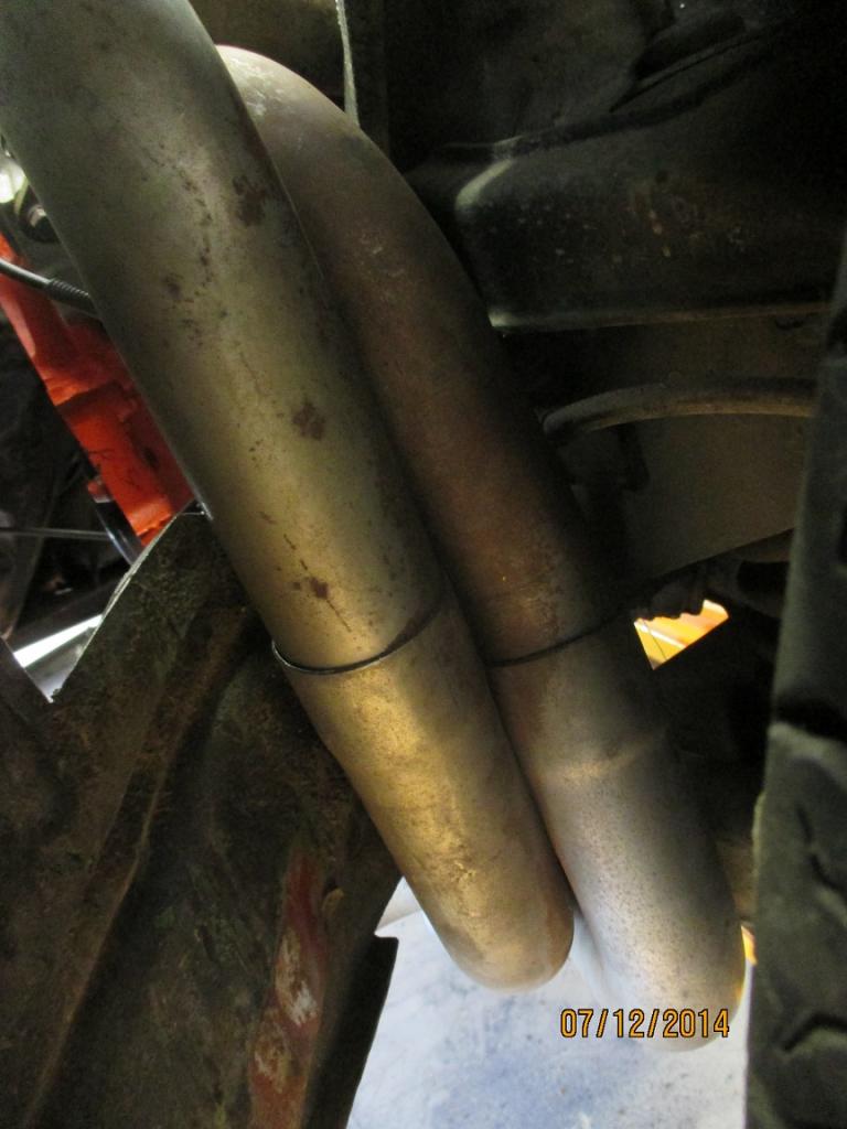

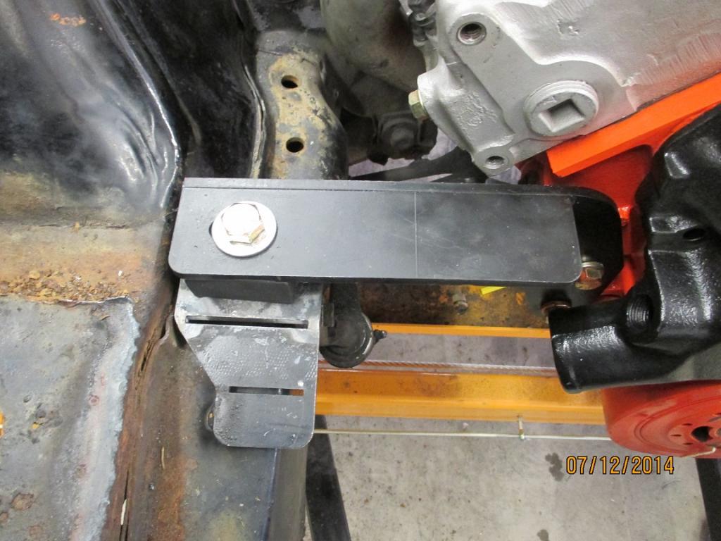

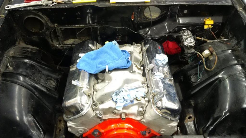

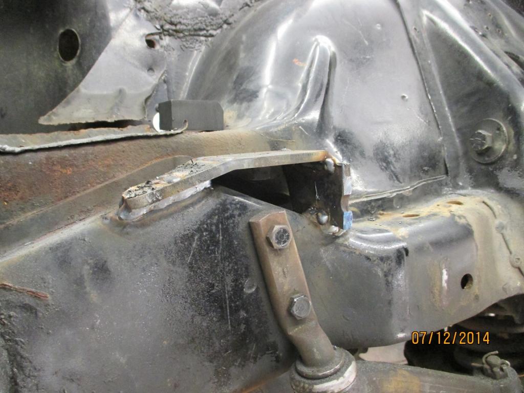

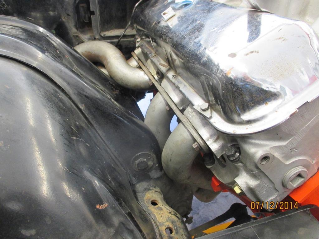

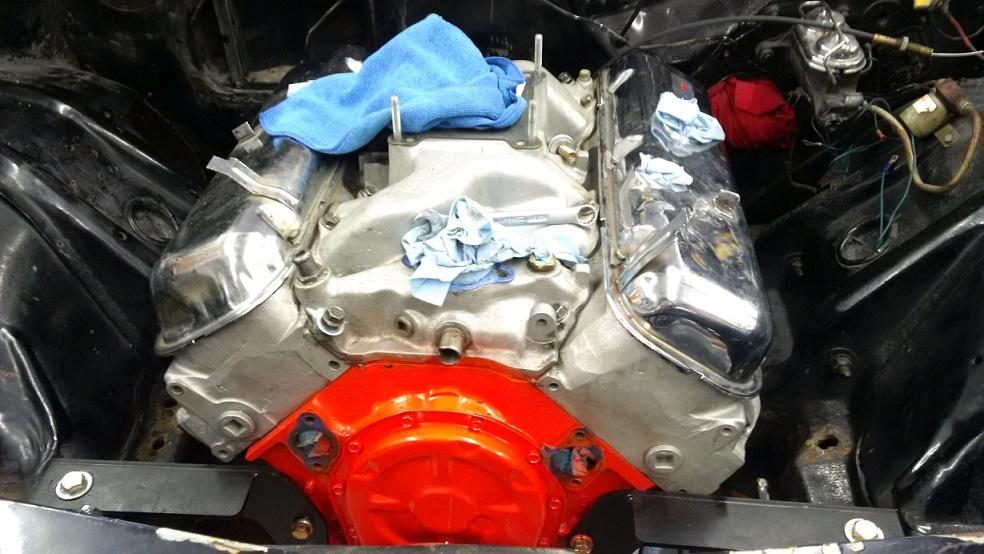

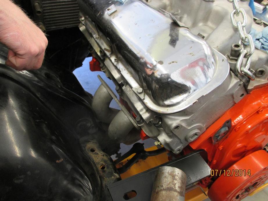

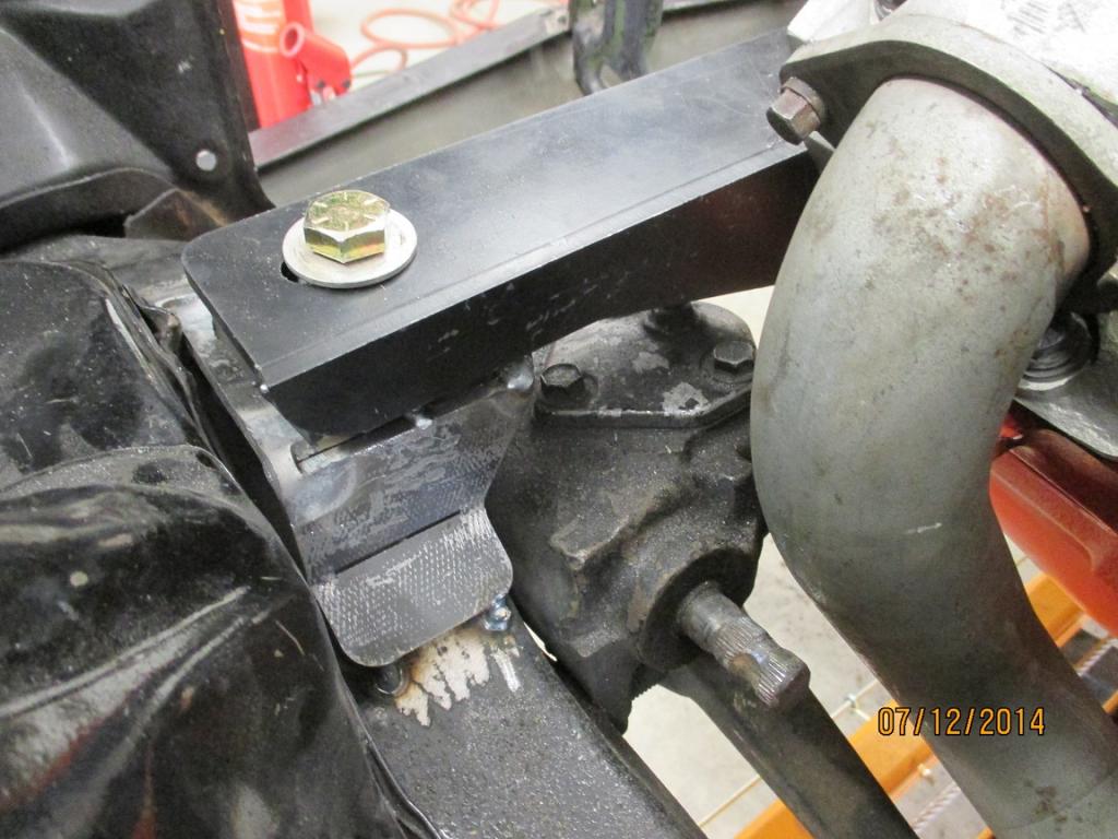

Got the motor mounts, plates and header's courtesy of Hemicolt. A special tanks to Tracy for taking the time to help a fellow enthusiast and send them up to Canada for me.
Got a few friends over yesterday along with my younger bro. He's the brute force and welder guru and off we went.......
Had the motor in and out about 6 times, some grinding, pounding, some swearing, you know, the usual. Things are tight!! We found it easier to put the motor in, then slide the passenger header in from below, then slide in the drivers side in from up top. Once we had things squared up the best we could, and string lined the driveline. Then we welded in the motor mount plates into place. The motor does sit slightly to the passenger side as it should. All in all things went pretty good. It sure helps to have 3 people for the install.
Still have lots more to get done, but this was probably the worst part to tackle. The motor is back on the shop floor, as I have to modify a few more thing, such as the starter to fit, and just some small stuff. Nothing a little bit of heat and a hammer won't take care of.
Here are a few pictures from yesterday, as I progress I will post up some more. Enjoy

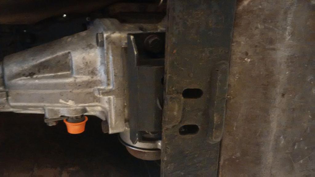

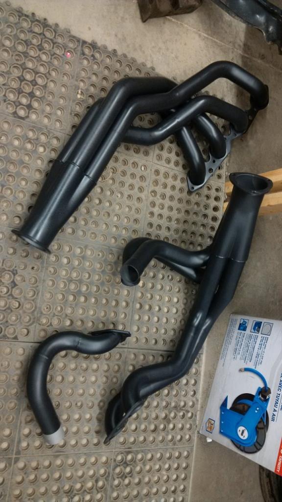

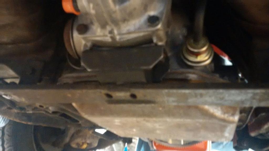

I'm back with a small update. Go the motor and tranny together and stuffed them in last night. Being as the car use to have a SB in it at one time, I was curious to see how far the cross member would be out with the BB in it. It about an inch longer, and not quite an inch to the one side. So I will fab up a cross member to allow for the extra length now, as well as the for the exhaust. I sent the headers out to be ceramic coated also, had them back in 4 days. They look pretty good. That will be the next mission now is to install the headers next weekend, and the drive shaft. My hope is the drive shaft won't have to be modified (shortened). I will find out soon enough I guess. I'm hoping the tunnel ram will be in by then to, then I can install it, as well as some ignition parts. Wiper motor needs to be installed also. The heater vent, I think I will fab up a piece of tin and cover it over, and just install the blower motor to push some air through the car on the colder evenings if I'm out cruising.
That's it for now, enjoy!!

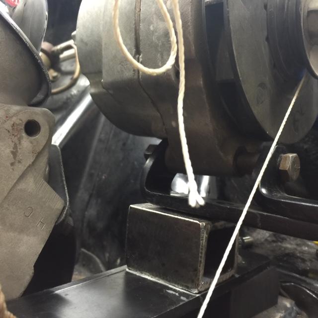

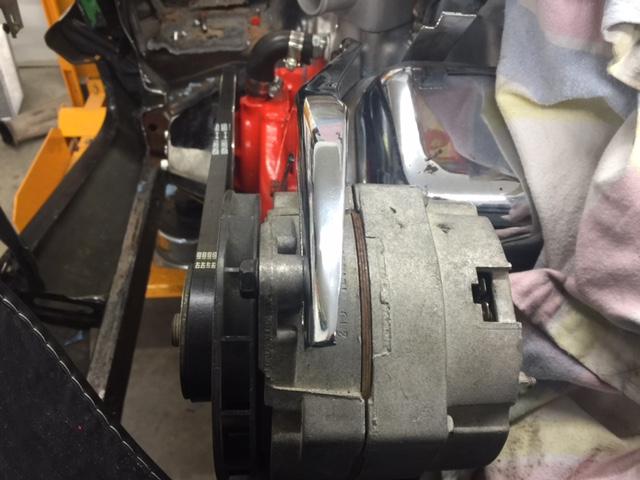

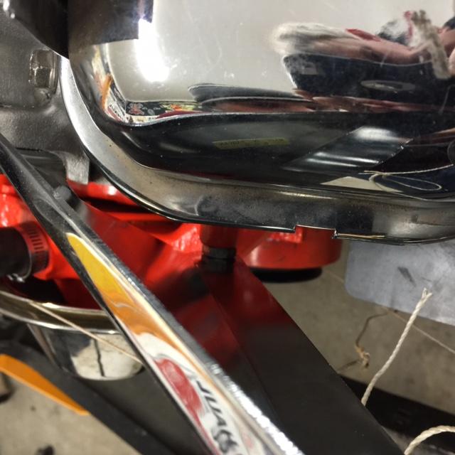

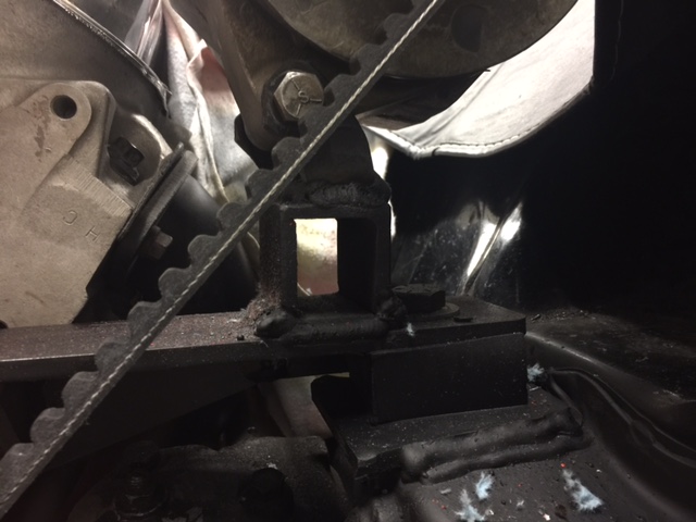

Now that the holiday season has come and went and I still have some time off work, I have progress the panel a bit more. The Wieand Tunnel ram wasn't drilled out for the top alt bracket, so I had a buddy come over and preform that. That way if it screwed up, I had some to complain at. Had no issues.

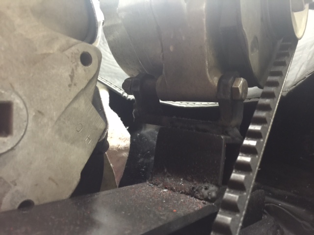

#1 Shows the 1/2 inch shim we put behind the 68 alternator bracket against the water pump.
#2 Shows the bracket we built to build up the mount for the bottom of the alternator.
#3 Is the same thing as pic #2, just a better pic. The bracket attached to the bottom of the Alt, I turned it around, welded it up and cut it to proper size.

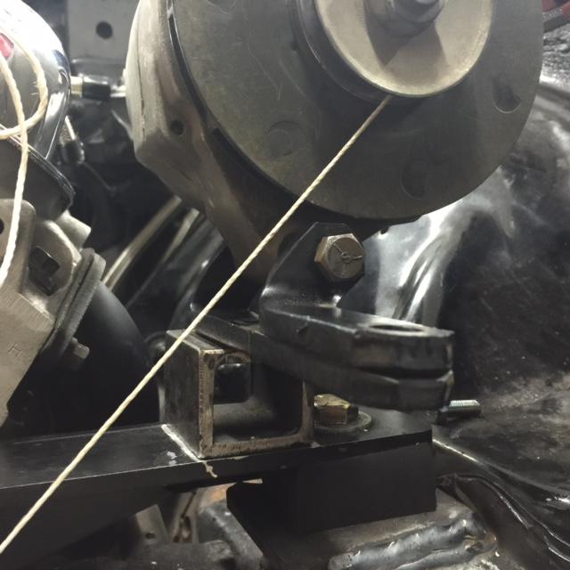

#4 Shows the string line and how everything lines up pretty good for the future placement of the alt belt.
The reason I am documenting this Alternator fabing and fitting for a 427 Vega is I have looked high and low on the net for some picture building guidance and have found nothing. My hope is someone will be able to benefit for these pictures.

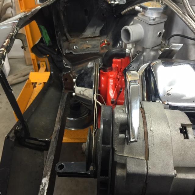

Pic #1 shows the alignment of the alternator and the rest of the pulleys with the belt in place. Looks pretty good!!
Pic #2 Shows the bottom alt bracket welded into place. No laughing as my welding skill need a bit more practice.
Pic #3 Same as the last picture, just a better angle.
That pretty much looks after the Alt install now. Again, I hope this will be of some help to someone in the future for the install of the Alternator.
