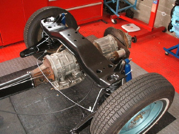

Guys I hate to interject in a very old COPO thread but as the 63 SD Tempest were mentioned I can give some info on the transaxle.The unit used a 2 speed Tempest TQ trans with a 2 speed planetary (spelling) bolted to it giving it a 4 speed manual Auto trans.No TQ converter.The car had a clutch with the unit mounted in the rear with a hyd bearing.They launced to car with the clutch and just shifted each gear with a console mounted shifter.Tom
