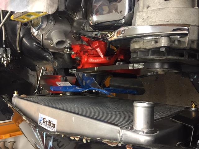

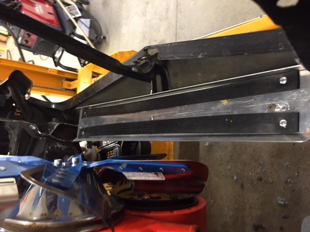

Pic #1 I had this little tray built for the bottom of the rad, placed in some rubber and used some Gorilla glue and a couple rivets so the bottom of the rad had some cushion under it. The used a couple of flat tex screws and mounted it.
Pic #2 Got the rad in place and side mounts in place that I built. Rad seems pretty solid how I have mounted it.
Pic #3 Pic just shows how much room I have in between the fan and rad.
My concerns now are the upper rad will have to be modified a bit and put a curve neck in place. Went hunting in town and have a couple hoses to try and see how things fit. If all else fails, the rad will come back out and get modified. I might have the same issue with the lower hose. Might get out to the garage today and size things up.

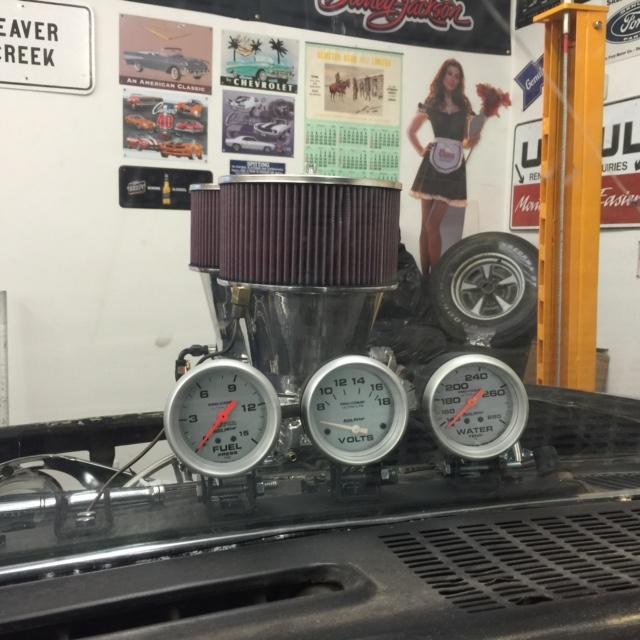

When the car was in limbo a few years back, the gauges were stolen off the cowl. When the bandits did this, they bent everything up. So what I did was had a small aluminum plate made and painted it flat black. I cut a few small pieces of rubber and placed them on the bottom side of the bracket and mounted it on the cowl to hide the mess. I still have one more gauge to mount, but need to work on getting power to the back of it as the wire pulled out. But it's spot is ready when I get it fixed up.
I think it looks pretty good where it was mounted, and easy to see.
Got the oil dipstick in placed now, the oil sending units all hooked up on the bottom side. Temperature sending units hooked up.

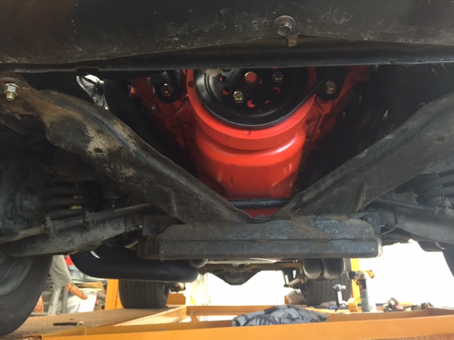

#1 I had to modify the K-frame and finally got it fit into place now. Them pesky headers where in the way as usual!!

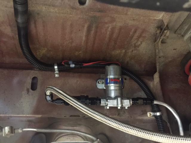

#2 Fuel pumps all hooked up and wired up now.

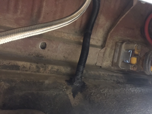

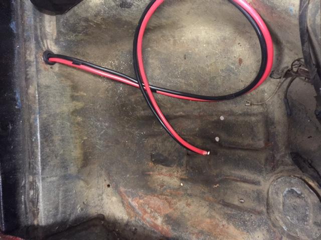

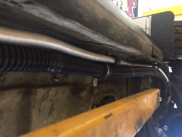

#3 I'm going to run the battery out of the back of the car, so I bought a battery box and some battery cables and got everything run to where the spare tire once sat. So drilled a hole and put a grommet in place and ran the cable and sheath and then silicone it into place.

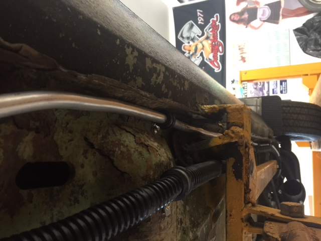

#4 The fuel line and battery cable running to the front of the car.
#5 Same as last picture.

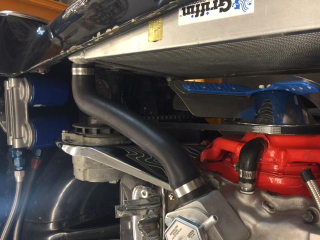

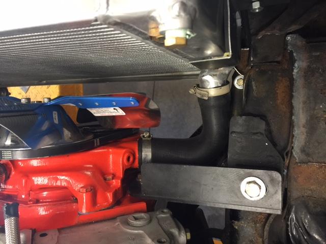

#6 I had to get the radiator slightly modified at a local rad shop, and now have it in and hooked up. The hose's were a bit of a challenge as I went to a local automotive store and started picking and choosing hoses then brought them home until I found something that was suitable and cut it down to fit into place. I think I bought a total of 7 hoses before I found the right ones to fit the bill.
#7 Top rad hose, same as above.

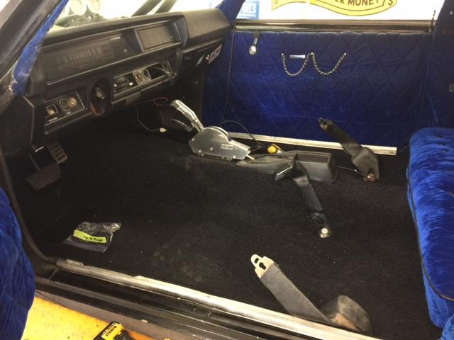

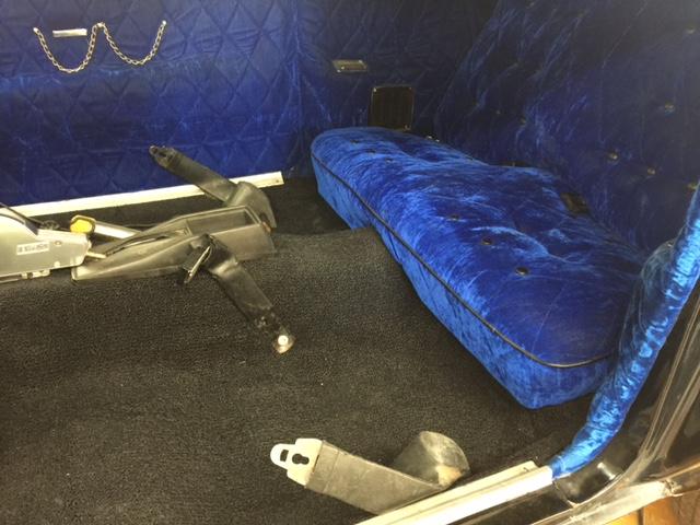

#9 With the help of my buddy, we got the dash all hooked up and back into place. Then we got the carpet into place and cut it as needed. Got the sill plates back in, and got the shifter and mini-console back in. This things starting to actually look like a car inside again!! The seat belt..... The last owner just cut the old seat belt bolts out and left us nothing to work with. So we ended up drilling them out and then a re-tap of the existing holes and got the seat belts installed finally. This wasn't a fun job....
#10 More interior..

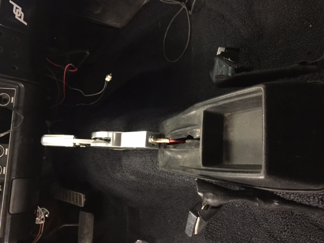

#11 The mini-console, it worked out that we ran the shifter cable up threw the old e-brake hole and it worked out perfect. What are the chances of that happening....

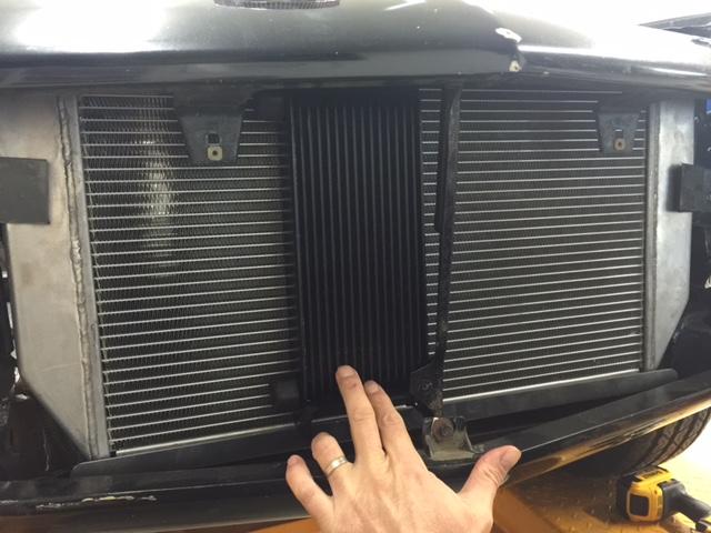

#11 Tranny cooler, we ended up adding some tabs to the existing support you see and mounted it. The grill actually fit back into place when we were done.
