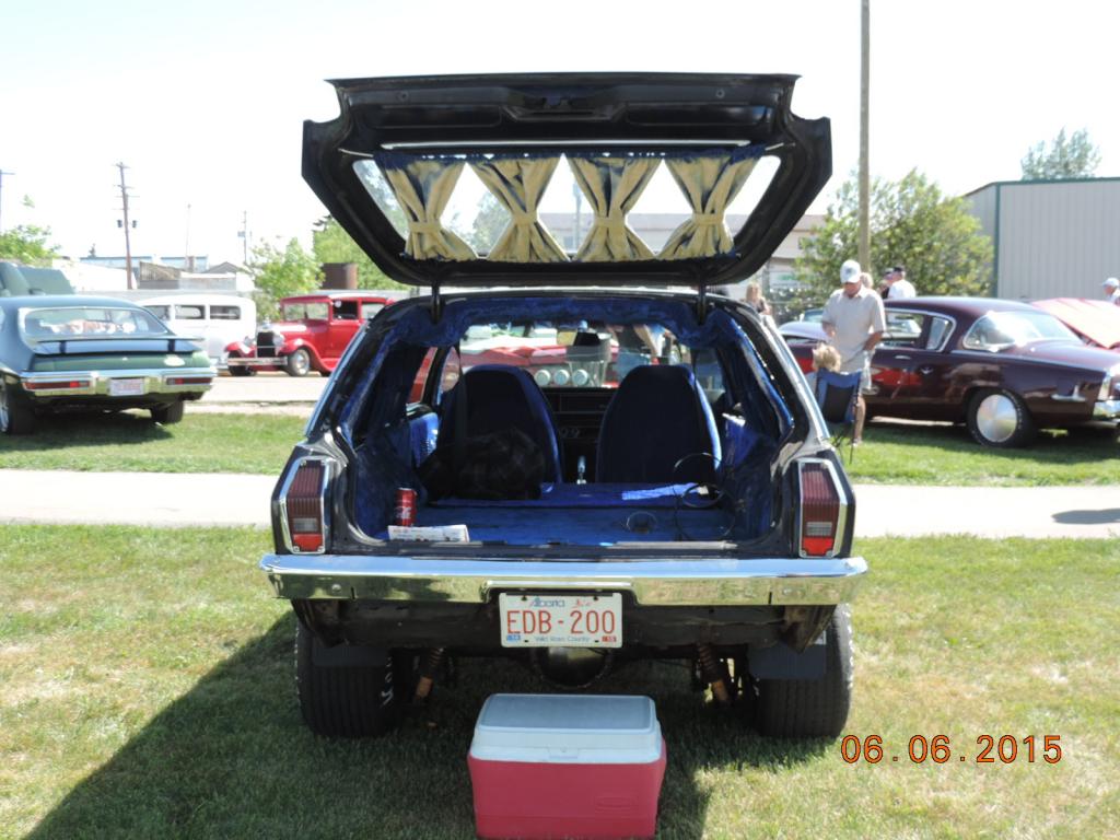

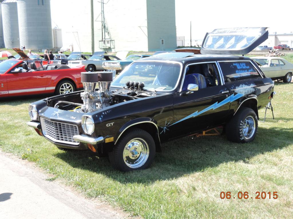

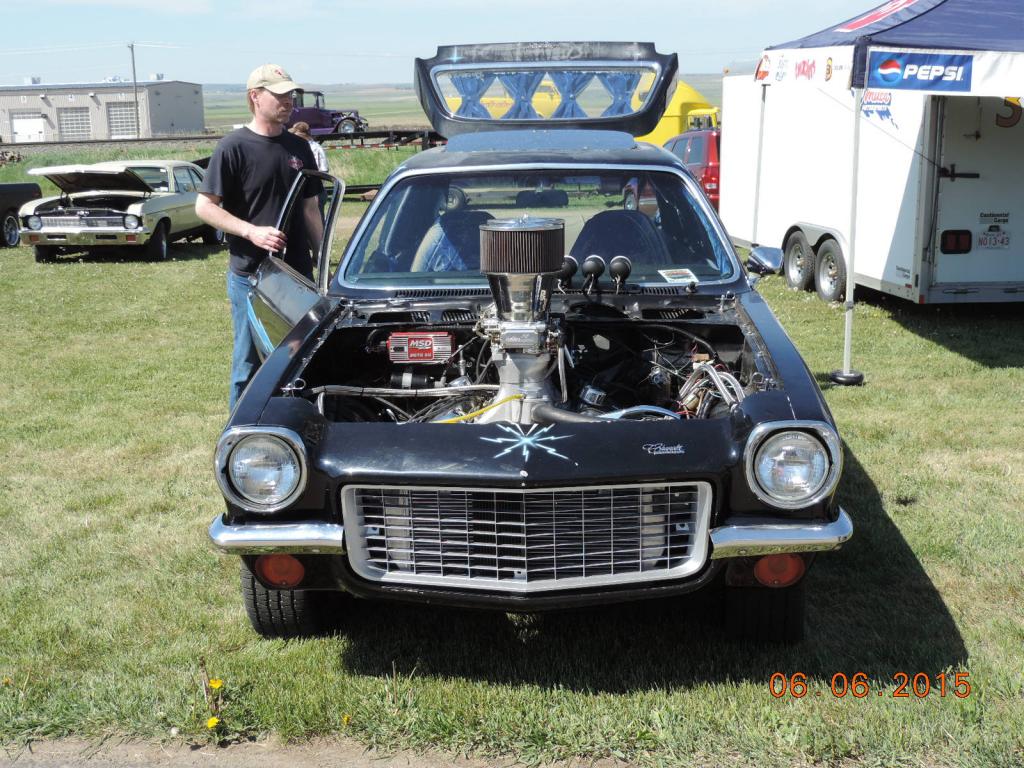

A couple picture from The Three Hill Show and Shine of the vega. Still working on getting some better video of it. I have already broken an axle in it. So I now have some Moser axles that will be installed today. Then I guess we'll see what the next weak link is when I get into the throttle.

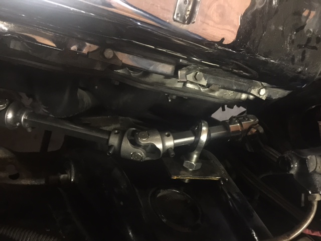

A couple pic's,
The first being a pic of the exhaust and electric cut outs. Everything tucked up and away pretty well. This is the old exhaust off the Nova.
#2: The steering nightmare completed. Found some good pictures online and that was the blueprint that was used. Install a drive shaft loop, just in case..... The ladder bars were also changed up from the one that were on the car versus the ones that came with the car. The newer ones are better.

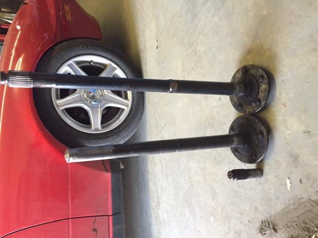

#3: When the car was built in the very early 80's, they took a Impala style 12 bolt and cut down the housing and axles and welded them back up. I guess the car broke lots of axles in the past. Of course I found out the hard way trying to do a brake stand!! oops. So well the axles were out in this picture, we measured them up and ordered some Moser. They are being installed, and I should have the car back tomorrow with any luck.
