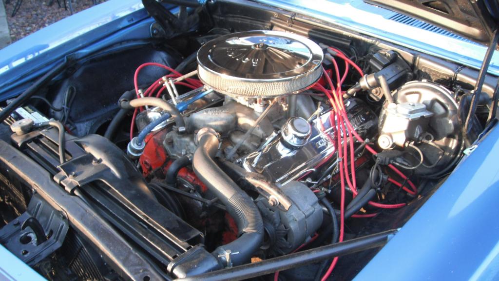

By the way, what's the best way to clean it without pulling it off the car? The grime and cruddyness ruins it.

I spray carb cleaner. Maybe try Simple Green or Purple Power first and see if that will work. Just be sure to wash it off thoroughly and cover up the carburetor and anything electrical.
