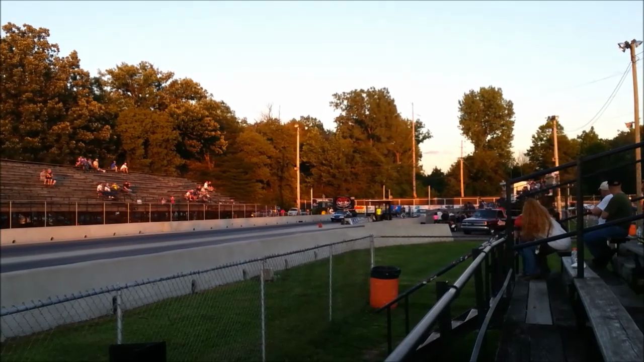

First pass--I wasn't expecting it to hook, took me a bit by surprise:

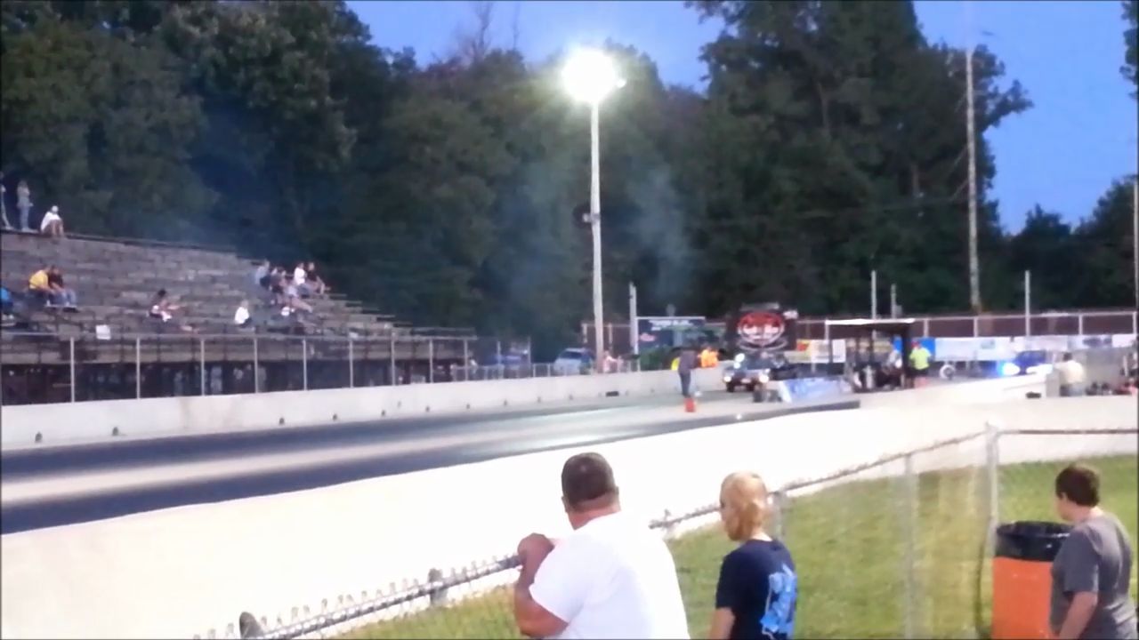

Compare to 2nd pass where you can clearly see it blew the tires off the line. Also note the track guy mopping fluid from my lane from the car before me:

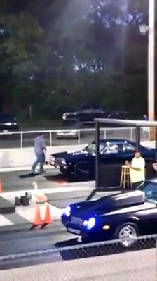

Alternate view of 1st pass:
Alternate view of 2nd pass--note the car nose over about mid-track...this is when my hand slipped off the shifter causing me to miss 3rd gear. I stuffed it back in gear and drove it the rest of the way down:

  #558
