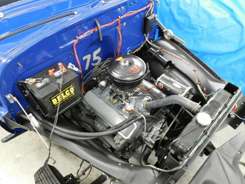

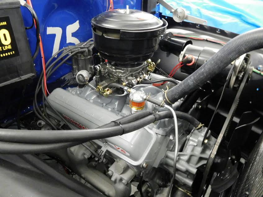

Default Re: 1949 Chevrolet 3100 - V8 Prototype

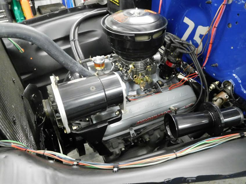

Alrighty, so a few set back and a few advancements. Wiring complete: Key on and a crank for starting {pop} {CLUNK}. Hmmmmmmmmm...mmmhmmm. [img]<<GRAEMLIN_URL>>/confused.gif[/img] [img]<<GRAEMLIN_URL>>/hmmm.gif[/img] This just all worked last week, I touched nothing, then come back a few days later and I'm greeted to a bowl of Rice Krispies (snap, crackle and pop). Oh, let me try this (wiggle, wiggle, tighten, loosen)...{pop} {CLUNK}. Hmmmmmmmm.....Well, that wasn't it. Oh, silly me, it was this thing right here. Let me get in here..and...(wiggle, loosen, tighten, kick)....{click, click} {POP} [CLUNK}. [img]<<GRAEMLIN_URL>>/hmmm.gif[/img] Well, that's all I know how to do, time to go home. So as tribute to Patton, I regrouped, pulled out what little knowledge I keep in my electrical encyclopedia, and then had another go at it. The result? SUCCESS!!! {VRRROOOMM!!!!!) As simple as it sounds, it was the addition of two more chassis/frame/engine ground wires that caused all the issues. I blame this squarely on M22Mike. Why I don't know, but I'm of the generation that it's never my fault and I have to blame someone, so it's on him! [img]<<GRAEMLIN_URL>>/grin.gif[/img] But then Lake Superior started to form on the intake manifold at the front two water jackets. So with that, A new direction for the engine: Power Pack time! I ordered an Edelbrock and matching Performer intake to remedy this leak. I pulled the intake and found two hairline cracks on both the front water jacket ports. Not sure how they got there, but no matter. After detailing up the new parts, the engine was back together and running good with no leaks! I made it look like an older Carter carb and now that's it's a 4bbl, it'll be a Power Pack optioned truck! Since I have a 700R4 in there, this provides a nice place to mount the TV cable as well. Something I was still pondering with the older intake. The heater hoses will be fastened with a few backets (the zip ties are just temporary right now). I think it all still ties in nicely. I removed the electric choke and will add the manual choke lever that routes to the dash, and then wrap the harness up. Time for some bodywork...

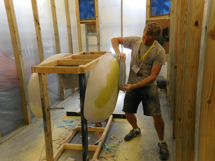

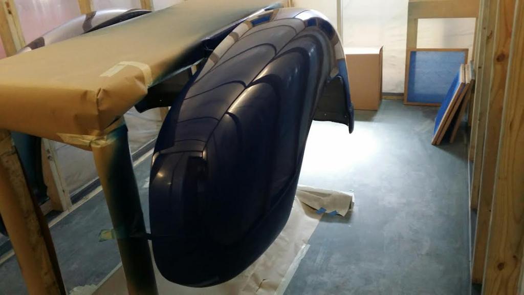

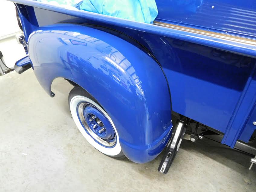

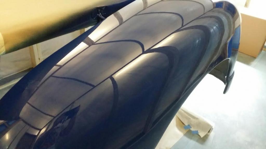

Oh, and before I forget, that large &quot;75&quot; was on the firewall when I got the truck and was actually etched into the paint. I have seen various numbers on the firewall from AD trucks built from the Janesville Plant. What they mean, I'm not sure, but I added the number back so before and after photos still have the number there! Alrighty, from a previous thread, someone commented about Yenko.Net ID tags for this year's upcoming MCACN show. In keeping with being Green and helping out the Planet Earth and all, I never took mine off from last year. Matter of fact, I still have my MCACN lanyards and tickets too! I think I can make that 2014 look like a 2015 with some creative Crayola'ing!!! [img]<<GRAEMLIN_URL>>/grin.gif[/img] Nobody will notice. Especially when I create a distraction and run into the crowd kicking and screamin, &quot;I'M IN!!! I'M IN!!!&quot; Ahem...where was I? Oh yeah! Fenders! Having more waves than the Atlantic Ocean, I picked up the sanding blocks and went to town. The result? And ocean calmed down to a pond (with a large stone thrown in it! [img]<<GRAEMLIN_URL>>/grin.gif[/img] [img]<<GRAEMLIN_URL>>/crazy.gif[/img] [img]<<GRAEMLIN_URL>>/whistle.gif[/img]
Time to thrown them onto the truck and make sure I scratch it along the way [img]<<GRAEMLIN_URL>>/no.gif[/img]

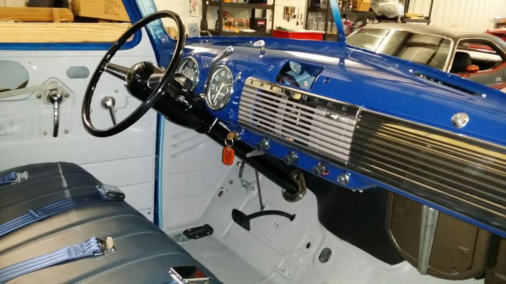

Taking a break from the bodywork, I moved back to the interior and painted the column and installed the seat belts. The parking brake handle just came in so I'll be mounting that up under the dash this week. Stay tuned...more to come with such memorable moments as, &quot;Did I add transmission fluid yet? Awe heck, I'll take it for a spin anyway...&quot; And...&quot;What's that noise????&quot; [img]<<GRAEMLIN_URL>>/grin.gif[/img] [img]<<GRAEMLIN_URL>>/grin.gif[/img] [img]<<GRAEMLIN_URL>>/grin.gif[/img]

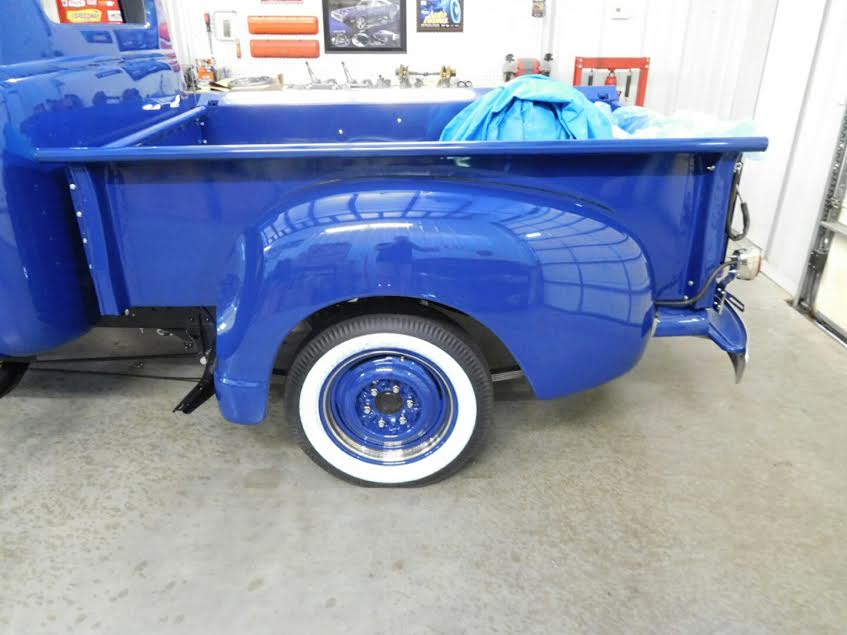

I use PPG paints, and this was single stage shot with a 1.5 tip out of my DeVilbiss. It calls for a 4:1:1, but I didn't use the reducer and it flowed nice. Shot the bed that way along with the wheels and very happy with the results. Booth is a pseudo - cross ventilation and it worked well keeping dust out and overspray hanging around was minimal. Sweat drips, on the other hand....:-(. I still need to hit this with some 1500-3000 and a light buff, but still happy with it.
