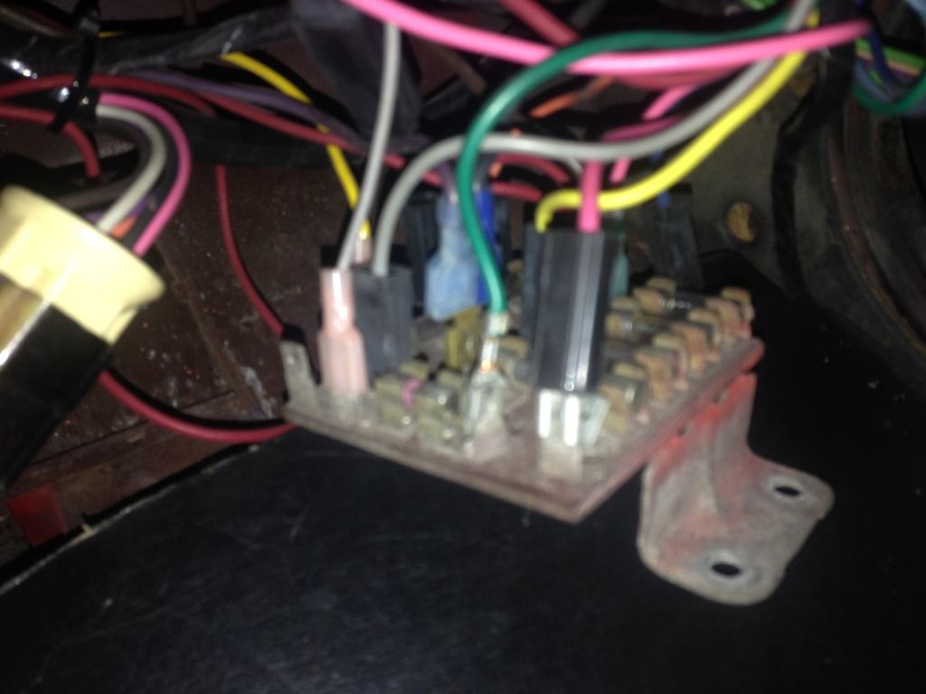

I finally got the engine home (Thanks Gary !!).........So, the first thing I did was to swap out the stock oil pan for the Holley 302-1 pan.........Gotta love the new gasketing systems........a heck of a lot better than the old cork and rubber leakers......LOL...While changing the Pan I noticed that GM left out a plug in the block that was meant for the Integral Oil pan Oil Cooler .......The engine didn't come with that cooler so I don't understand why they didn't put it in.....not a big deal, but I had to order one and it mounts behind the motor mount adaptor plate and the motor mounts....so...If I install the engine and it just happens to work out that everything fits......I would have to take back out again to put that stupid plug in.......So....I started getting the new A/C system ready for install....then in looking at the original wiring and fuse panel under the dash, I decided to basically rewire the car and get away from the Glass Fuse system.........I was amazed at how simple the original fuse panel is with limited fusing and circuits.........I will leave the rear body harness alone and rewire the rest using an American Autowire Classic update system.........Oh Well........I have to do it correctly......with the dual fan set-up for cooling and the Intercooler pump,Fuel Pump and everything else that go's with the new drivetrain.......it just makes sense.......Also....I sent the dash cluster out for stripping of the Chrome.....It's stripped, now I need to get it painted for the Dakota Digital Gauge install.......

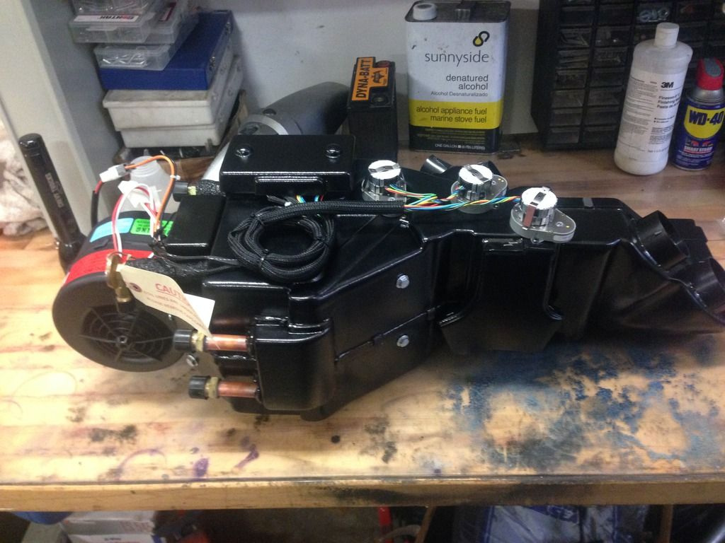

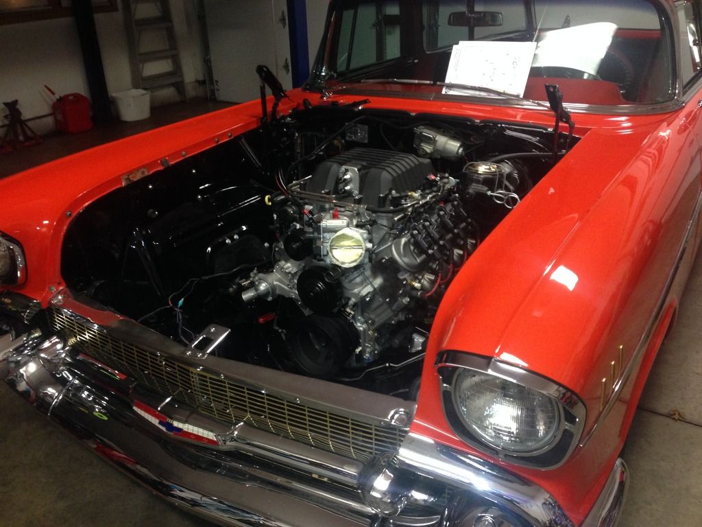

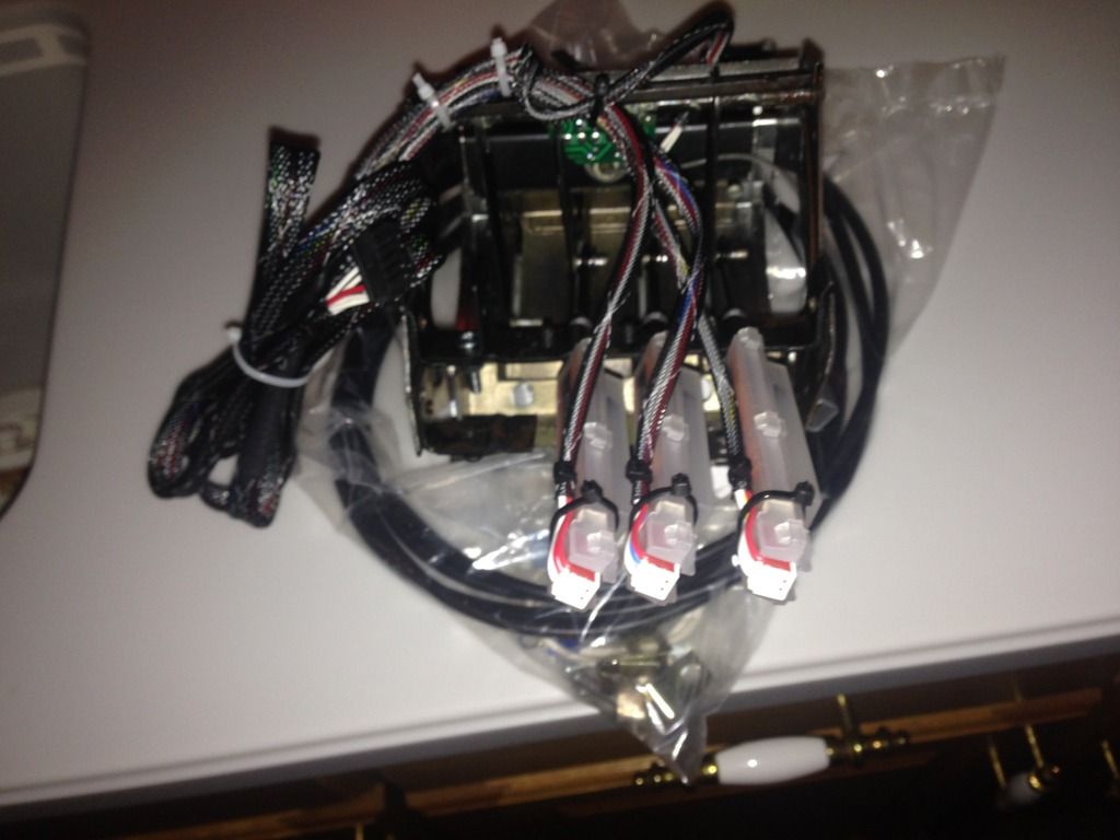

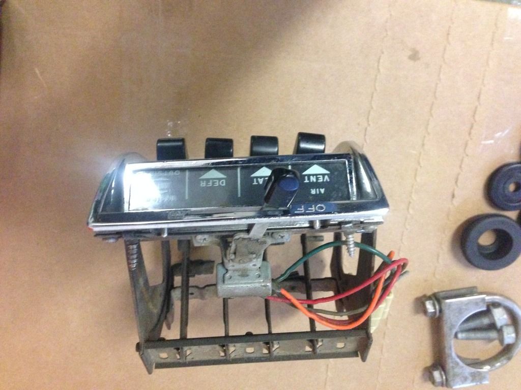

While waiting for the new wiring kit to arrive I converted the stock heater controls over to the Vintage Air electronic set-up......I could have installed the A/C unit but I figured it would have gotten in the way while rewiring....also while the engine was out.....I noticed that the frame mounts that were welded in by the original builder were not parallel to each other......and I noticed that the rubber engine mounts had taken a set to the angle being out of position........I figured that since it worked before...........LOL.......As you can see in the pictures the engine fits in the 57 perfectly with the stock Camaro exhaust manifolds .........got Lucky.....Till I went to put the motor mount bolts in...........Close but no cigar.........Gonna pull the engine back out and cut the mounts out and do it correctly..........Just can't put it together in that &quot;Bind&quot; condition.........
Stock Heater controller
with the Electronic conversion
